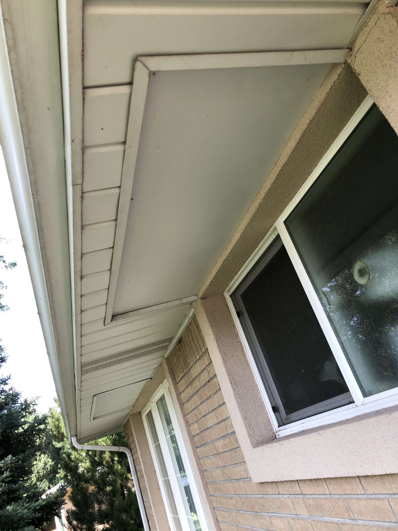

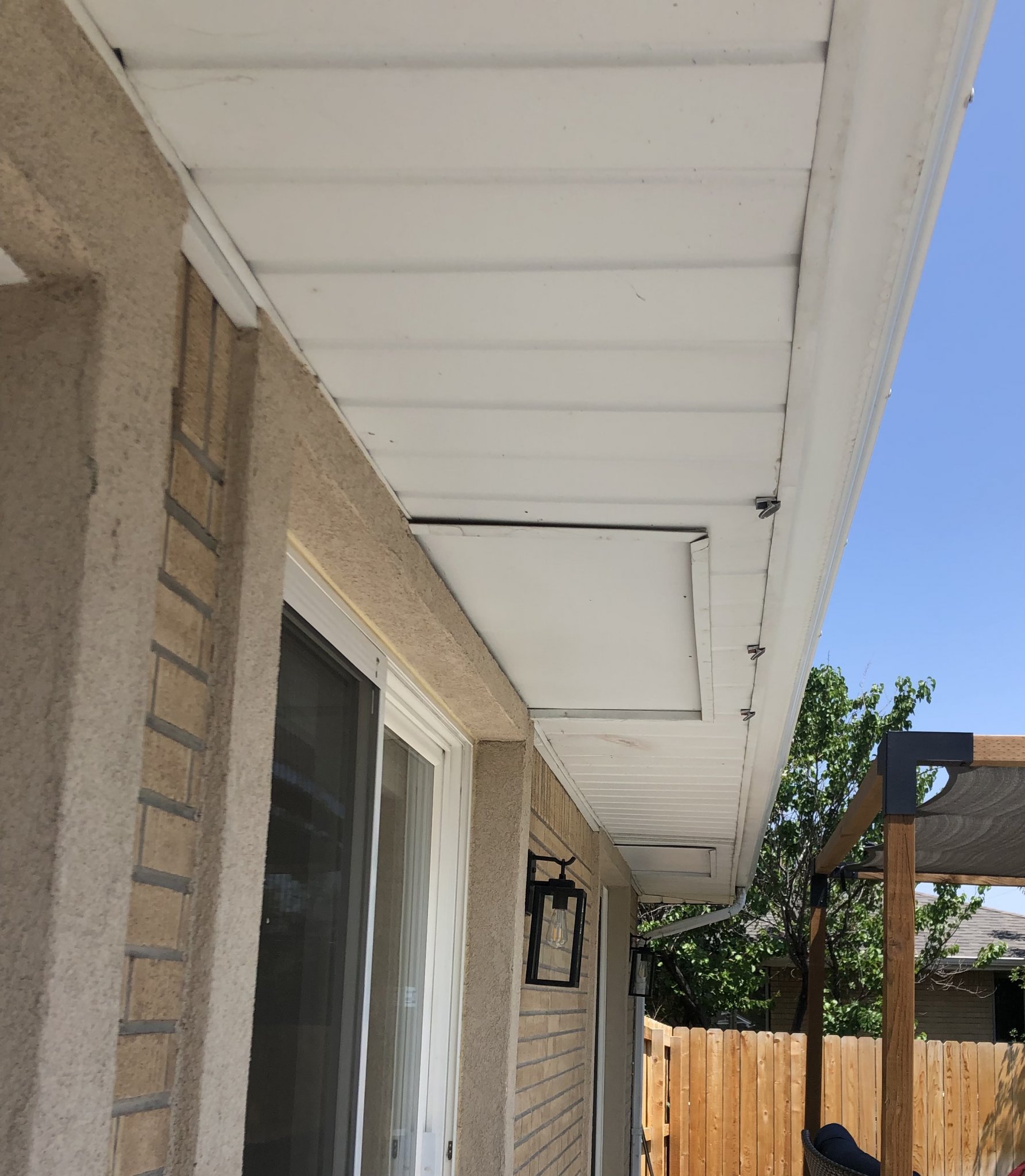

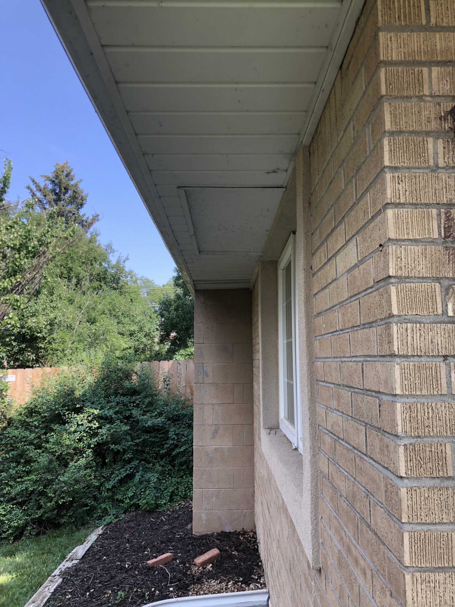

Hi Folks. This is off topic but I’m betting someone can answer this question. I’m at my Son’s home in Denver and there are what looks to be access panels in the soffit all around the house. It doesn’t make sense to me. Anyone know why these were cut in?

Are the panels just laying in place, not attached? Maybe in cold weather you leave them shut, in the heat of summer you open them to ventilate the attic? Be interesting to know if there is a screen frame up in there to replace the panel when open. Just guessing!

It’s covered in a layer of insulation but it appears that the attic goes all the way out to the end of the roof line.

How old is the home? Maybe a Roof ventilation project gone wrong. Can't tell without pic's from above. I.E, I'm old Home Inspector.
6,375
2,027
Are there any roof vents or ridge vents? Standard insulation or spray foam on roof deck?
Is there any vents in the soffit other than these (if they were open)?

The house was built in 1960. The soffit doors appear to be tacked in pretty well. Not easily removed.

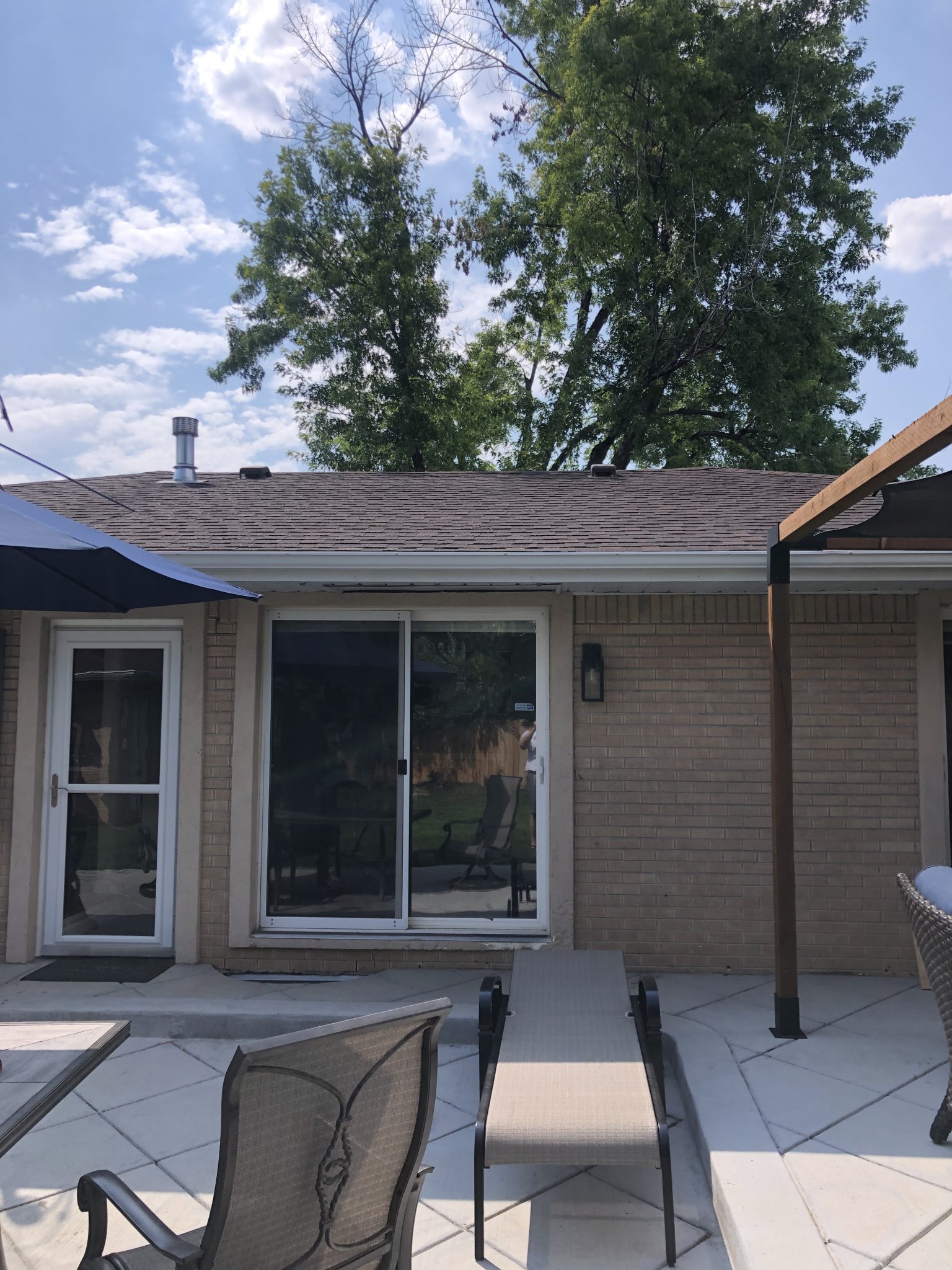

On the roof we have two 12X12” vents.
The roof insulation is a combo of batts and blown in.

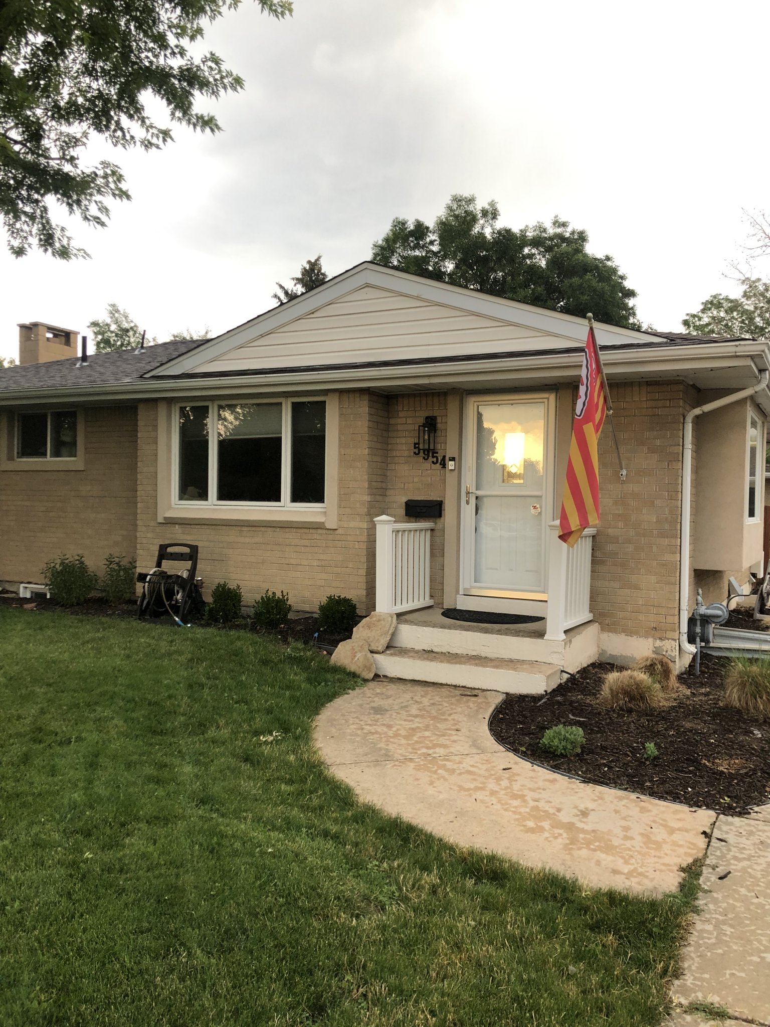

The vents may be in the gable ends of the house. If so then he needs to improve the ventilation system sometime. Post pictures of the gable ends.
Is there access to the attic inside the house? If not this may be that builder’s way to provide access?

These were installed to service the heating or cooling units in the attic, should they need to be replaced. Sure beats having to cut a hole in the roof. From the picture, there appears to be a gas chimney on the roof, unless that is some type of power vent.

Thanks that's the part of the puzzle we didn't know, it makes sense now.

The soffits have no vents. The only roof vents are 4 12” square vents.
There is only one gable in the front. No vent

Given the low roof pitch, it would be difficult to actually climb into the attic. Plus, why so many access points to service the mechanicals?
My guess, the present soffit was installed at later time. Those access portals were an easy way to add insulation from the exteror.
Interesting they are located at window & door openings.

It's interesting that they are all above a door or window.
Maybe the windows and doors were replaced at some point, and these were put in to facilitate installation?
Just a guess.

The solid soffit material needs to be replaced with continuous vented soffit material (usually punched aluminum ! Most contractors alternate soild/vented but do the math. It takes a LOT of itty bitty holes to equal the square hole of a ridge vent ! Then over time 1/4 - 1/3 will get plugged by spiders and such. You need these 'inlet' vents to allow cooler air to be drawn in, under the sheathing to cool down the entire roof. Also be sure they install the channels and NOT block the vents with insulation. Every space between rafters/trusses needs to be done,again do the math... you need a LOT of area to pass a LOT of air to keep shingles from being destroyed.

There were awnings there at one time and thats how they closed it up after removing them. There should be no insulation in the soffits. Should go just above outside walls.
Im betting some or all the windows were changed, some larger ones installed.
