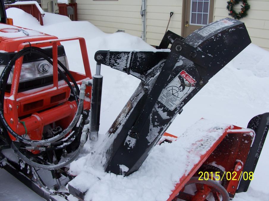

Here is a chute level adjuster me and a buddy made.It used to have the old pin you had to remove and adjust manually,getting out of the machine each time.It is operated off of one of the rear remotes and works great.
Dang,could you give some details on that front mounted snow blower?I just bought a L2900,and wondered if one would work on that?Thanks
