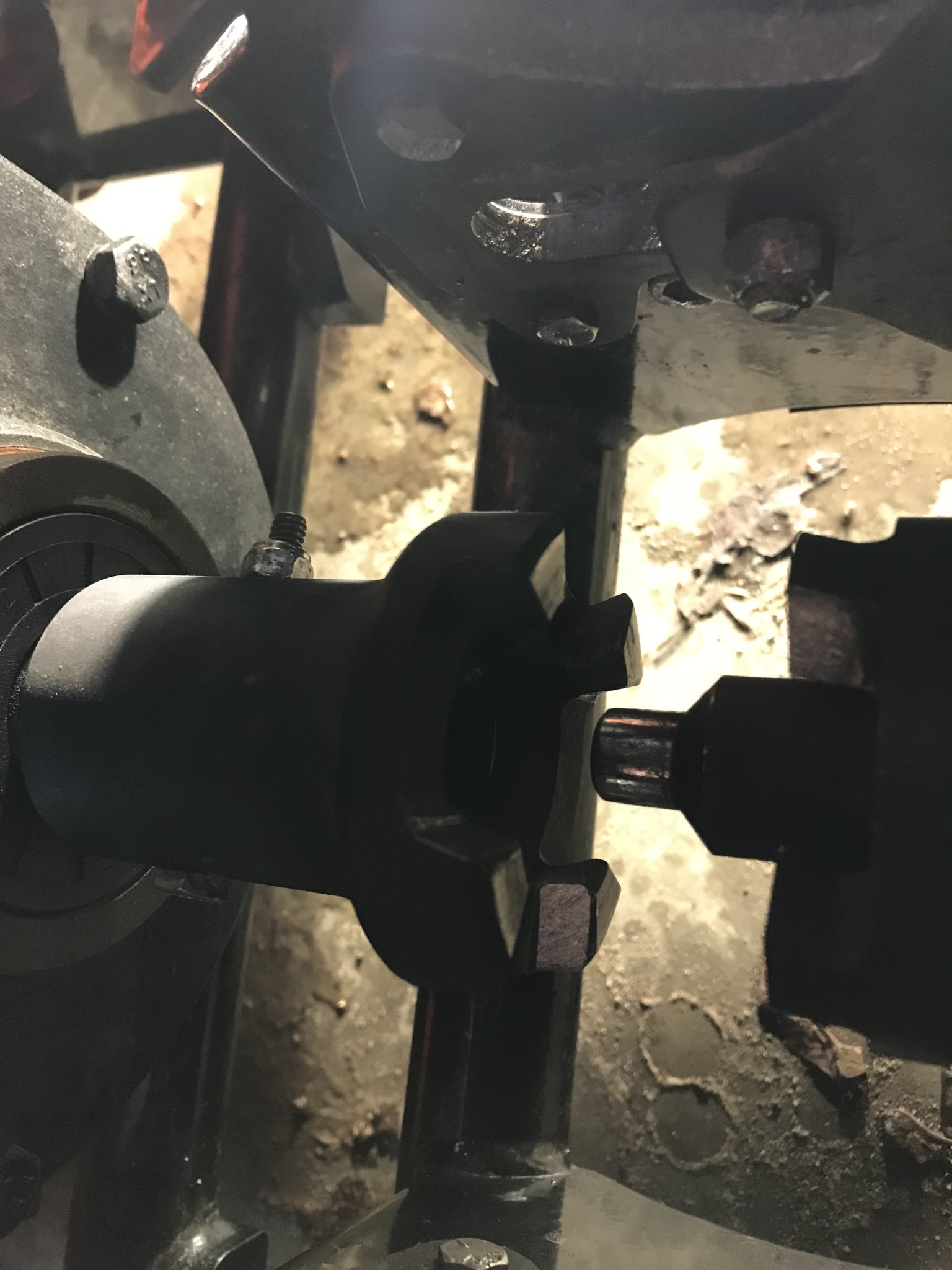

Update, my dealer said both of those pieces are worn out. The question is why? Probably 20 hours on blower, I always engage at idle and have never broke a shear pin. It is a mystery and makes me miss my old 59” John Deere front mount blower that gave me 22 years of 0 problems.
There must be an underlying issue that caused this wear.

As I said originally, there is something that is out of alignment or not set up correctly. You are not the first person with this problem, and being a newer design, the snowblower manufacturer might come up with a better system going forward. Once my snowblower is on the tractor I don't disengage the connection, unless I am checking it for a broken bolt. The broken bolt is an ongoing problem, and I believe that it is the low-speed torque that is causing it. I also run my blower at maximum RPM all the time.

That *IS* the $64,000.00 question.
Are you constantly engaging/disengaging the PTO/blower? (like every time you back up for example?)
Are you running your blower below 3000wpm?
Does it run smooth at your chosen RPM (not vibrating)?
Are you ever ENGAGING (or disengaging) it at 3000rpm? (better to do that at somewhere above "idle" but well below full RPM) (like maybe 1200-1400rpm)...I find if I engage mine at idle it thumps, engine lugs and it does not feel right. At 3000wpm, it doesn't feel right either.
Are you lifting it very high when going into a snowbank or when backing up?
Are you trying to blow snow with it lifted off the ground? (angled)
Something is making it wear out.
(with no disrespect intended) There is a CHANCE it might be something you're doing that you don't even know.
(or you got one built on Friday at 4pm or Monday at 7am--who knows.
"...Update, my dealer said both of those pieces are worn out. The question is why? Probably 20 hours on blower, I always engage at idle and have never broke a shear pin. It is a mystery and makes me miss my old 59” John Deere front mount blower that gave me 22 years of 0 problems.

So both couplings arrived today. I will replace tomorrow but like ve9aa stated “ something caused this and if it is me I am completely clueless”. I have been blowing snow for 37 years and
this is a first for me.
Snowman7
LX3310 535 loader, LX2980, RB2672, FDR1660
May 20, 2020
406
312
Boyne Falls, MI.
I always float unless I can’t turn. Then I lift it 1/2” so my front tires bite. I probably lift it 4-6” when backing up. I engage at idle(1300), and I normally operate at about 2300-2350.

When you lift the blower section, does the 'coupler' attached to it ALSO move , relative to the 'coupler' on the PTO shaft ??
I look at this 'coupler unit' as being similar to a U-joint, but not connected with a 'cross'. If the two sections really do change the 'angle' when lifting/lowering then I'm super happy I didn't buy that 'system'.

I read Dusty's article but I'm away from home right now but I'm going to check when I get back and see if mine has wear. To be fair though I have the BX not the LX the coupler looks in the pictures to be same fundamental design. On the BX there are multiple u-joints in the k-connect hitch and those angles do change when you raise and lower it. It's not obvious that is has any effect on the coupler engagement but now you can bet I'm going to check it. Thanks Dusty for the heads up.

I ran mine last week for the first time after the major snow storm. Lots of areas of heavy snow on my 4000 foot driveway. I engaged the pto at idle and operated at around 2200 rpm. Everything operated smoothly with no vibration or strange noises.
These connection points are held together by strong springs so wondering what would cause the OP's coupling to prematurely wear. Did it always operate smoothly up until recently?
Looked at the design of mine and would consider replacing this assembly with a telescoping driveshaft as there appears to be enough room for one. This of course only if I started to have similar issues.

I downloaded the BX2816 snowblower manual, and if it's typical of the K-connect system I now understand the how and why they fail. The problem , as I see it, is that the 'coupler' is NOT designed to have much (if any ) angle between the two mating pieces, unlike a U-joint.
As designed you should ( are supposed to ??) lower blower down, engage PTO,increase RPM to max,use it, reduce RPM to idle, disengage PTO, move to next location, repeat as required.
This sequence should make the coupling last longer, but as designed,sooner or later, it will fail
You can extend the life if you can work out a 'route' that keeps raising and lowering the blower to a minimum. Also, when going in reverse, there's no need to raise the blower. For years , I've done one section of my lot that way..back and forth, blower down.
