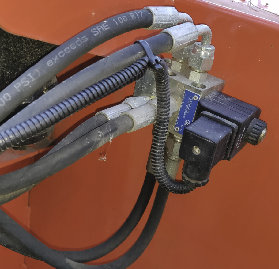

Ok - starting to get this sorted out. If both were working before and now just deflection works sounds like the diverter is dead. Pull the hoses off the motor and check for flow there. Dollars to donuts there isnt any.
Toggle switch in cab plugs into diverter part and does rotation and deflection on chute. No matter toggle position, it only activates chute deflection. Toggle is a single pole on/off. This has worked until now it doesnt.
Diverter valve has been replaced and that did not do the trick.
According to what you just now said- your setup, both chute rotation and deflector, worked in the past. You then said "until now". What has changed from before to now? Was the snow blower chute rotation functional when last disconnected and now not functional since reconnecting it? If so, how was it disconnected? At the diverter itself or at the tractor?
A diverter is very simple. Two hydraulic inlet ports and two sets of two hydraulic outlet ports. A DIN electrical connector connects the wiring to the solenoid body. The solenoid moves the spool back and forth to select between the two sets of outlets. Yours may or may not be similar to this but it shows a typical diverter setup.
If you're getting flow to the chute deflector, that says that you have flow TO the diverter. The issue lies within the diverter itself- either the hose connections are wrong or the internal spool isn't moving. You said you replaced the diverter. Did that include the solenoid mounted on the diverter?

What leads you to believe he is not using the third function? Details have been skimpy and confused but at this point my assumption is a third function is being used for BOTH rotation and deflection.
The diverter is on the snowblower and the toggle switch determines which actuator is controlled the the 3rd function valve. That's simple and reasonable.
Using the bucket spool for rotation simply wont work because one side of that spool is regenerative and cannot operate a bidirectional motor. If he had it plumbed like that it would never have worked.
However it is plumbed it apparently worked in the past. If we can determine whether or not there is fluid flow coming to the motor we would know which part of the circuit has failed.
Disconnecting the hoses at the motor and commanding rotation is an easy and definitive test for that but so far crickets.

As I outlined above I suspect his system works as follows
  1. The maintained position toggle switch is a selector switch that controls the diverter.
  2. The diverter is mounted on the snowblower not the tractor and connects the third function hoses to either the chute rotation motor or the deflector angling cylinder.
  3. To rotate chute you place the selector switch in rotate position and then use the 3rd function buttons to control the motor
  4. To change deflection you place selector switch in the deflection position and use the third function buttons to control cylinder.
Arranged like that the diverter is just a hydraulic multiplier for the third function valve. Its integral to the snowblower and operator friendly. Snowblower hookup is just two third function hoses and one control wire harness for the selector switch.

I understand that. I don't think its the valve itself. Just trying to double check as we go. Can you swap the motor and cylinder hoses without a lot of work?
I am unable to swap that stuff out, I appreciate all the help and will be trying several things and post pics. Haven't been able to do these yet as we gave been using machine to plow

The plug from toggle that goes into diverter was the issue. Plug has insert that pops out with 3 wires. Ground wire had detached. Reattached and works like new. Also fuse for this oper. Is under dash on this model. Newer models have fuse under boot on hydraulic lever.
