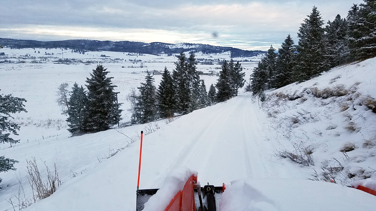

I have an MX6000 with a Land Pride STB1596 hydraulic angle snow blade up front and it's the bees knees on gravel and asphalt for that matter. Depending on how much snow you have and where you're able to push it a blower might be better though. I use a Land Pride SB1574 blower out back that is also very good.
A rear blade isn't ideal for me based on the one I used on a BX25 and the one I used just a few days ago behind a NH tractor. Affordable for sure, but there are better options if you're willing to pay for the benefits.
You can see the before and after when using the front snow blade on the gravel driveway.

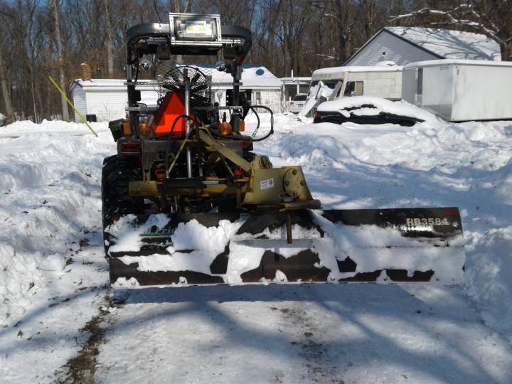

I've owned two rear blades, one I used with the BX25 and a bigger one I used with the MX6000 open station. In retrospect I should have kept the Land Pride RB3796 (corrected) rather than sell it for what I had into it. It's hard to argue against them as an affordable multipurpose implement.
Even though I didn't use the rear blade much, it was still good to have for certain tasks. I have a box blade and a land leveler/land plane which are both way better at moving dirt or maintaining a gravel driveway than a rear blade. I'm just about as pleased as I could be with my current set up for snow removal, but if I had a much longer asphalt driveway I'd buy a rear pull snow blower.

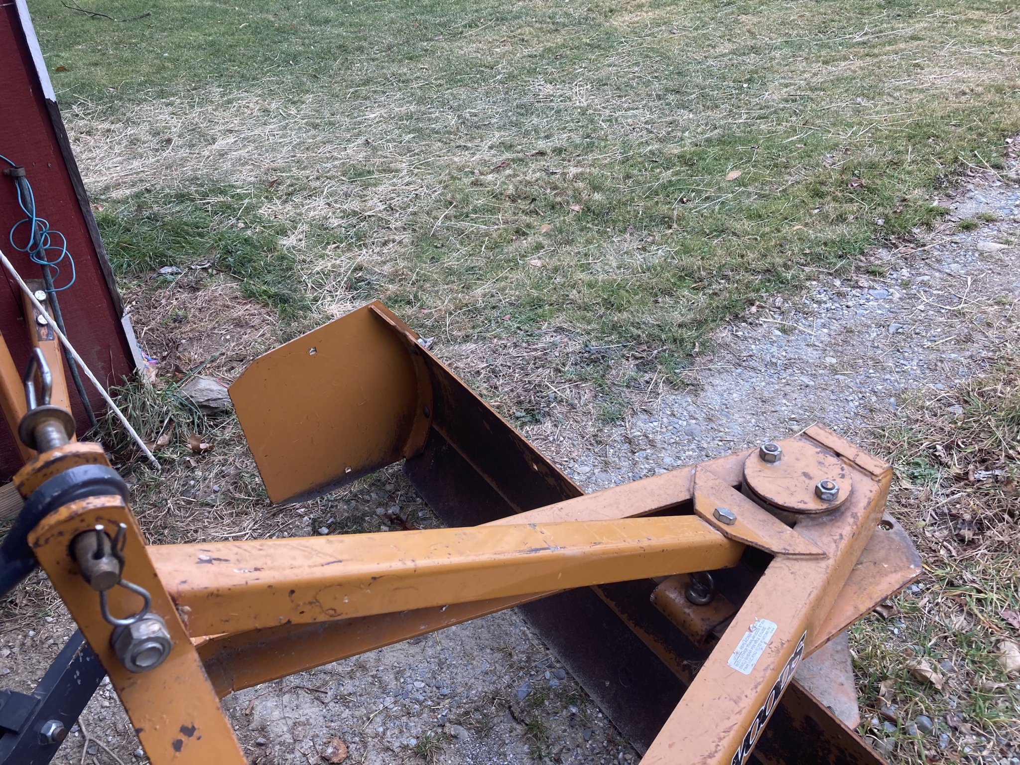

Im going to give this one with wings a try this winter. Last user swore by it. Angled or not, works as a front pusher. For the amount of snow we get, a front blower is stupid $$ and not worth it to me.
