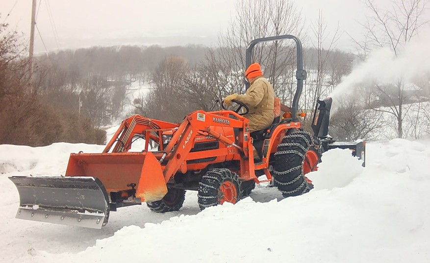

I have a B7610 that I bought from MB there in NH years ago. I have a clamp-on 60" plow on the bucket and a 54" Meteor rear snow blower. I use it to maintain a 1/4 mile of steep (100') gravel road. I generally plow down either side of the road and then snow blow the center pile back uphill. It handles all the snow we get here in the Catskills. I do wish I had the angle plow. Good chains are a necessity. There is a lot of side slip when plowing or blowing. If you don't have a blower you will need a lot of ballast to keep the rear end firmly planted. For summer maintenance I use a rear blade. I would be nice to have a land plane or box blade too. The LX2620 would do the same as this older model.
