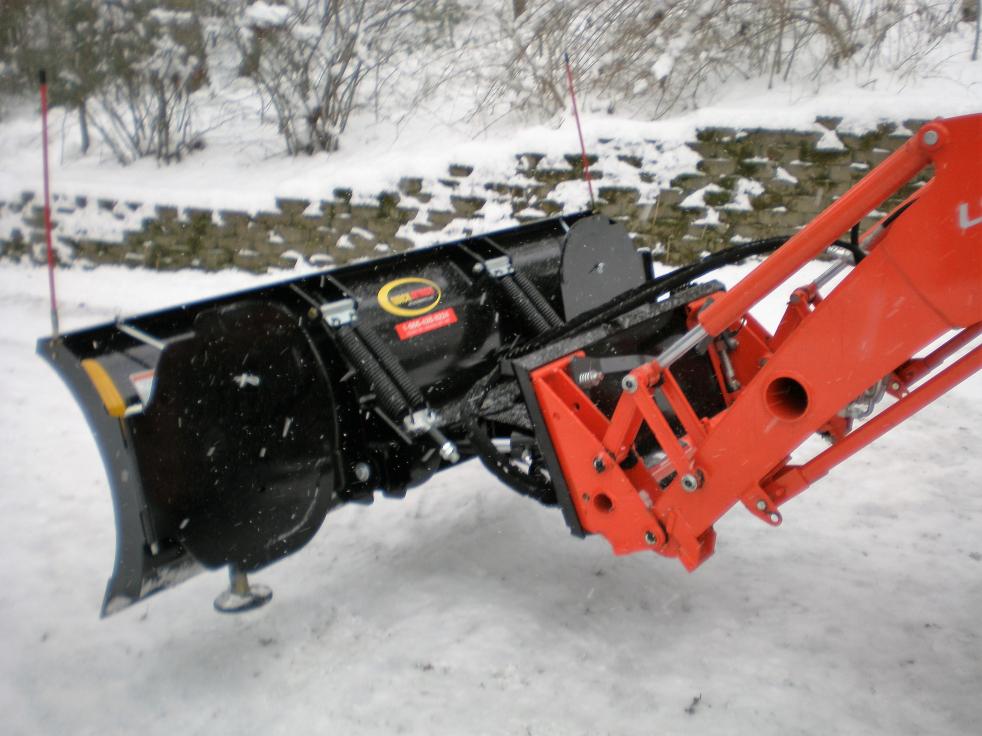

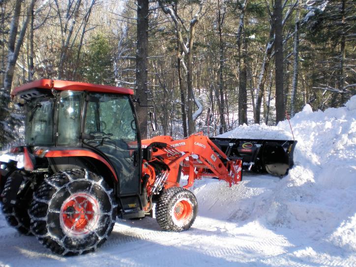

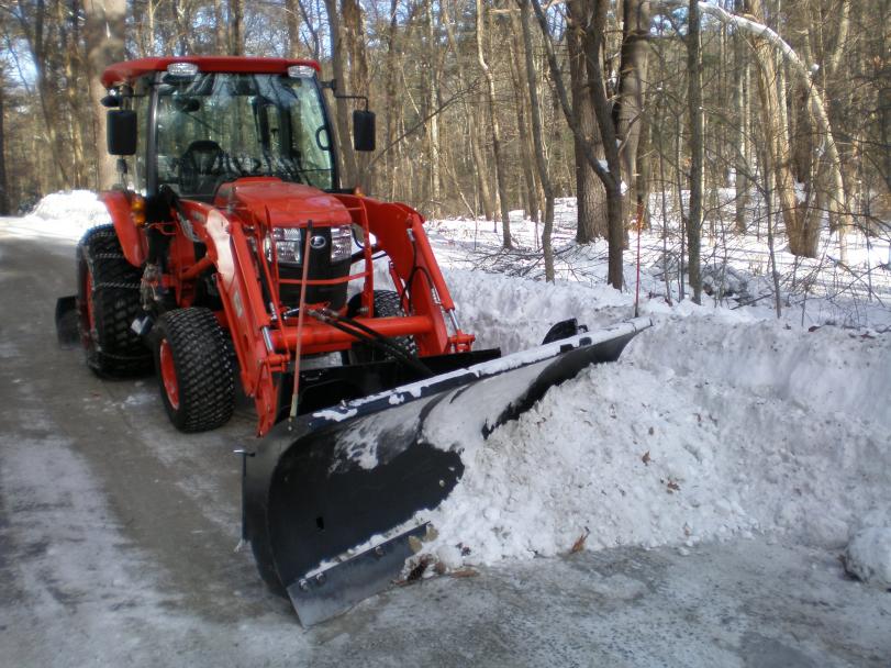

I've got a 1000' gravel drive with a steep hill. Been using a plow from QuickAttach.com for the past 3 yrs. Works great angles and I use chains for the hills and just got front chains because we get ice and I tend to slide sideways. The front chains should help.
