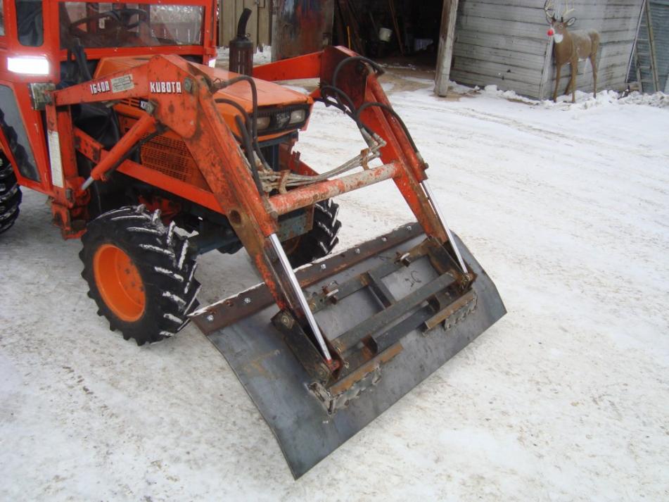

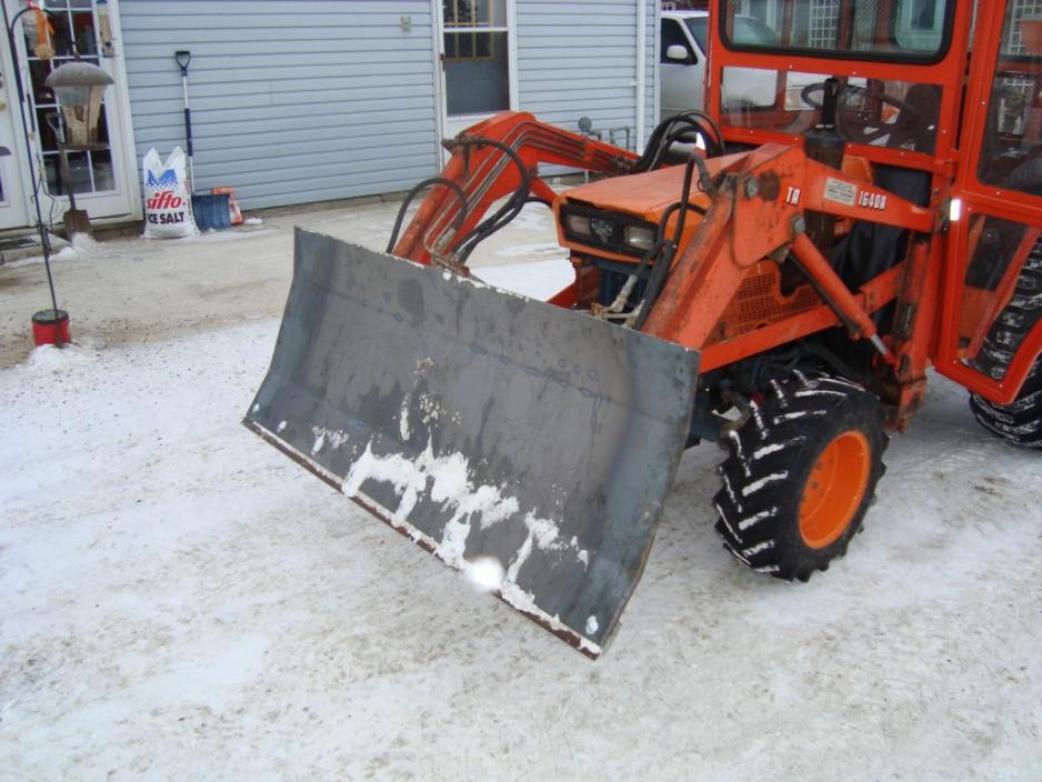

Hey Guy's. Thought I would put my 2 cents in. I do about 15 places in town here. I started off this year using the 4 ft bucket and 54 in blower in mid range hydro. I got ticked off because the bucket is narrower than the tractor(51 in) so I made a 60 in blade 2 ft high cutting edge off of a road grader. This blade hooks right to the Quick attach, no angle, but it does tilt. You can actually tip the blade forward and back drag with the top of the blade. I have discovered that the tractor will push snow in high range. It will also blow snow in high range. I went from 5 hrs to 3 hrs to do my lanes. But in high range you have to be extra carefull around curbs and manhole covers.

Dusty blade looks good. Sounds like you are really enjoying it. wife liked the snow when we lived in Oklahoma dont get that much in Tennessee.handyman

Dusty, I like the custom blade, especially it's ability to pull with the top edge.
