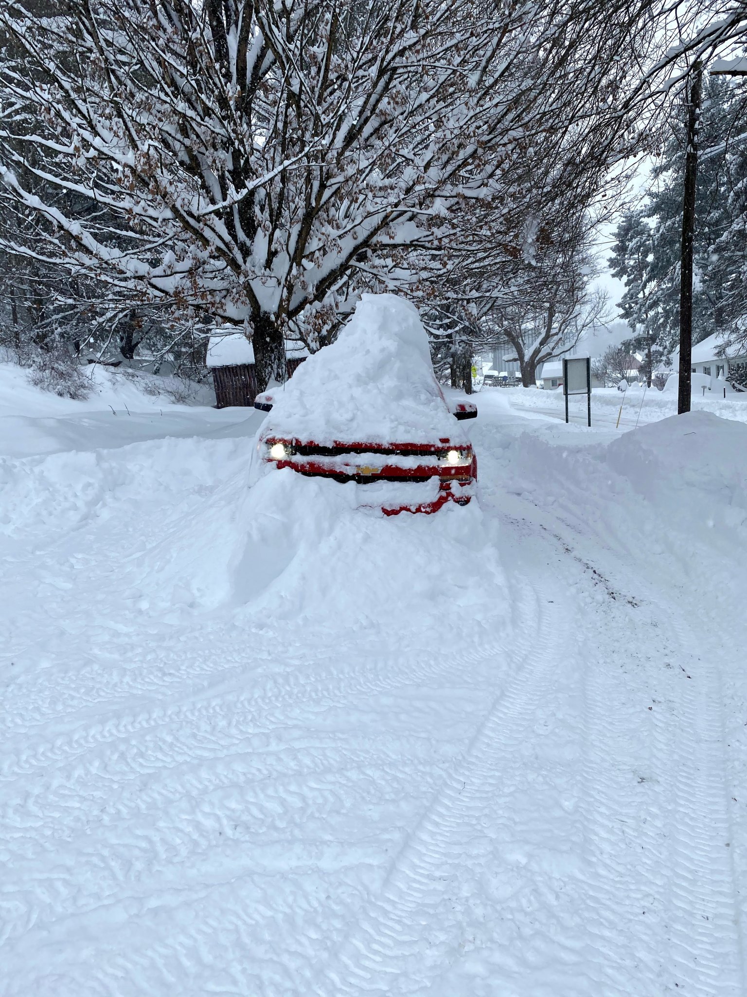

However, we've had many snowstorms of 18-36" hit us where I couldn't push the front snowblower hard enough without chains. Tractor would break traction with chains on.
Like others said - - it's cheap insurance.
You don't want to wake up to 36" of snow on the ground and decide you should put chains on.......(this storm was forecast at 12-18, and we got 35" between 8PM and 5AM)
That’s a Chevy Silverado buried under the snow.

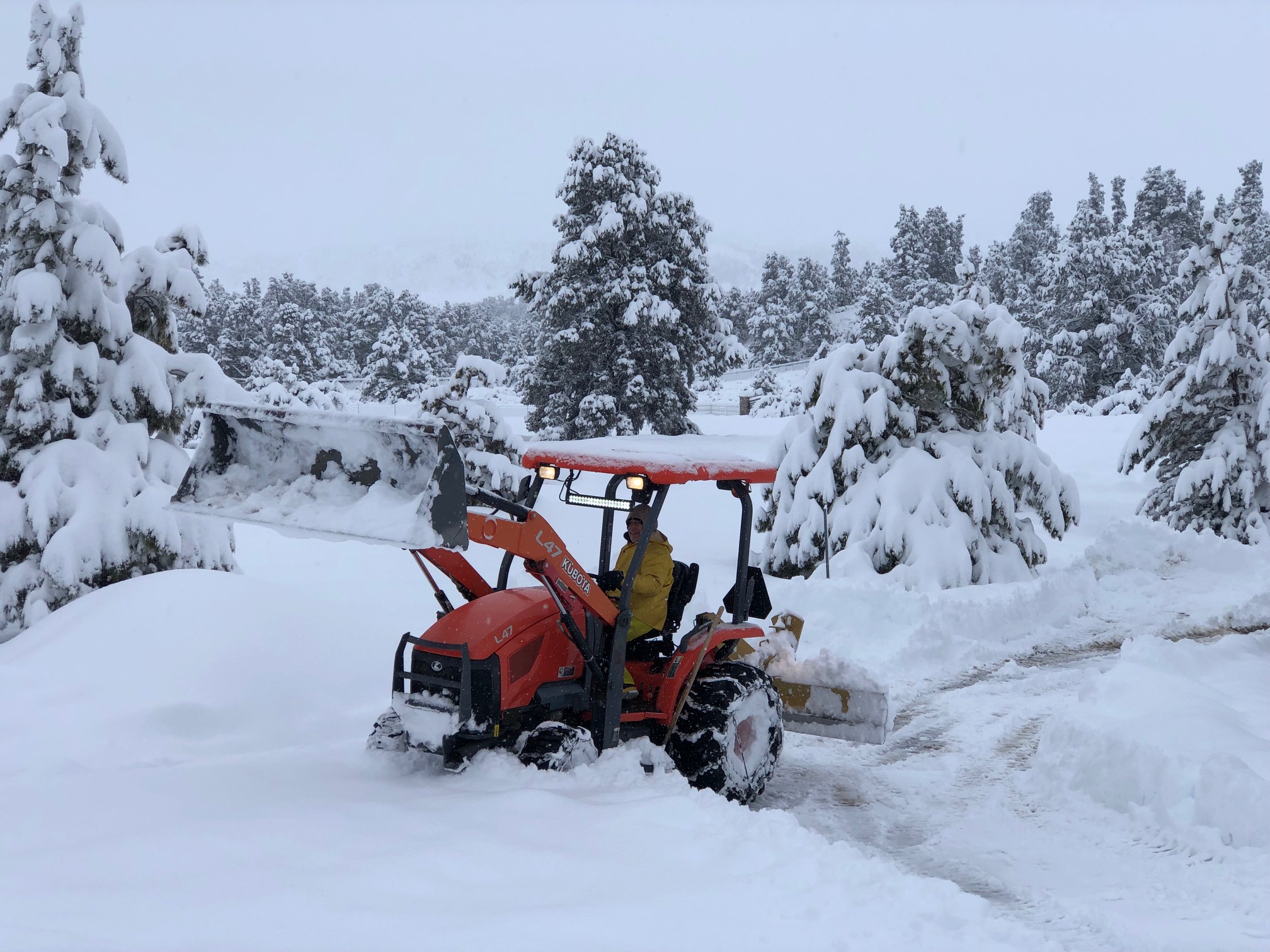

First day no chains needed, this is the 2nd day of 30", icy and snow compacted down to 24", needed full chains, just free semi-truck chains I worked to fit my tractor, worked great. IMG_5368.jpg
10,339
7,383
First day no chains needed, this is the 2nd day of 30", icy and snow compacted down to 24", needed full chains, just free semi-truck chains I worked to fit my tractor, worked great. View attachment 139585
And that's an L47. Pretty stout TLB with the BH off in favor of the rear blade.
The OP is looking to push snow with his BX TLB loader bucket also.
I'm not familiar with his snow amounts, but that looks like a great reason to get chains! ;)

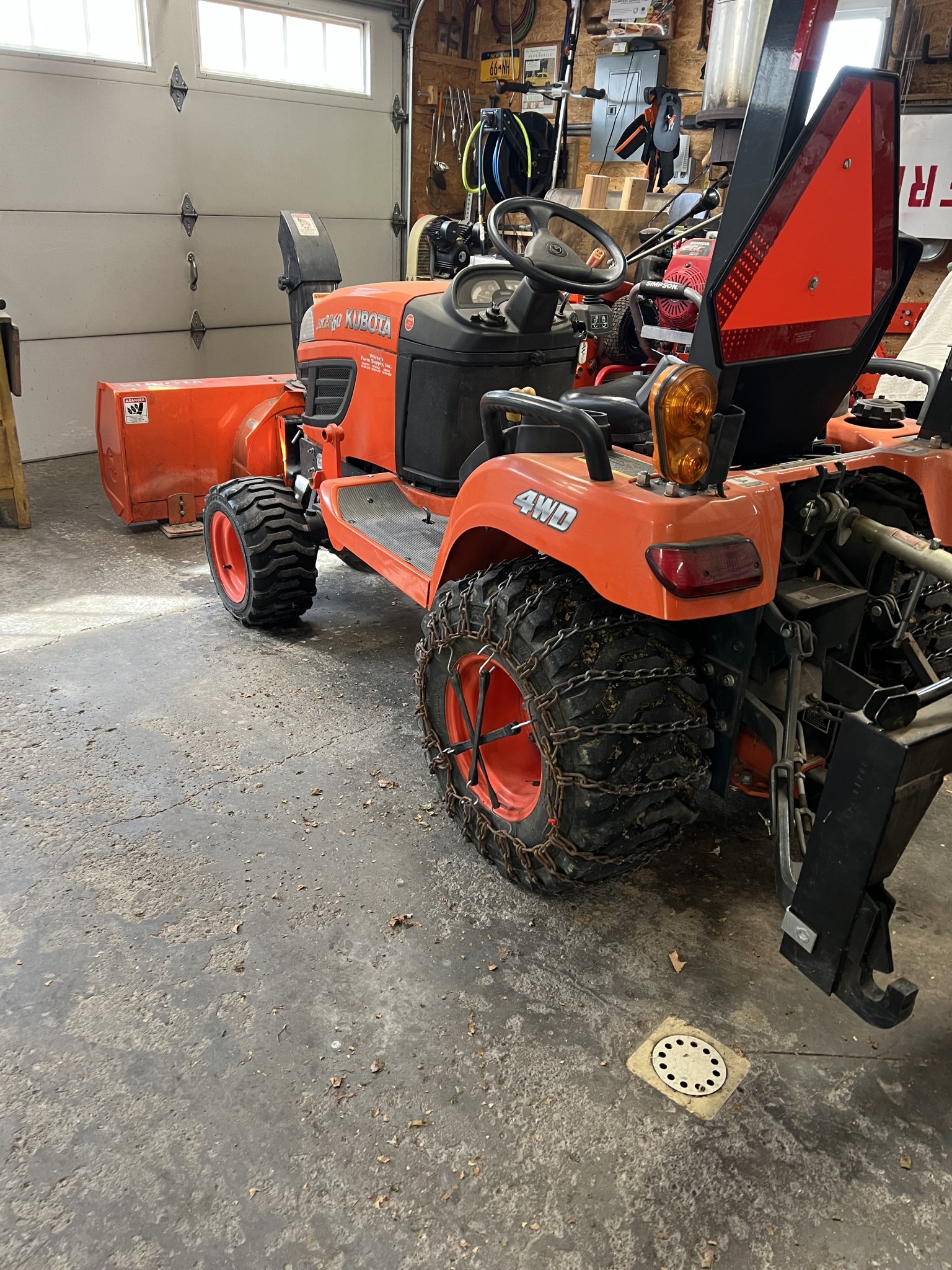

I've purchased multiple sets of two-link ladder chains similar to the ones on your tractor from tirechains.com for various tractors and found all to be well made and reasonably priced.
Two-link ladder chains ride and grip much better than the less expensive four-link ladder chains and are suitable for most applications.
Of course, tire chains are sold to fit multiple tire sizes, and it is usually necessary (and certainly advisable) to fit a new set to a specific tire size. Few people take the time to do this resulting in poor fitment and the need for otherwise unnecessary accessories to keep the chains in place.
Properly fitted and installed, tire chains will remain in place without the need for tensioners, bungees, etc.
