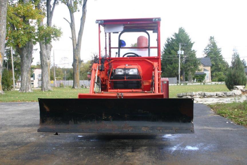

That is why I have 6' snow blade at the front of bucket, Randy.
So, I could clean the snow quick with snow blade. and then using snow blower to clean more effectively and far away. and then when it start making a big mountain of snow, I start use bucket to pile them up nicely too.
but now I have a problem with snow blower for not having "Live PTO".:mad:
