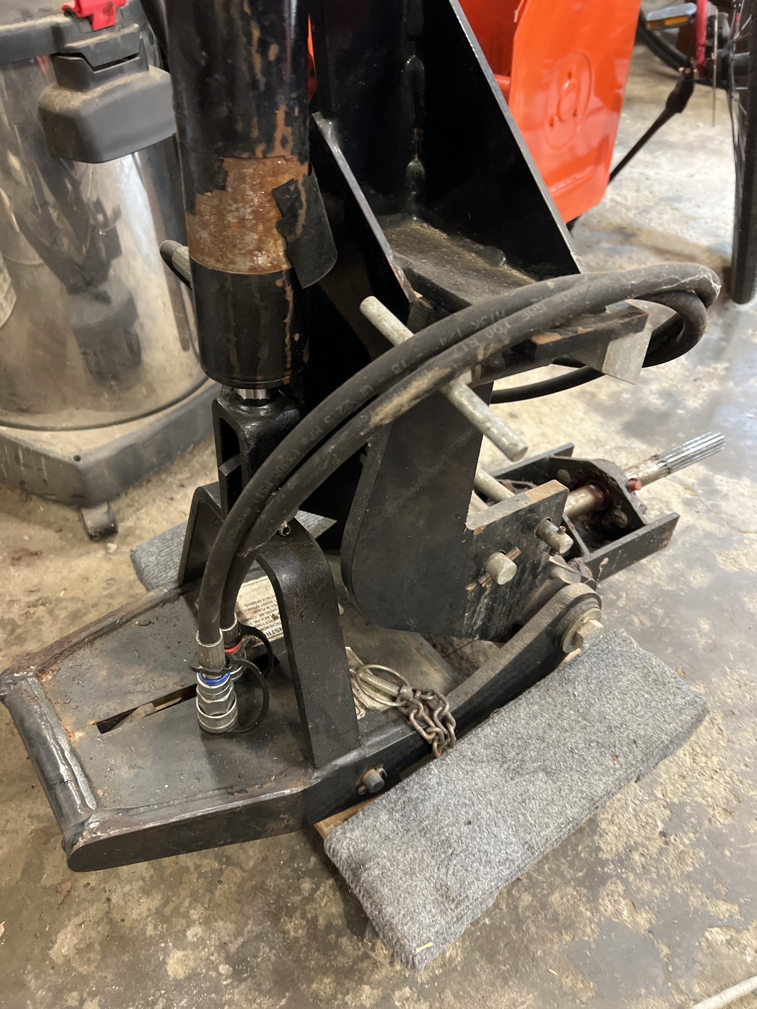

This is the hitch for my BX2750D snowblower. Guessing one to fit your need would be similar. Just don’t know if it can hook to your BX23S.
