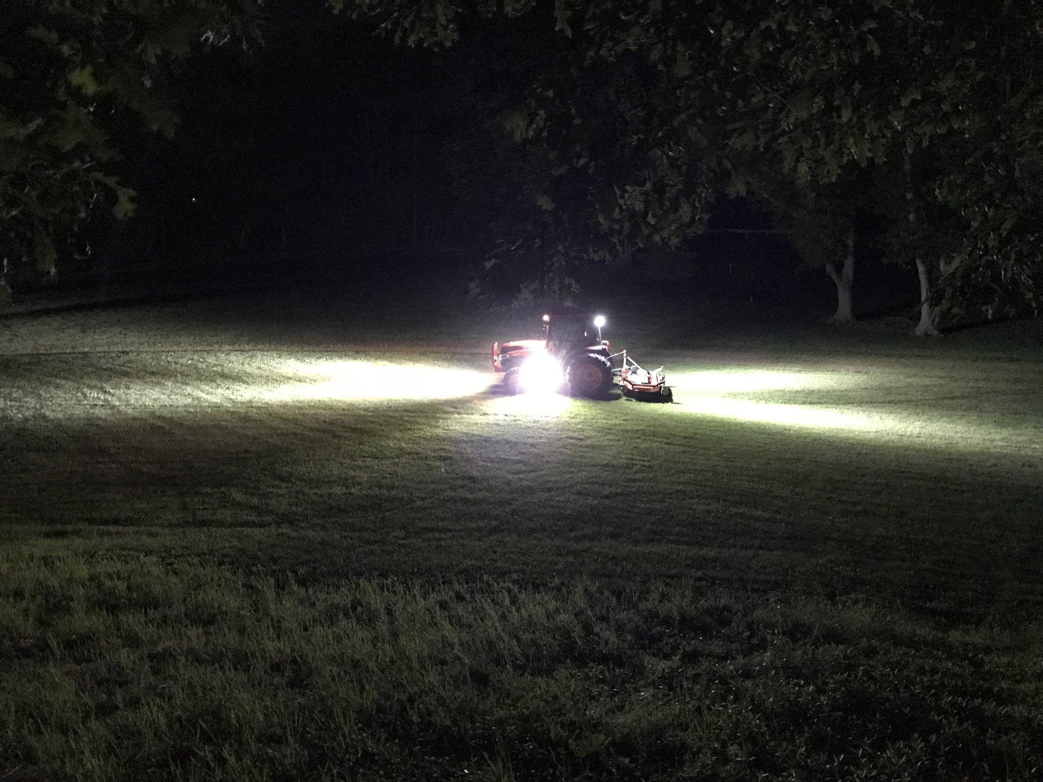

I's nice to have wired lights that come on with the flick of a switch and stay on till you're done with the work. No batteries to fool with and as much light in any direction as you need. Separate switches for different levels are useful. IMG_5387.JPG

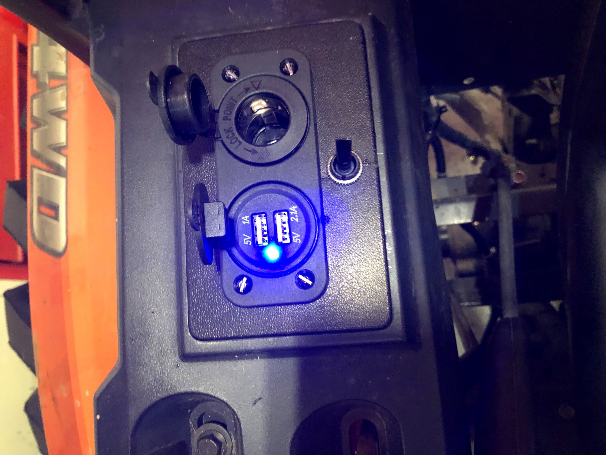

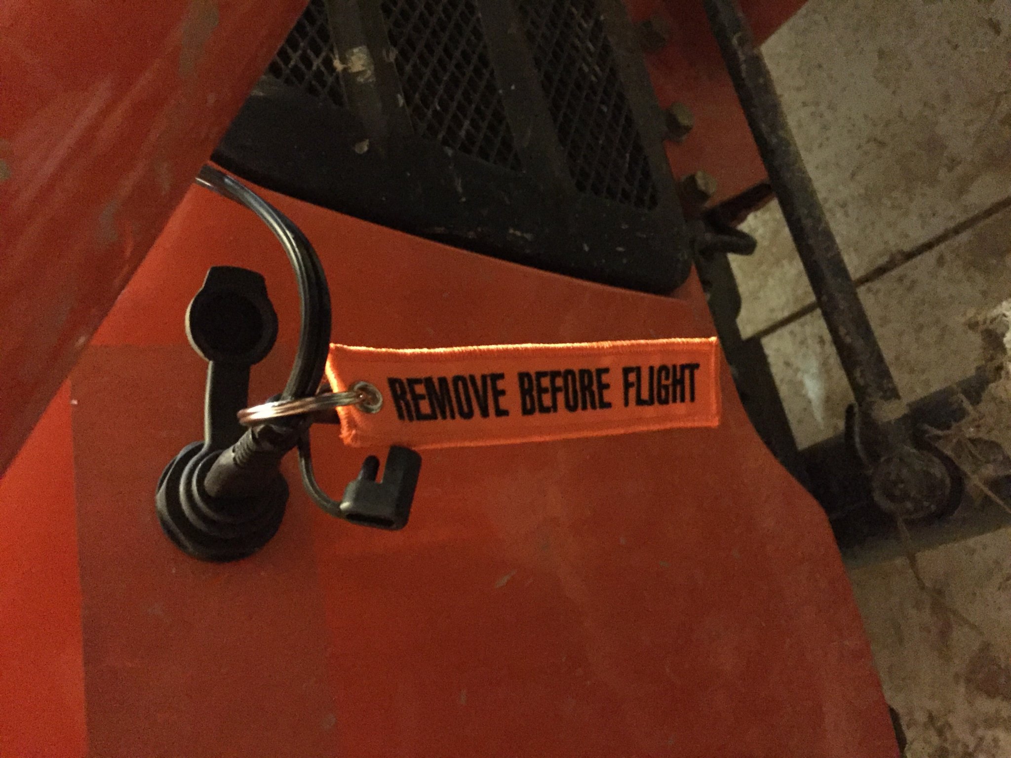

Have you considered using an accessory plug that gives you 12V when needed? I have 2 I can use, one up front that hooks to the battery for my Battery Tender and the other back by the seat that I use for my light bar on my ROPS. The only pain there, depending on the implement in use would be running and securing the wiring harness a3.jpg Tender Port.jpg
