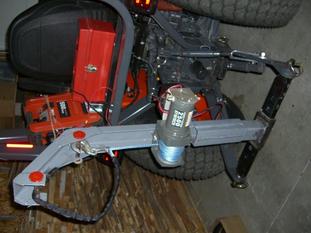

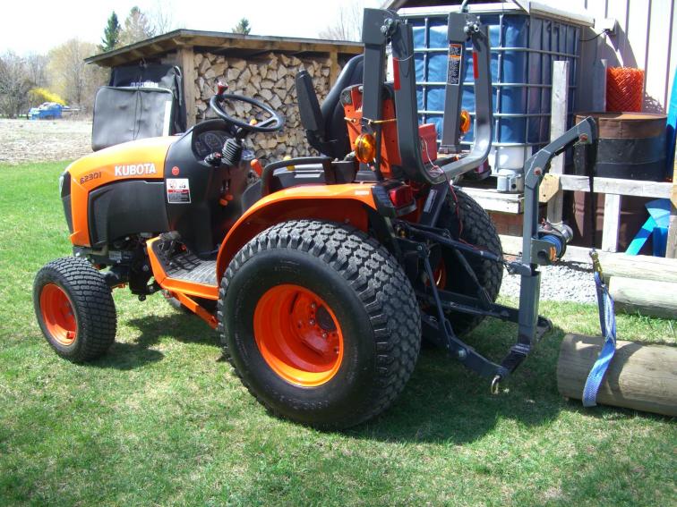

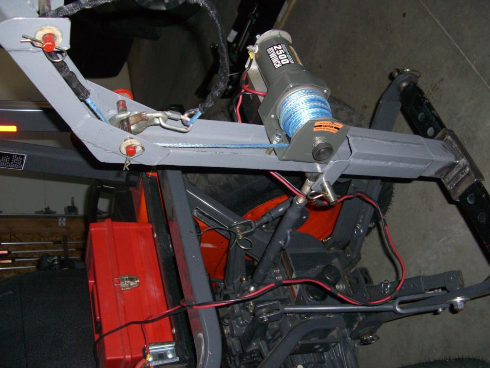

Well, the lure of some scrap steel was too much and I put together this little lifting rig.
It mounts onto a drawbar and is located with a section of C-section, bolted through the drawbar with a 3/4 inch bolt. The top link allows for forward and back adjustment and I just fitted the small winch I have as an add on, I intend to mostly use a chain as its function is to suspend logs so I can drag them.
I did my first test lift today and managed without much effort to lift my snowblower, a combination of winch and lift of the 3 -point.
It is quick to install and after all, it was free, so what's not to like.
Not the prettiest thing I have ever seen but functional.

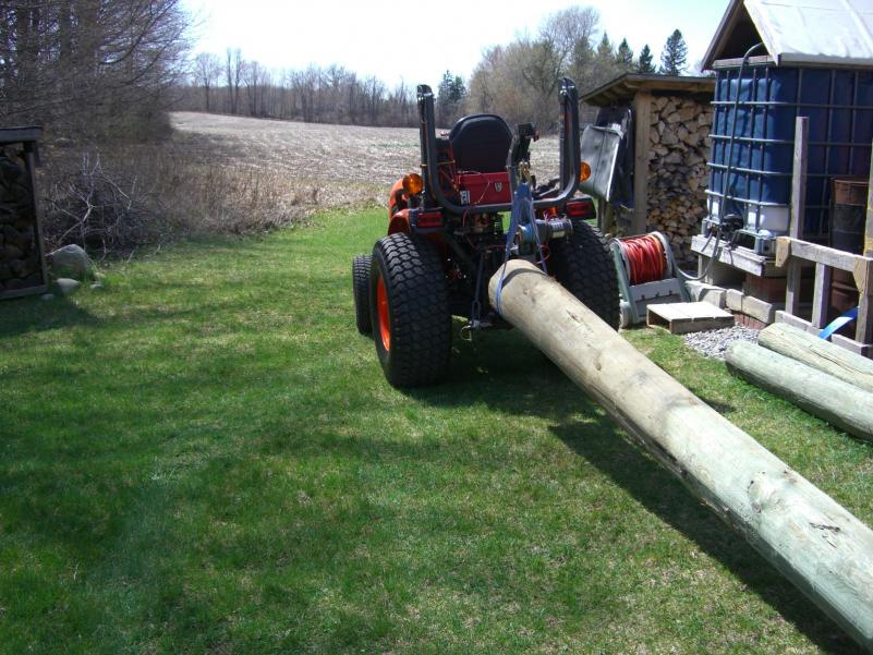

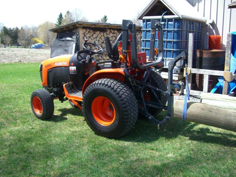

Well, after all, the debate about wheel stands and the like I decided to do a static lift test.
I noticed on the wheelstand thread that it was mostly as a result of the object that was being pulled in fact still being fixed, tree not fully cut through and the like.
I only had a 12-foot length of a utility pole with a 12-inch base, this is heavy but not wet wood or fixed to anything else.
It was just to see if the winch would lift it with the unit at the lowest position, and if it did was there any noticeable lift to the front, the second was to lift the winch as high as possible again with the unit at the lowest point and see if any front lift occurred and the last was winch high and the unit at max lift on the 3 point, again to see if any front lift was noticed.
All 3 actions resulted in no noticeable lift. These were all static tests, no moving was involved, it was just to see what if anything happened.
I am in the process of making a small dolly that will fit under the trailing end of the log so it is fully off the ground, a bit like a semi and trailer.
I do not log in wood at my property, this is for when I get log lengths delivered and I want to relocate them if they are in the way. It is also just to lift things that are too heavy for 1 person to move.
I am sure all their safety comments and concerns are valuable to other maybe looking to achieve a more radical outcome from this attachment. As always sense and foresight are paramount.
