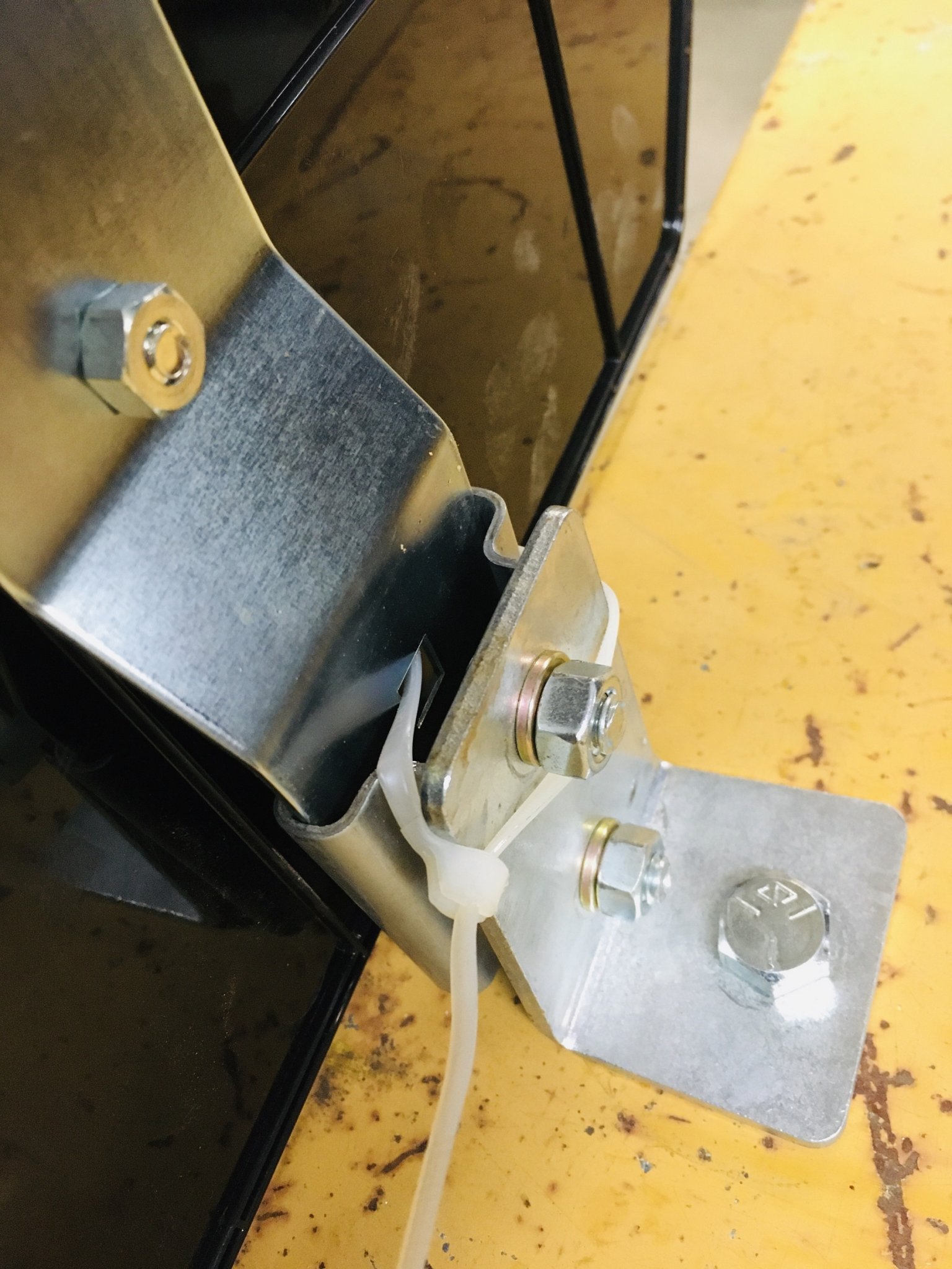

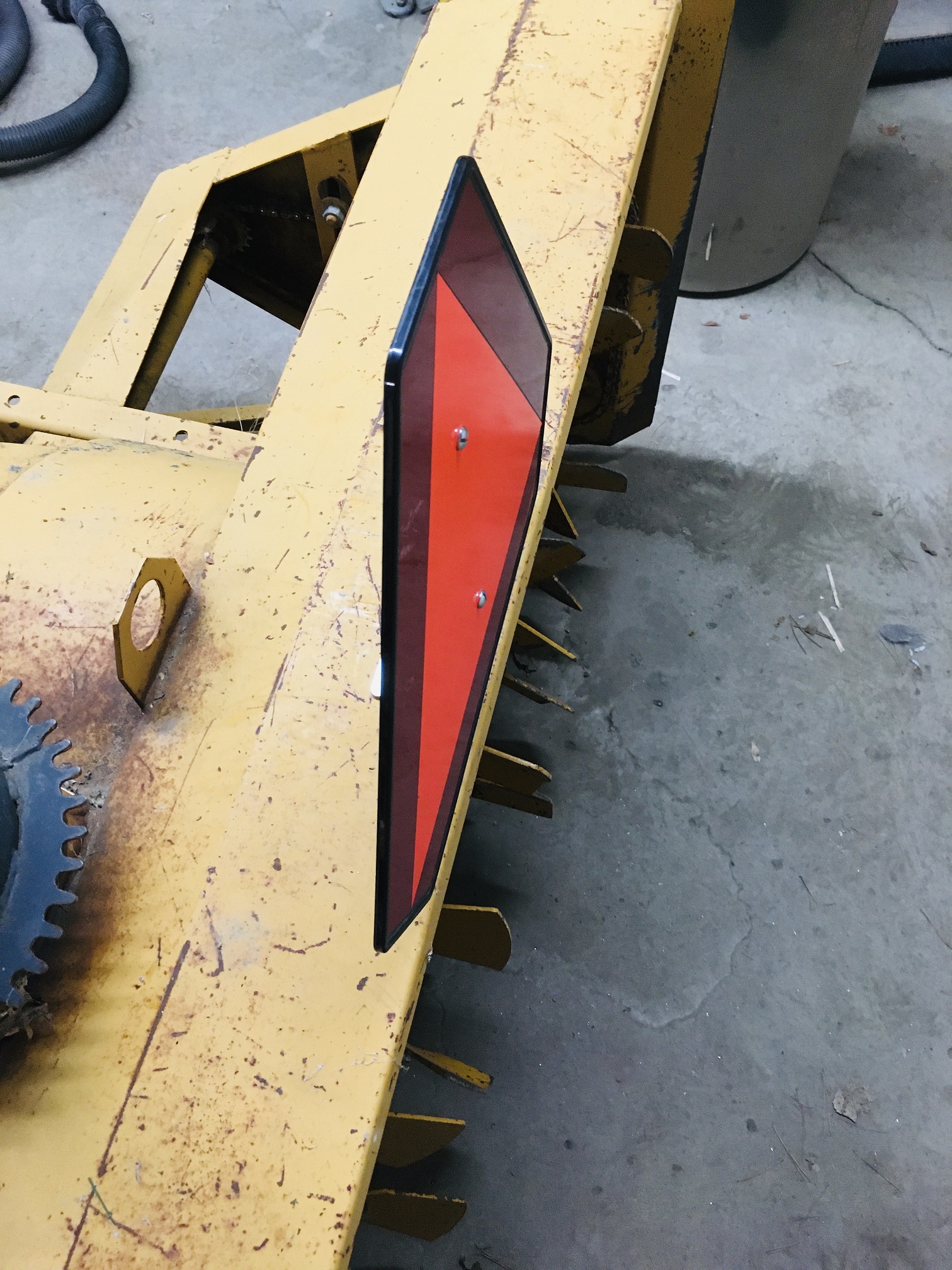

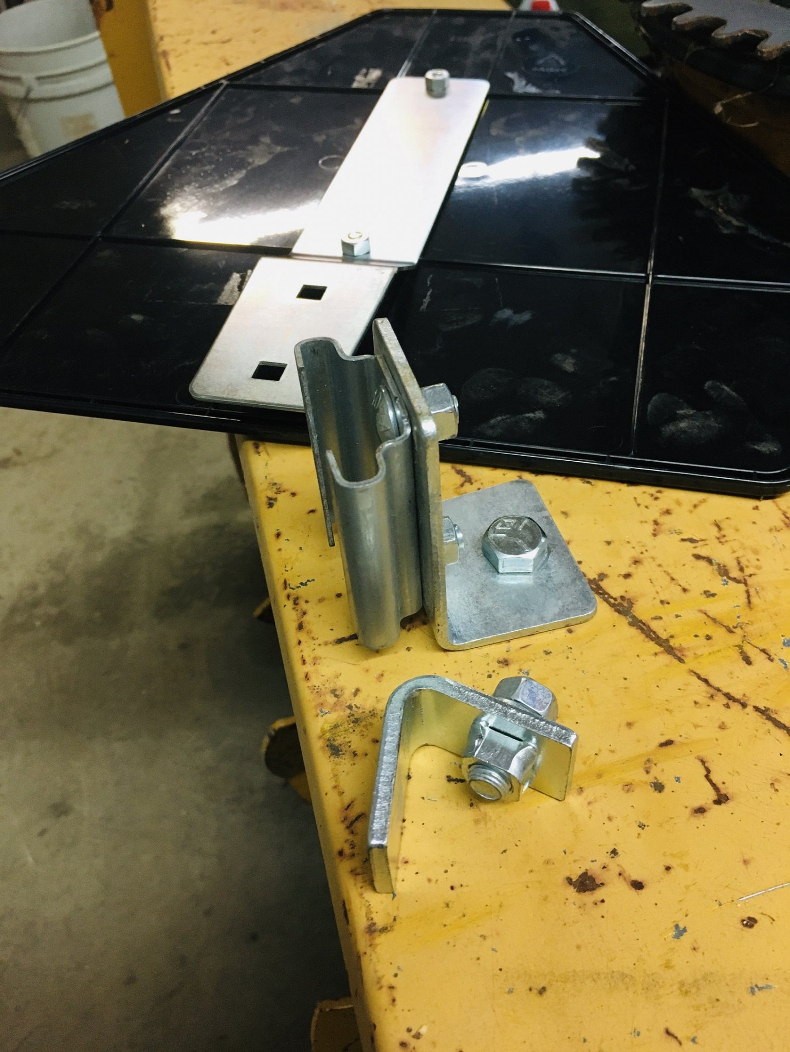

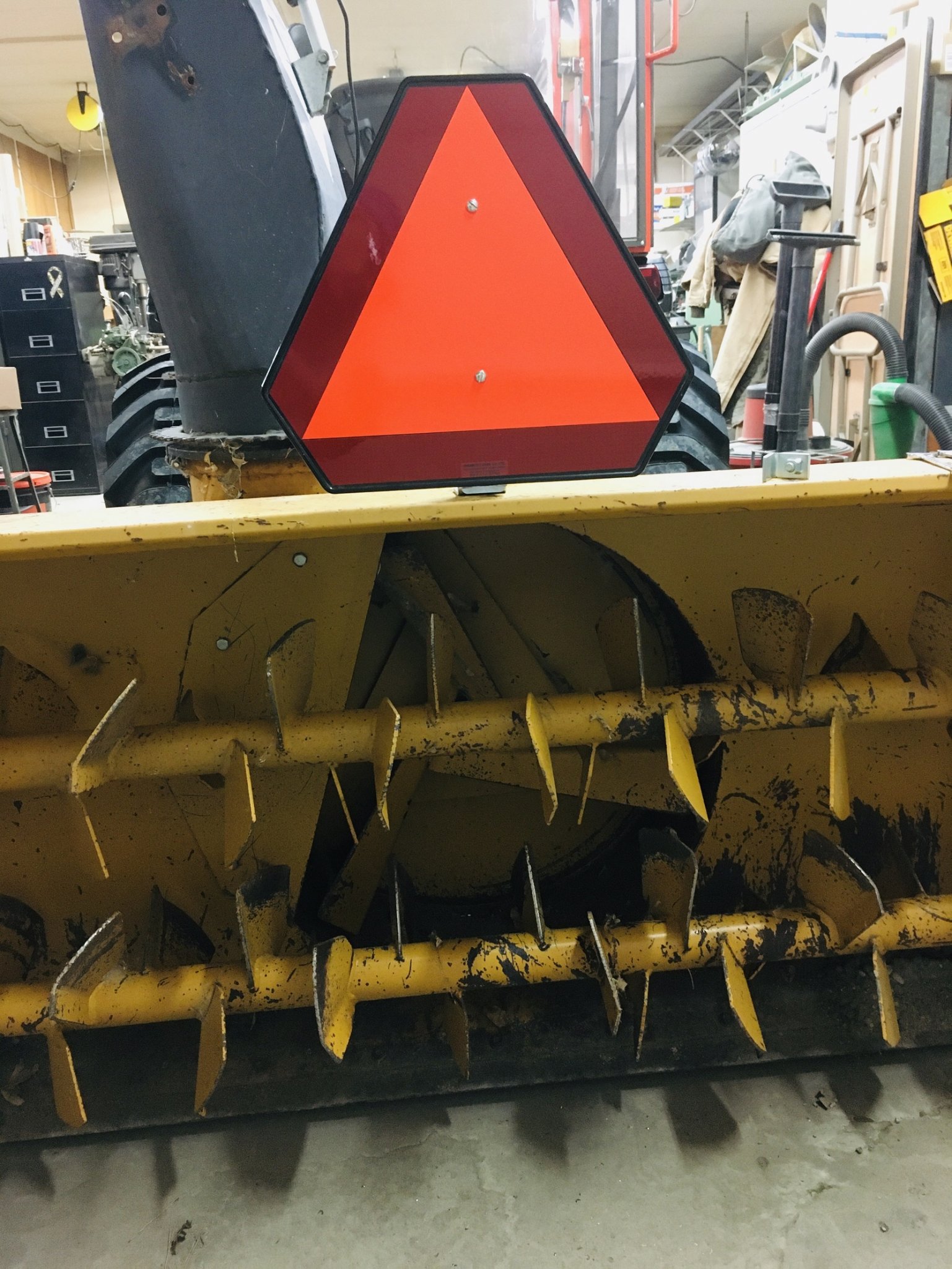

Getting my snow blower rig ready for operation today I started thinking it would be wise to have a SMV sign mounted somewhere. Especially since I help take care of a few neighbor’s driveway that live nearby. And it’s getting harder to time the trip between driveways with the increased traffic on the roadway. At first it looked like the answer was to build a new mounting bracket for the SMV and attach it to the snow blower. Then I spotted the unused bracket on the backhoe and as the French would say, “Voila!” Or for the Norwegians amongst us, “Hoot Tee Too!” (although I’ve never been able to find the correct spelling for that phrase.)
One part was removed from the bracket. The “socket” part was reversed on the bracket as the bracket gets bolted on upside down on the back of the snow blower. One could even remove the socket part and just bolt the sign to the bracket with those same screws. But not knowing how much vibration there’ll be on the mounting, I chose to be able to remove the sign if need be and store it inside the cab. Then it can just be placed in the socket when traveling on the road.
To try it out first, a tywrap going through the SMV and around the bracket should keep it from vibrating out and getting chewed up in the blower. I’ll feel a little safer on the very short road trips between neighbors with both flashers and the SMV sign being visible. Come spring, it’s only one bolt to remove and a couple of minutes to put it back together for mounting on the backhoe or the rear of the tractor again. Things never go this well………there must be a gremlin hiding somewhere!

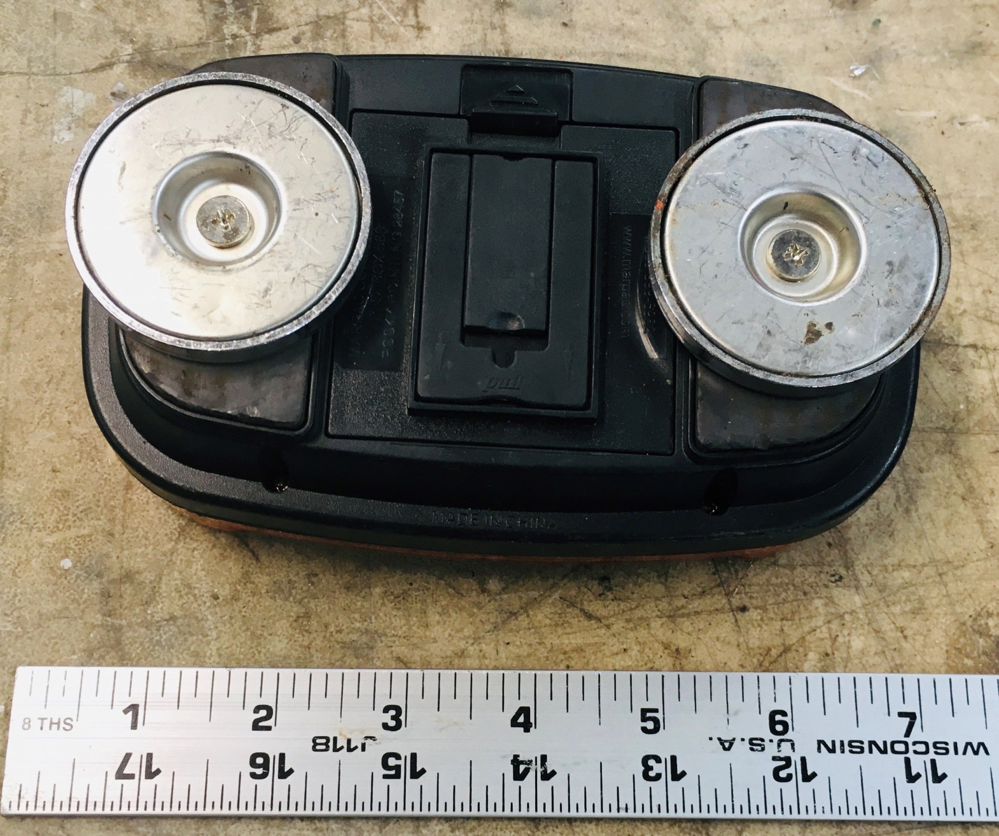

I have a magnetic mount flashing LED that's battery powered, the batteries last all season. I just stick it to the ROPS. and it doesn't fall off.

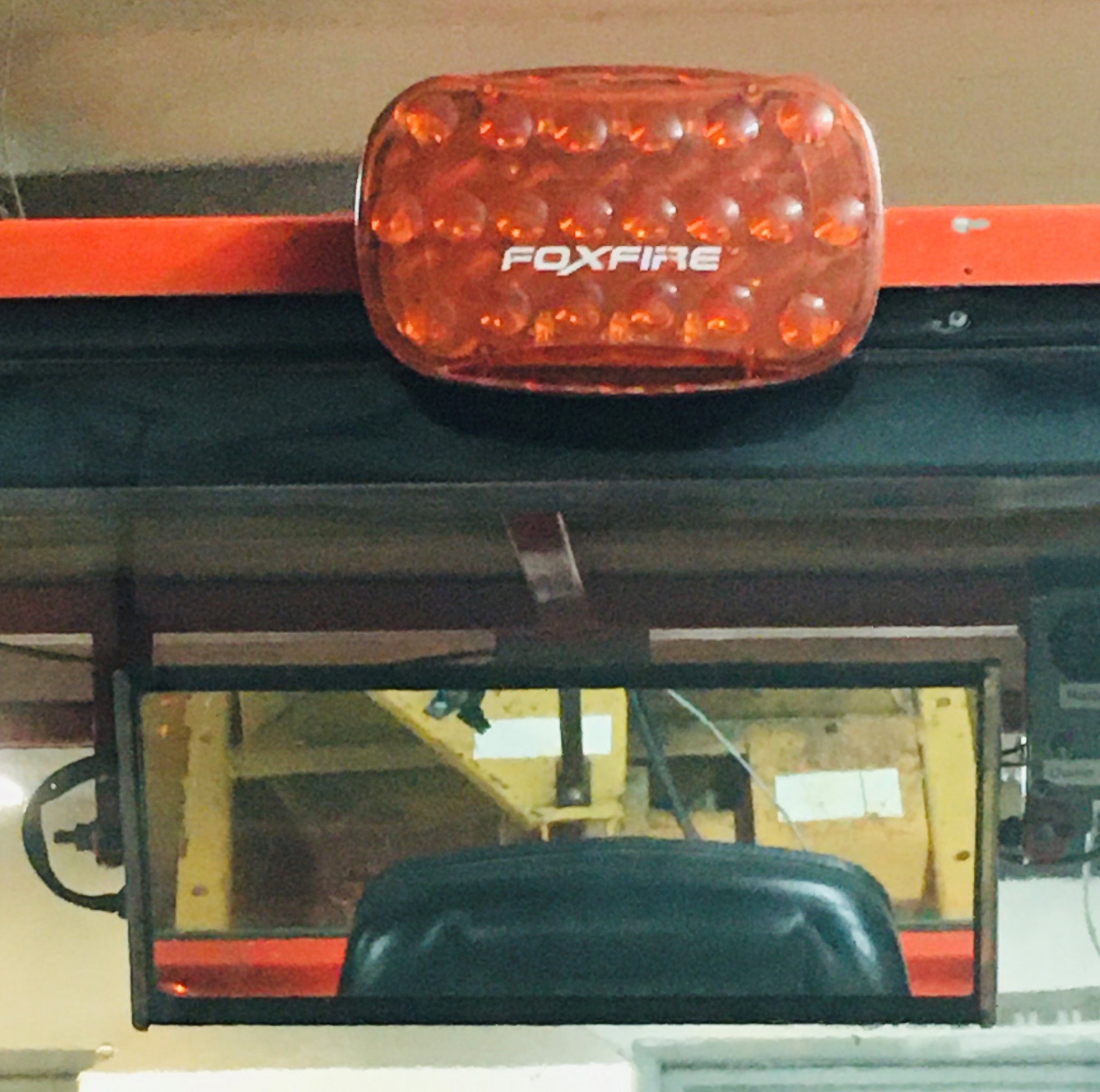

Same here. I stick this to the outside edge of my metal roof. It could be mounted inside for ease of turning On/Off, but then the side flashing LEDs get hidden by my cab corners. The batteries seem to last forever in these things and no worries of the magnets letting go.
You can see the wide back up mirror pretty clearly in the 1st pic. No need to look back over the shoulder except for safety reasons at the end of the driveway or working right next to a building. When pushing snow forward with the snow pusher the mirror keeps track of anyone coming up behind the tractor.
