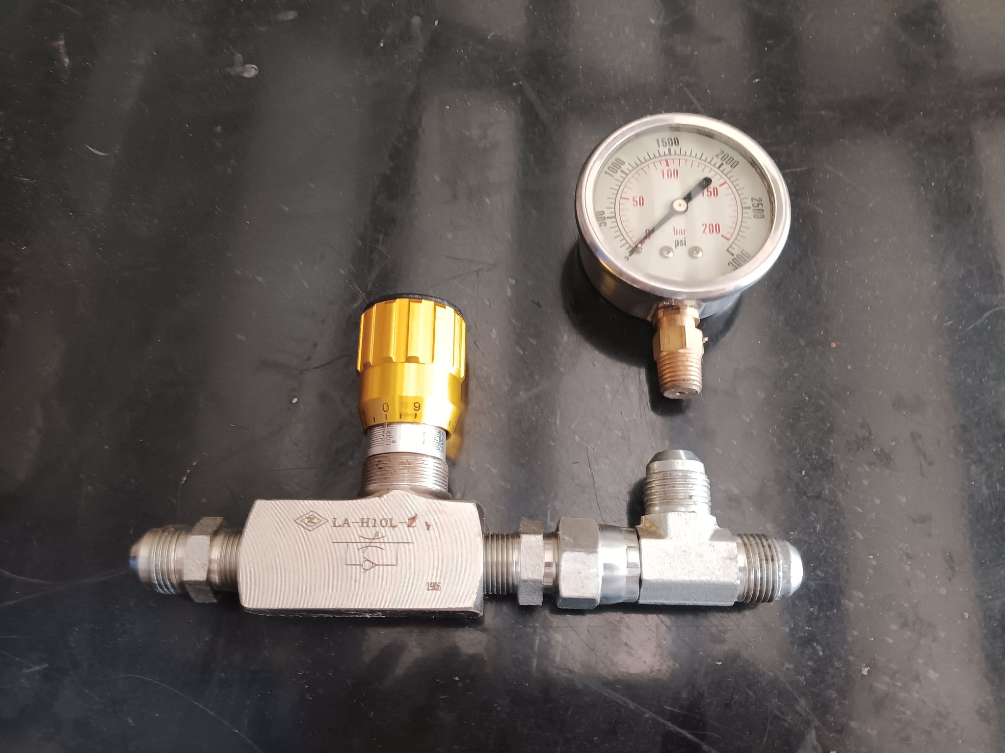

Same setup as you had on the inlet but put a valve between the tee and the port. See pucture below.
Open the valve, start the tractor, snd observe pressure as you gradually close the valve. If the pump is working you will get to 2500 PSI before the valve is fully closed.
