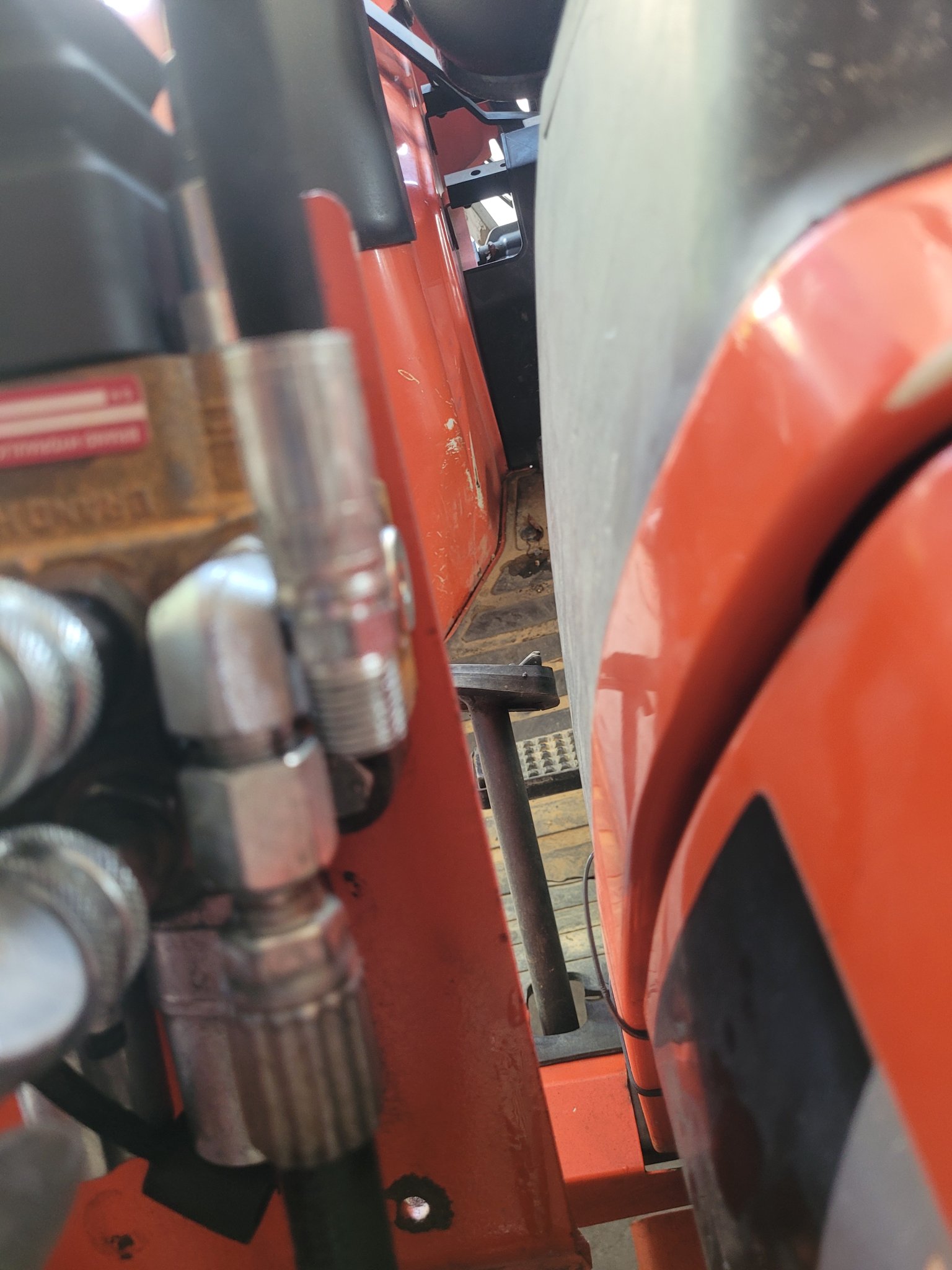

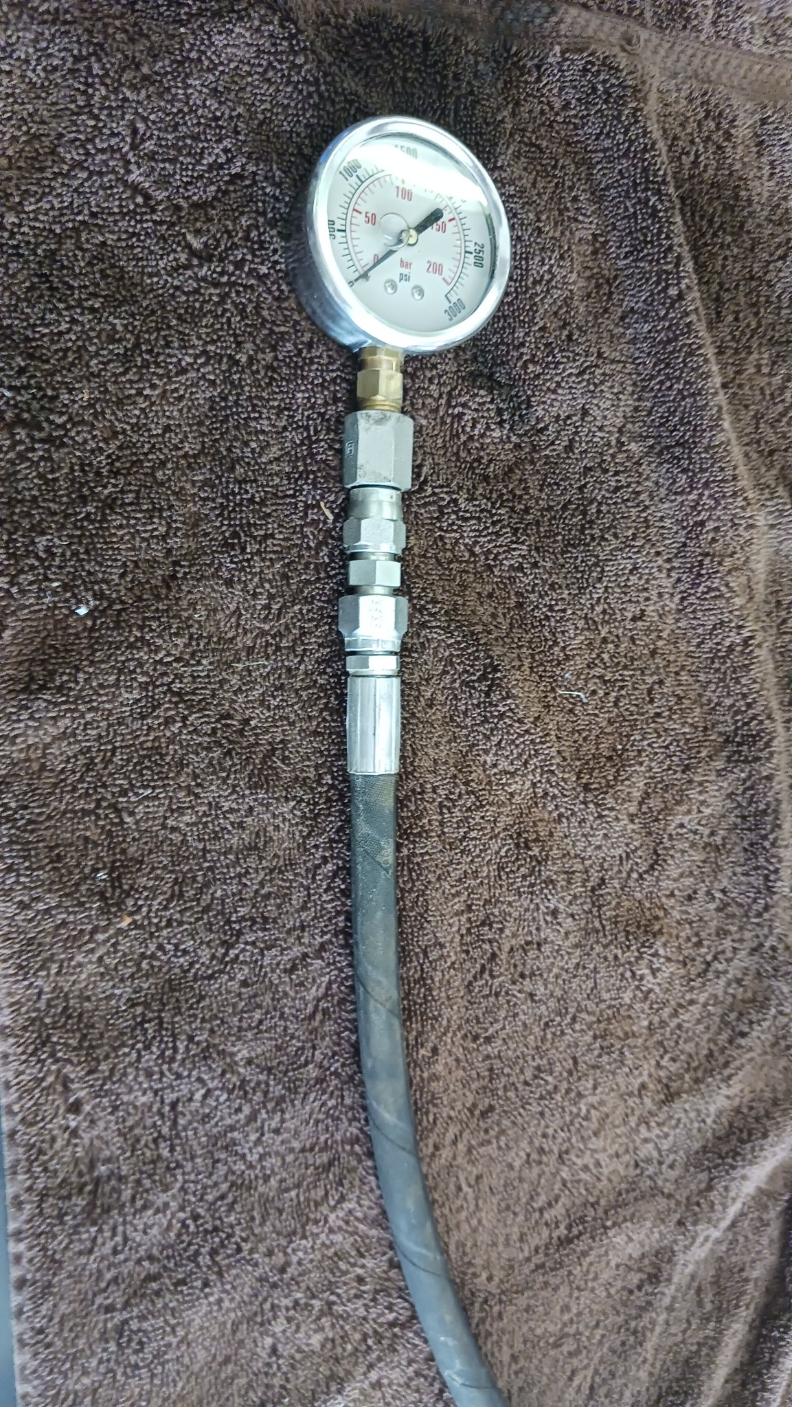

Do you hsve the gauge screwed directly on to the end of the pressure supply hose? Post a picture showing how you have it hooked up. If you are measuring pump outlet pressure @ 800 PSI either that pump is toast or the system relief is malfunctioning.
I have since removed it, but this s where I had it attached.
6,969
3,358
If you had that hose screwed onto the stem of the gauge your pump pressure is way low. Really only two possibilities:
  1. The pump is worn out
  2. The pressure relief valve on the top of the pump is malfunctioning
Given that pressure drops when tje oil gets hotter maked 1 far more likely.

I just want to ne sure you got the ptessure test right. The gauge needs to be screwed directly onto the end of the pump supply hose as shown in this picture.
Yes
