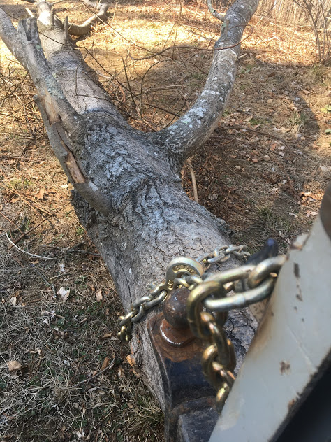

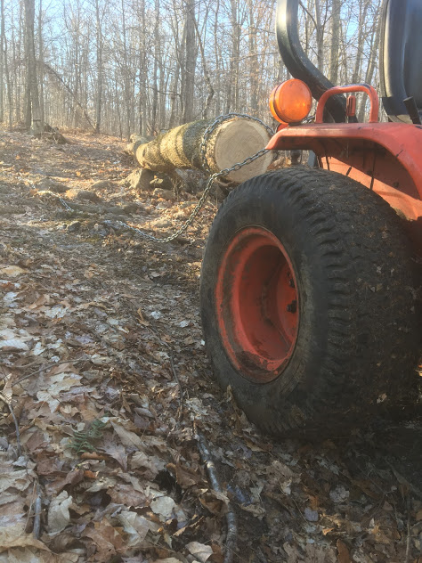

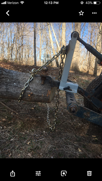

For about 12 years I would choke the log onto my bucket that had a hook welded on it. Talk about dangerous. Saw on another forum someone did this. Works greats. Back up to the log, put a chain underneath and lift up. I have a little Kubota B1550 and it works great. Don't know what size logs you are trying to get out of the bush but this may work for your needs. Good luck! Thought I had a pic but I guess not. Here are some pics of the baby B1550 moving some logs.
