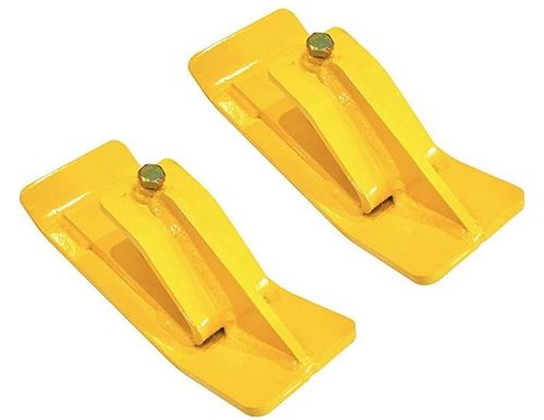

I can see how a pair of regular disc shoes would dig in to gravel.
I use a pair of these on my bucket, and they don't dig in. Work great. Might be something like this available for a blade.

Those seem pretty good for a bucket and something like that got a front mounted blade would be great. For a rear blade the solution is free: just reverse the moldboard.

I bought these. They were cheap enough that I don't mind spending $15.50 for the experiment. I have them mounted but have not had an opportunity to try them out yet.
Those look like they will bend quite easily. The ones on the Kubota plows are 5/8" solid steel uprights and each one weighs about 8-10 pounds. Heavy washers are how you set the height by sacking them on the shaft before inserting them into the holder on the plow and a linchpin at the top.

I don't think that they will bend too easily. I attached a picture of one side and how it is mounted. They fit close to the bucket in a position that allows me to have the piranha tooth bar mounted without interference. The tooth bar is not mounted in this picture. I think that they will allow me to be able to push snow without tearing up the driveway and grass. They are also tight enough to the bucket that they should not bend. Also, they should not interfere with any other work that I do with the bucket so I should be able to leave them mounted permanently.
As I said earlier, it is an experiment that is cheap to try. We have not had any snow yet so I have not had the chance to try them out.
