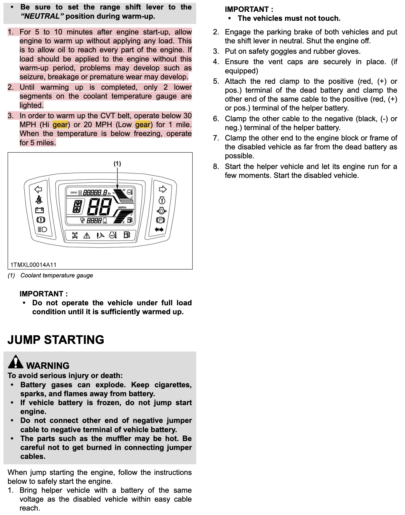

The dealer cited page 65 of the operator's manual with "extreme conditions". Everything is vague though. We originally went to the dealer to buy a machine and nothing was mentioned as part of the sale about short tripping and we certainly explained our intended usage.
I haven't seen any kubota or dealer videos on youtube advising not to idle these or short trip them. In fact, most of the videos are short trips! I feel like Kubota is just trying to pass the buck on a problem they know about.

Thanks for posting the page from the manual ! Buried in the 'range shift lever' section.. wonder how many pages into the manual is is ? I'd expect the info to be in chapter 1, how to start section.
