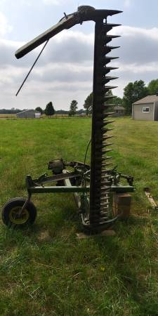

Something like this:
But for your price point, you would have to buy used and maybe a different brand.

Maybe something like this only hitch it to the FEL.
