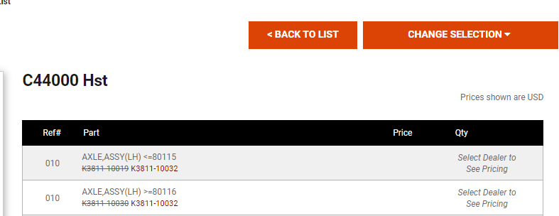

Thanks for all the input guys. I just got word that the dealer has a new transaxle arriving from Kubota this Monday, and the dealer will install and deliver the mower back to me. I asked what the part # is, he said K3811-10032. Interesting. The original P/N was K3811-10030 and both times the transaxle was replaced previously was with K3811-10030. As I mentioned above, Messicks showed that K3811-10030 was replaced with K3811-10032. But Kubota still showed K3811-10030 on their parts drawing.
After Lugbolt said that Z7XX uses Parker transmissions, I got to thinking, and here's my theory:
Parker realized there was an issue with K3811-10030 and fixed the issue resulting in K3811-10032 being the replacement. This was made available by Parker, but Kubota either had an existing stock of K3811-10030 they had to burn through, or had to go through their own red tape to implement K3811-10032 so there was a delay in sending the updated P/N to dealers. Maybe Kubota had hopes that the issue wasn't 100% of the units and that by continuing to replace problem mowers with K3811-10030 that a good unit would show up. Guess what - now the Kubota drawing shows K3811-10032:
So at least now I have hope that the issue will be fixed, I will see probably in about a month after several mows if the mower is still running well. If not, well then I've got a lot of great advice from you guys, so thanks! I'll start with checking tire slip and belt issues as you guys mentioned.
The crappy part is that I've had to pay for someone to mow my lawn many times the past 2 years while my new mower was in the shop. Also really tarnished my opinion of Kubota overall - I still can't believe there's no support if you call Kubota corporate. But if this fix sticks, I can move on. Cheers!
the change in part number could be anything, it may be that they changed a sticker on the transmission, the color it's painted, the casting, the vendor that Kubota buys it from, or maybe it's a redesign internally? Who knows? Kubota is a huge global company and when they realize there's a problem, there is a specific route to take to fix that problem-and it takes forever. Just like government, as it gets larger, the "fixes" become more drawn out. Normal, and what I call "par for the course". The downside to a company getting "that" big.
as said there were a few issues with the early Z7xx transmissions from Parker. Parker never would tell us what was wrong, neither would Kubota. When I replaced a bad one, they'd have me take it apart and take pictures. THen they'd send us a new Parker HST, we install it, bleed/test and send it to the customer.

Hi, just wanted to provide an update on my mower. The issue did come back in full force this Spring, still left side and now I realize it only appears after I run the mower for a while (maybe 30 min or more). So something with things heating up. Also happens both with PTO on and off. I tried some of the suggestions from earlier in this thread, marking the tires/rim as well as checking the PTO disengage levers, neither were the issue. I started to think that the suggestion on this thread about hairline crack in one of the HST pulleys was a real possibility.
But long story short... Mower is now back in the shop as of last week and dealer has let me know that there is a known issue with the HST belt being too slack under certain operating conditions. Kubota has released an update kit which includes a bracket to support the pulley's tension under any conditions. This makes a whole lotta sense with how the left side was shuddering.
As frustrating and as long a journey as it has been (mower is coming up on 3 years old and this issue started after just a few hours) - I am happy that it sounds like there's a true root cause and fingers crossed that this is it. My biggest takeaways: 1: The dealer has been super supportive and responsive, very transparent with me, aside from lack of updates without nagging them and my tractor sitting in the shop for long periods of time (but I get that they have real tractors/farmers who take priority). 2: Kubota corporate sucks, not transparent at all, didn't reply to my mailed letter, impossible to get any answers other than "call your dealer" and "there's nothing we can do"... I felt completely unsupported and lost a lot of faith in the brand.
Hopefully if anyone else is having the same issue they can ask their dealer about this update kit and avoid what I went through.
I want to thank everyone on this thread - it was super helpful to hear all of the strategies, what a great community. Also interested in any thoughts from you guys on the "update kit". I will post again when I get the mower back and after a few mows.
that issue was originally addressed by putting a different tensioner spring on. I advised them that it wasn't the proper fix but apparently their enginerds are better than us grease monkeys in the field who actually see those things on a daily basis. These are pretty neat mowers, would be great if they can get the HST issue figured out.
