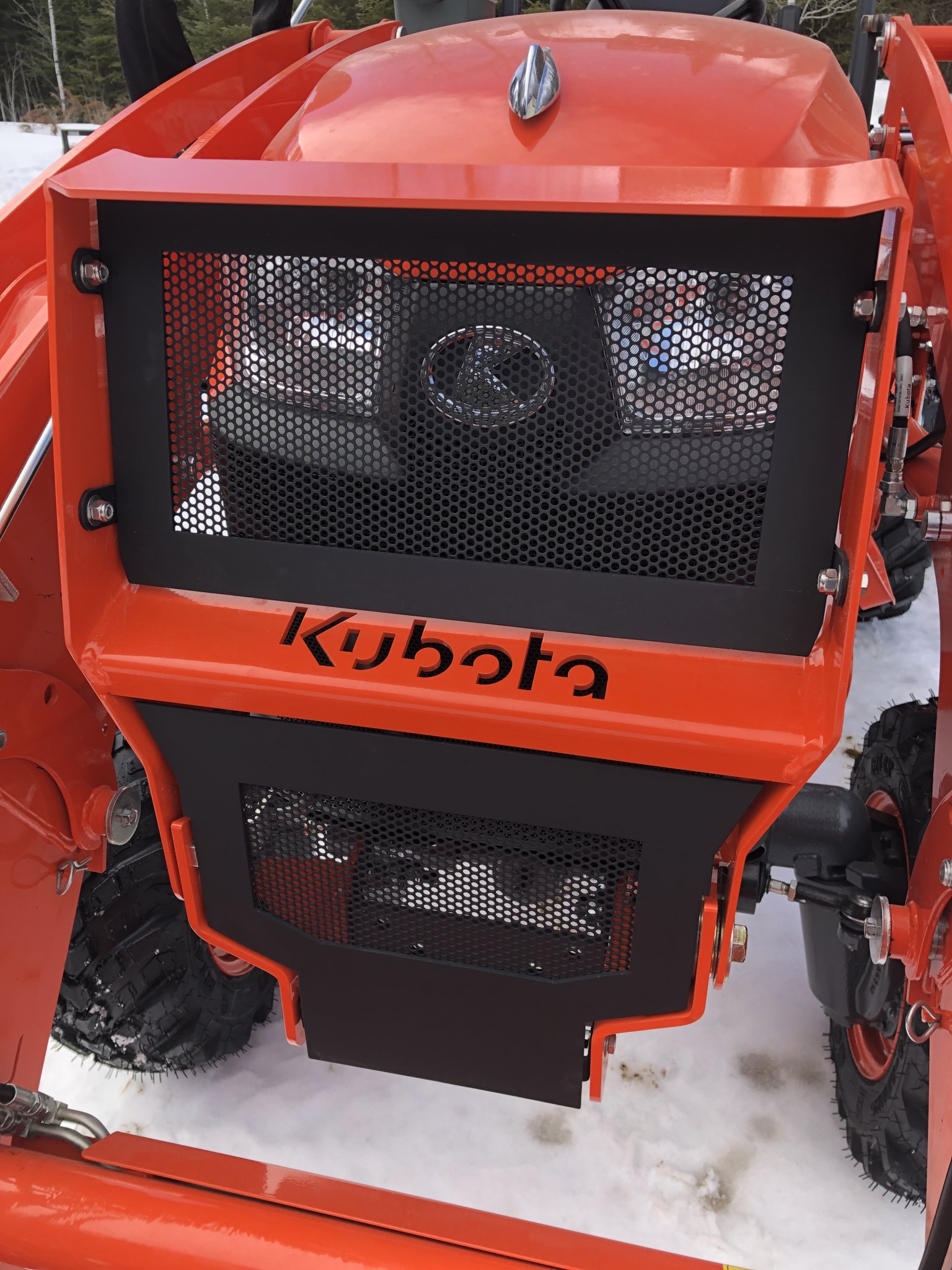

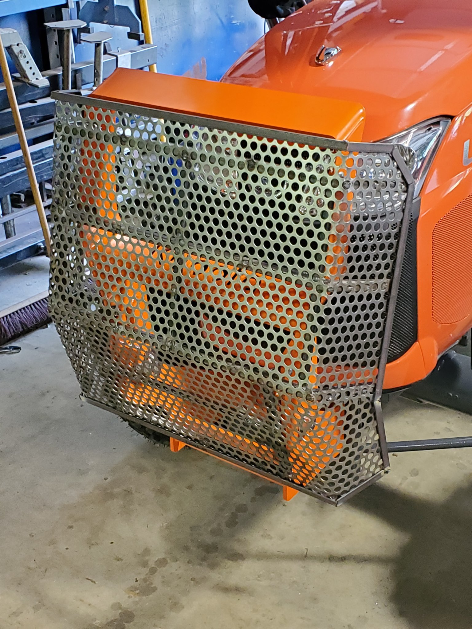

Looks like it's been doing it's job! Nice work.
I like the way yours "tucks in" at the bottom.
Well done! (y)

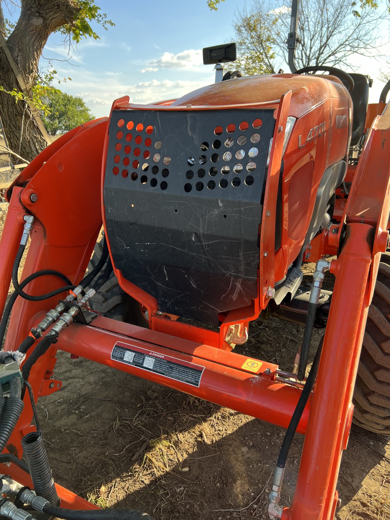

Thanks. I wanted something smooth that would allow the sticks & debris to slide away. The scratches show that is working. There was some concern about airflow & overheating, but no issues thru the last 2 summers. The guard sits 6” in front of the cowling. The radiator is 12” behind the cowling with a direct drive fan (OEM). I have found that seeds & other floaters tend to drift around the guard away from the cowling. I don’t get as much sucked into the screen in front of the radiator. The breaks in the metal give it some rigidity. The guard is scratched, but straight & true.

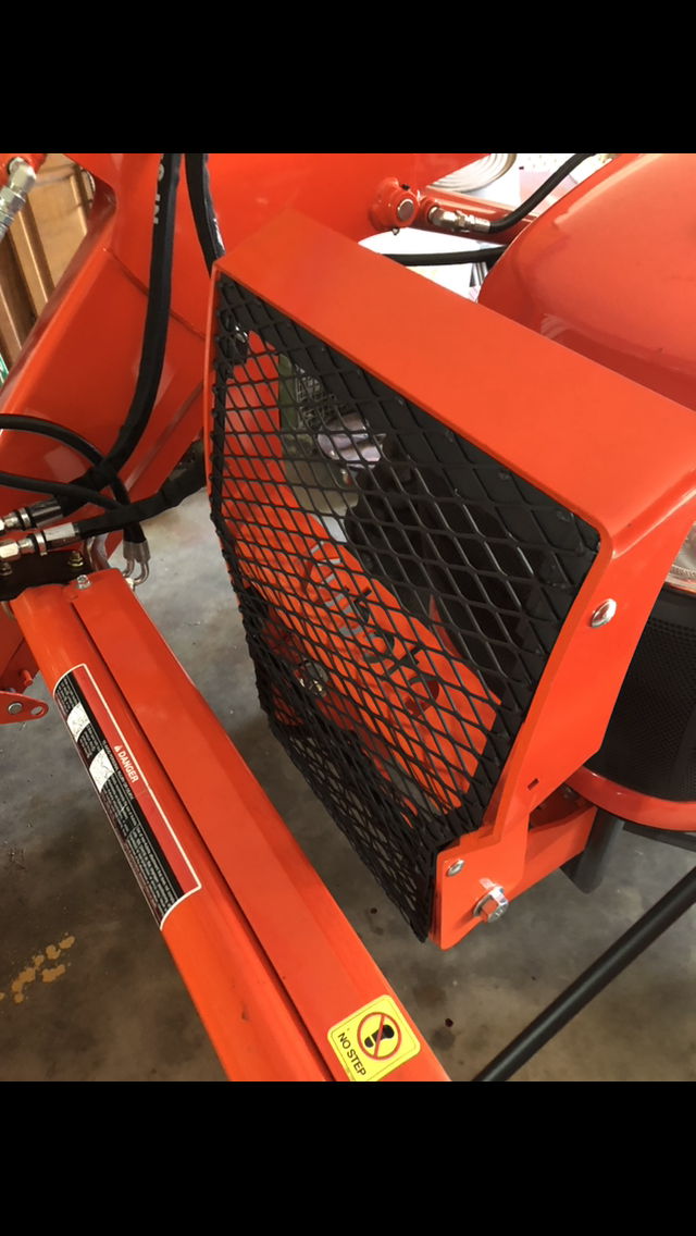

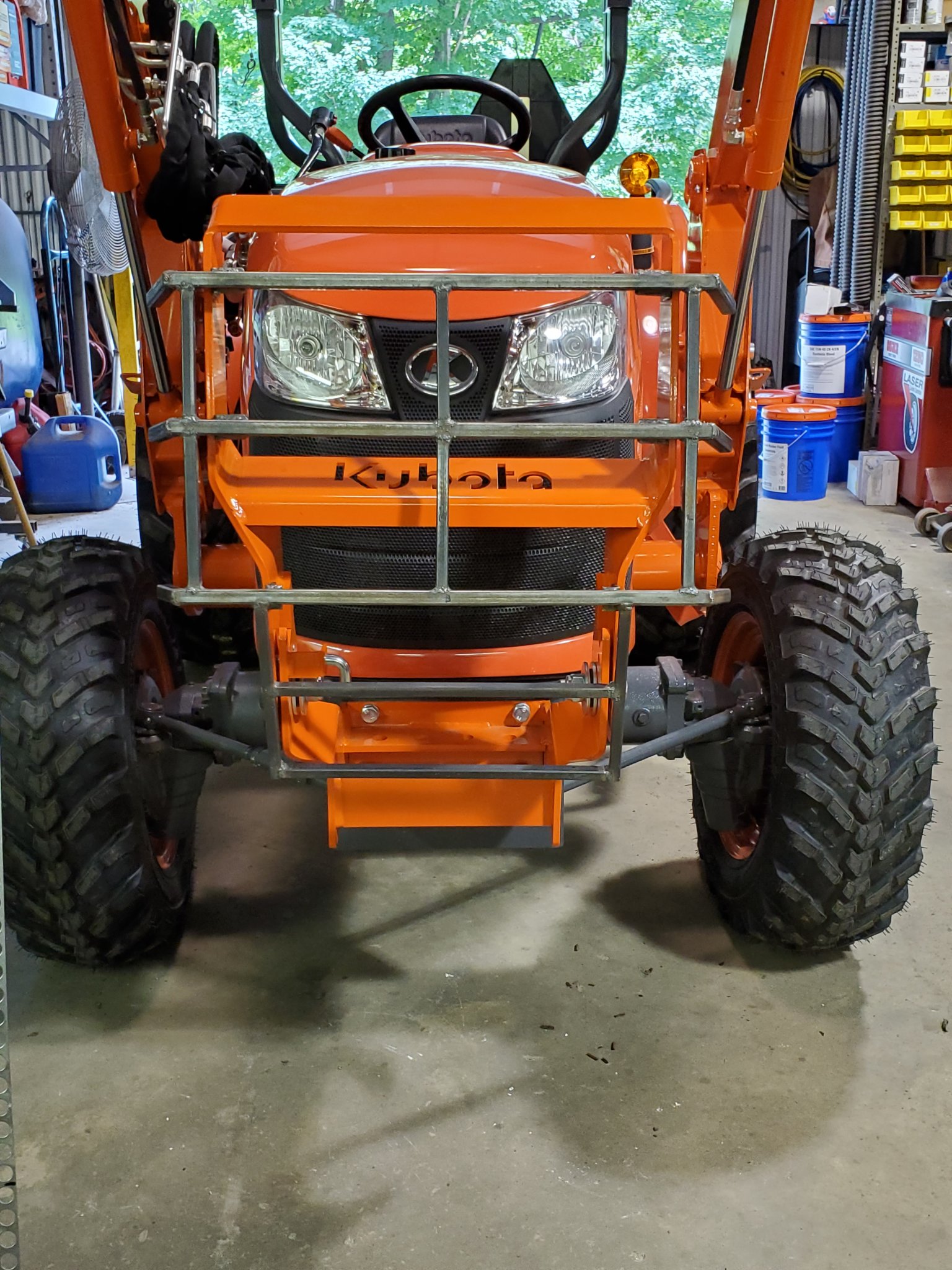

This is what I made a little less than a year ago for my new LX2610.

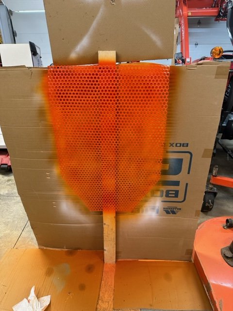

I priced them and decided to make my own. About $90 all in with paint and heavy duty zip ties (I don't know how to weld). Not beautiful but works well. Paint is a good match, more or less.
14,378
6,643
Looks like it will do the job. I'd suggest putting a piece of angle iron at the top behind your punch plate going side to side to give the top strength. A limb could hit the guard near the top center and crush it pretty good. Might use a piece of inch and a half x inch and a half angle. Since you can't weld use rivets.

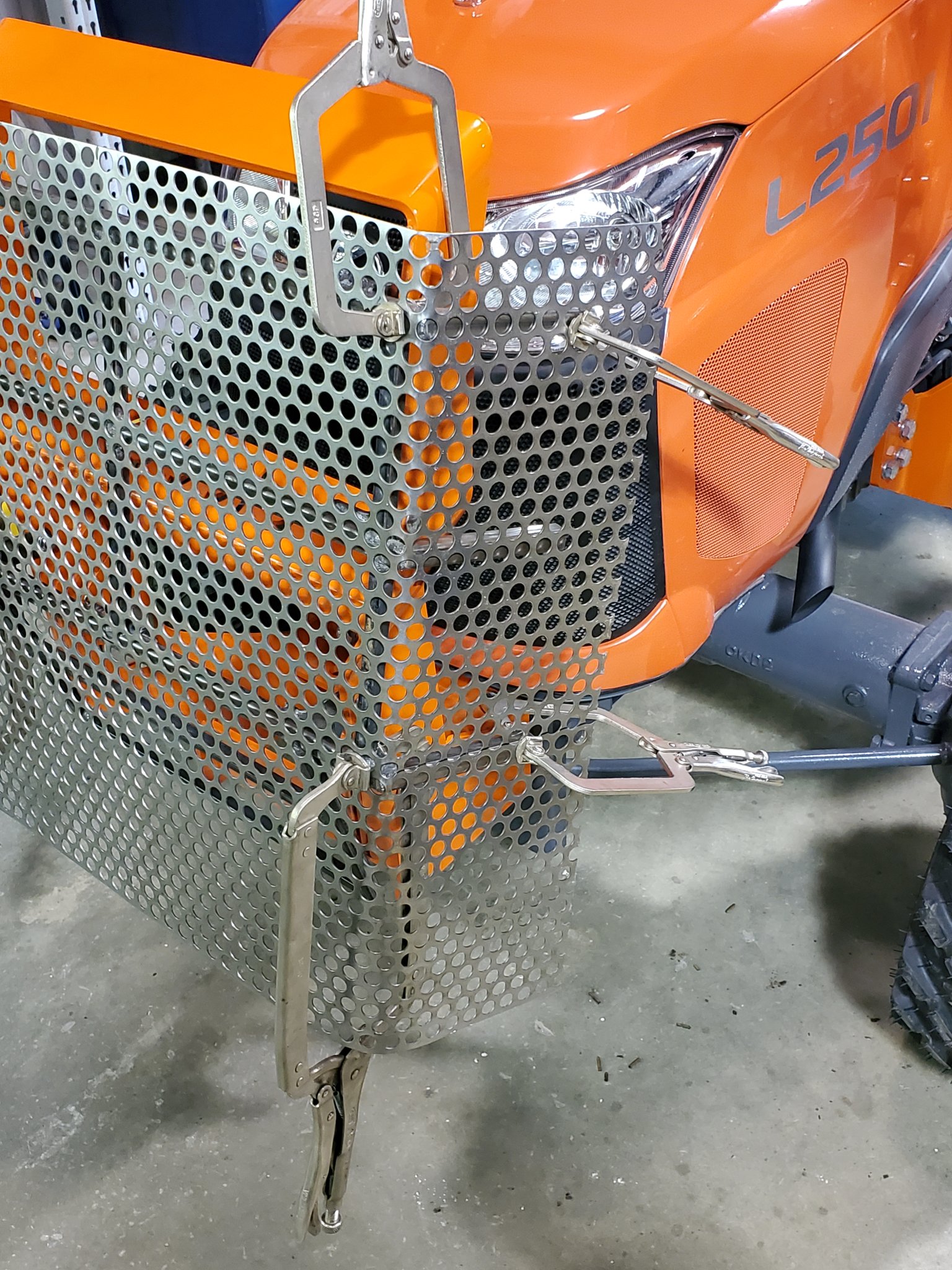

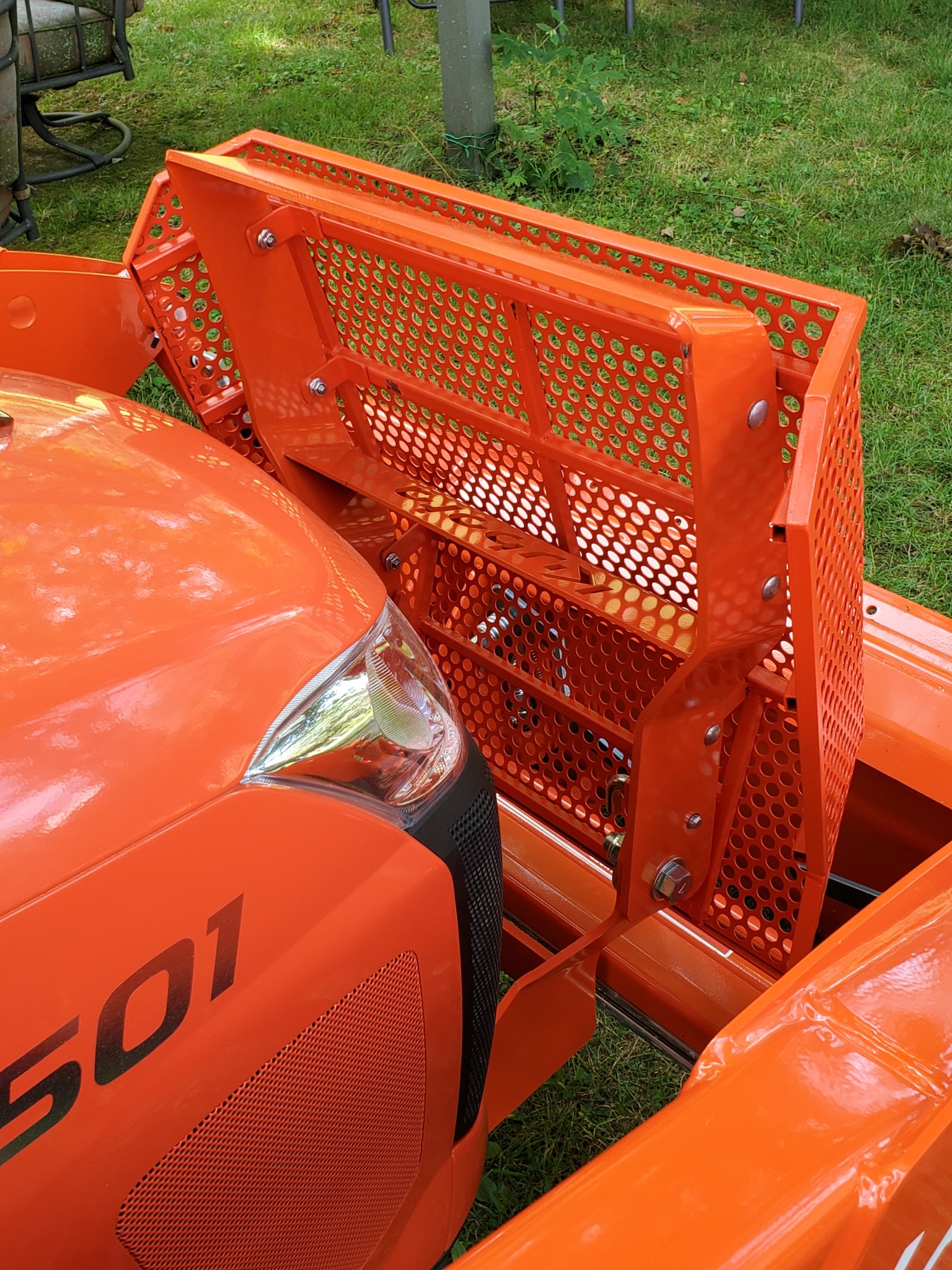

The first thing I did when I got my L2501 was fab a grill guard.
A quick wash before painting...........
And Bob's yer uncle...........

By far the coolest and most innovative brush guard I've seen on this forum. I'll be making something this year for my two tractors.
Thanks! A lot of thought and effort went into making it but it turned out well. No damage to my grill after a year extensive grapple work.

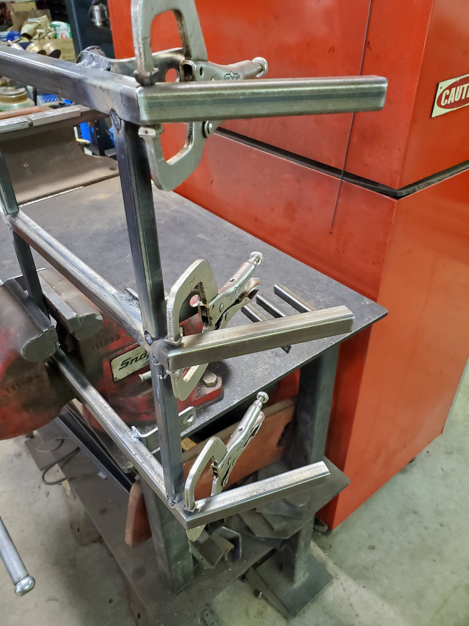

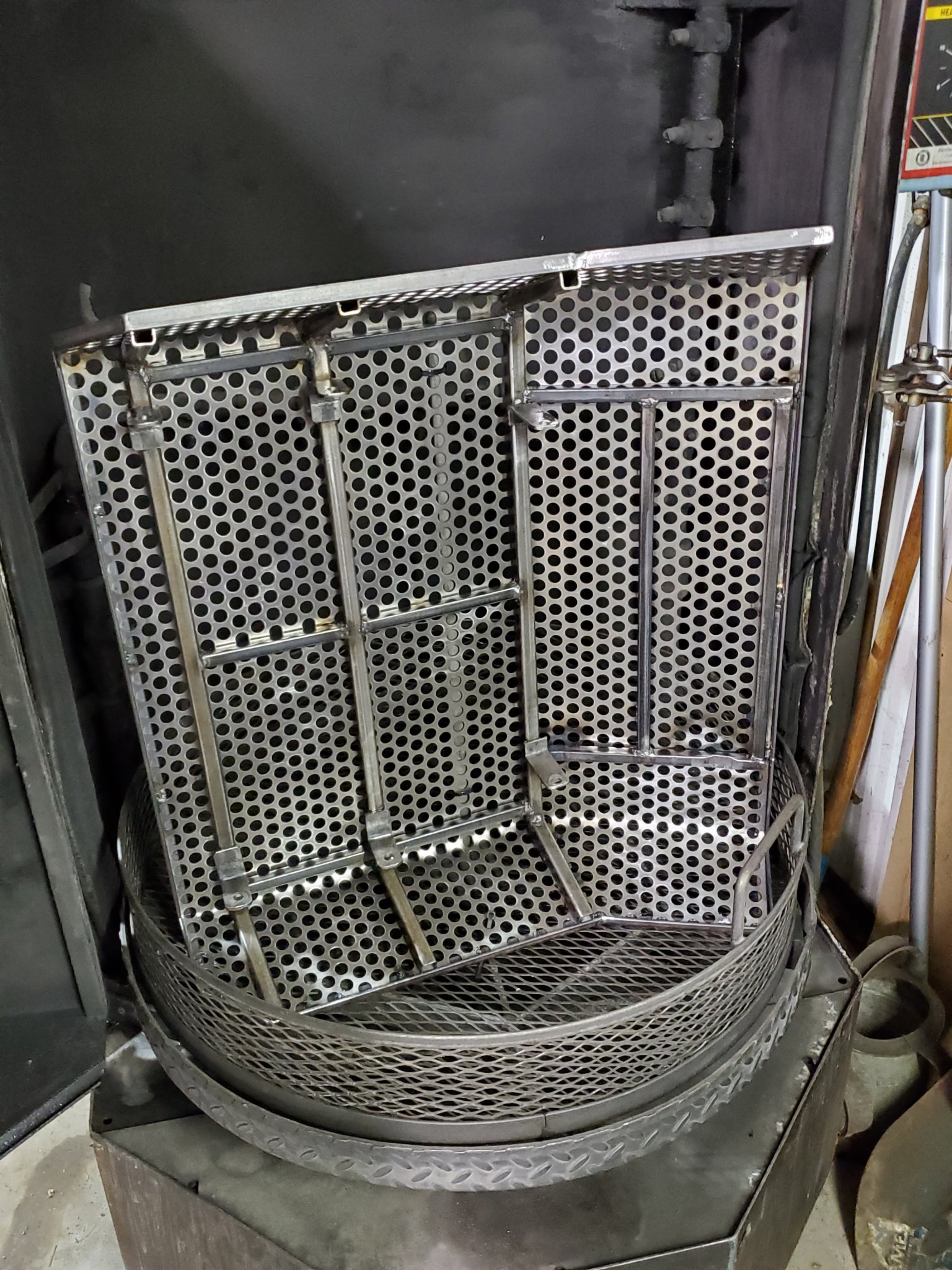

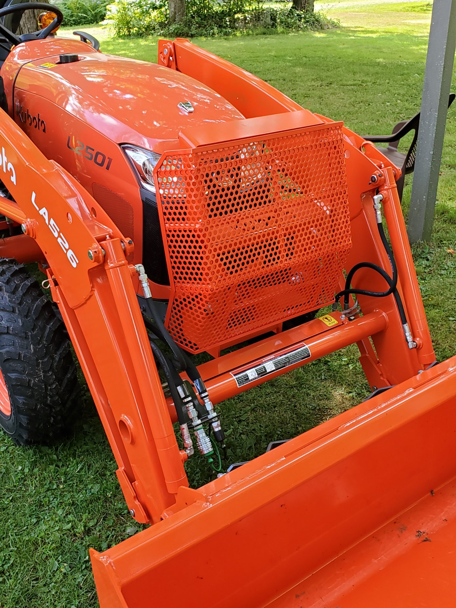

Some more in the fabrication process:
MountainMeadows
Jun 6, 2022
219
289
Poconos, PA
Does your metal supplier stock that material(what's it called)? Did you bend it by hand or with a brake? Looks great, that compound bend looks get.
I ordered the 24" x 36" perforated sheeting from onlinemetals.com
I clamped it down, bent it by hand, and tacked it in place.

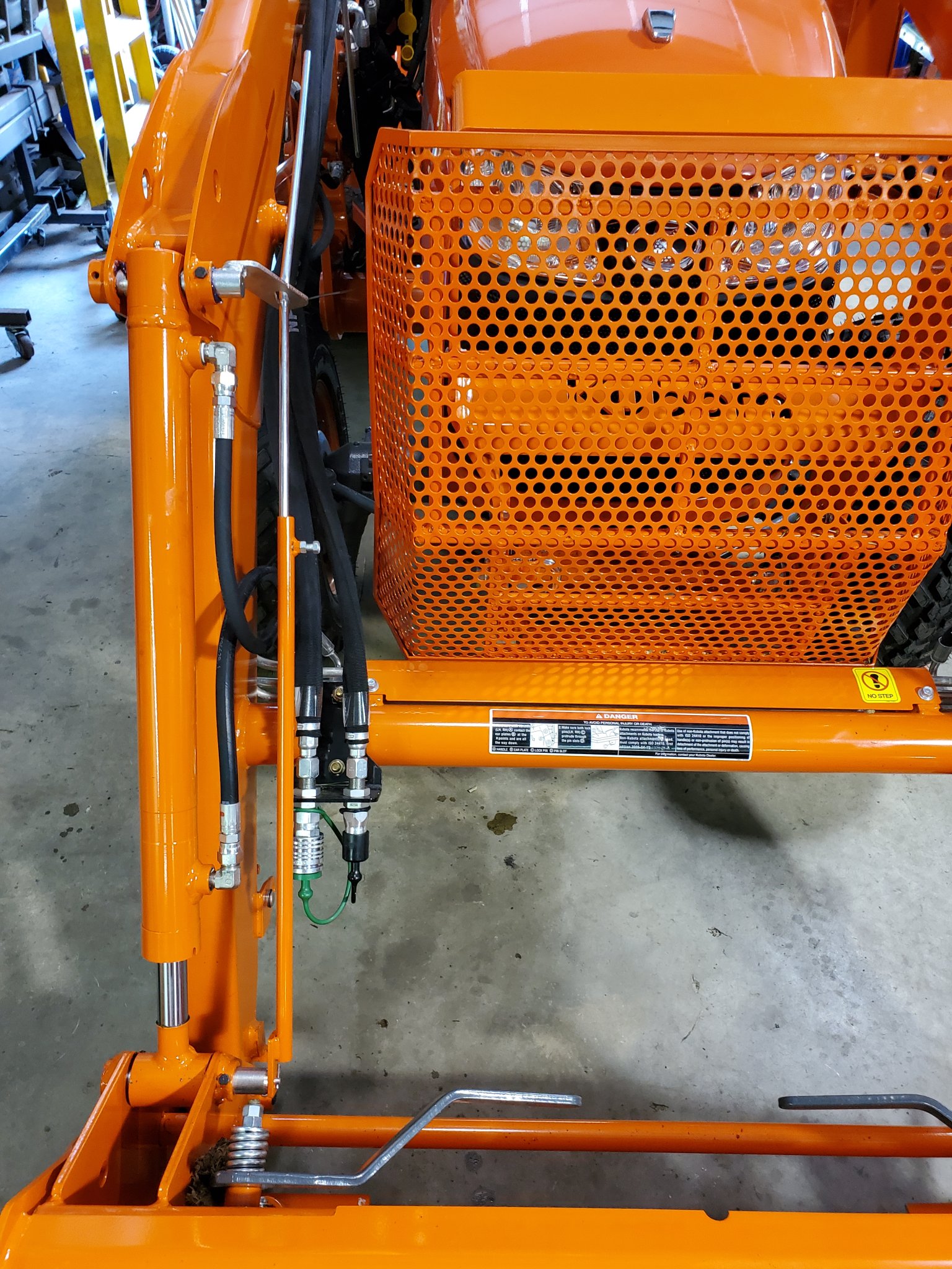

2001TLB
L48TLB, 60" EA SSQA Root Rake Grapple, EA SSQA Fork lift
Nov 14, 2021
64
54
Shelton, Washington
The L48 comes from the factory with a pretty heavy duty guard. Picture was taken to display the loader cylinder supports, but shows the radiator protection pretty well. It is a pretty heavy duty set up.
