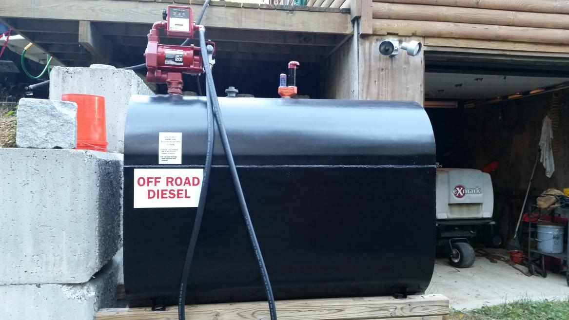

This came out nice but if I did it again I would get a slower pump. At 20 gpm it only takes 30 seconds to fill the 4630 or the kx121 and 15 seconds to fill a 5 gal jug - don't look away while filling!
I have a 15 PGM pump and it is almost to fast when I fill my L3901DT with its 11 gallon tank. Takes longer to plug the pump in, zero my meter and get the hose over to the tractor then it does to fill it up.

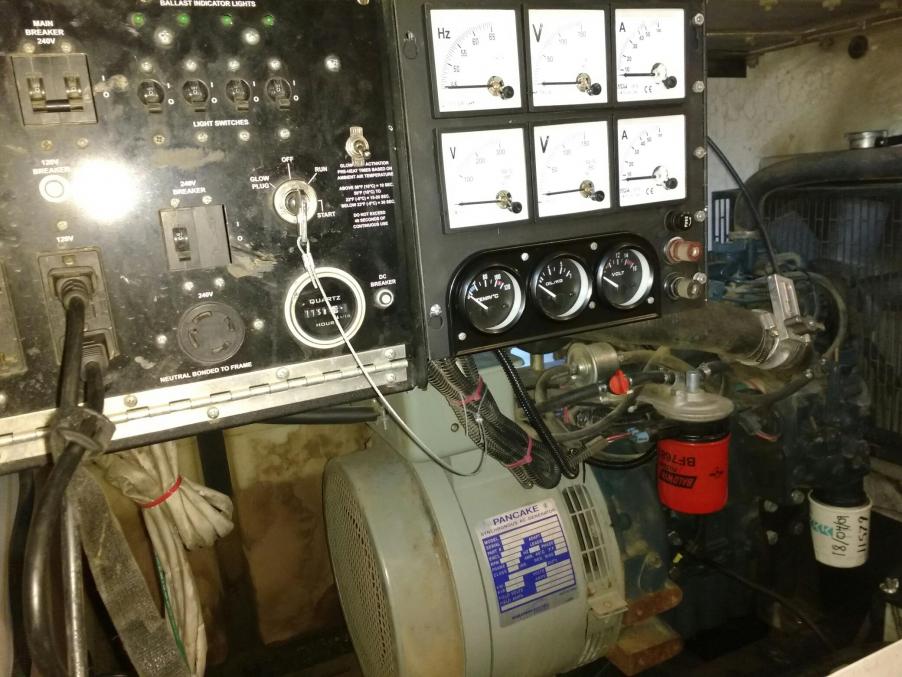

My fuel storage needs are small, since all that we run around here is a BX23. As well as needing fuel storage, a backup generator was also on the need to get list. This setup kills 2 birds with one stone, a used 8kw light tower, with a D1105 engine which coincidentally just happens to qualify as a replacement engine for the BX23.
I plumbed a second pickup fuel hose into the 40+ gallon tank (the jenny will run for 3 or 4 days on one tank), and hooked it up to a small electric fuel pump (2.2 gal/min) that runs off the light tower battery.
If more fuel is needed, just hook the trailer up to the truck and go and tank up at the nearest fuel depot. So far the setup works well.
