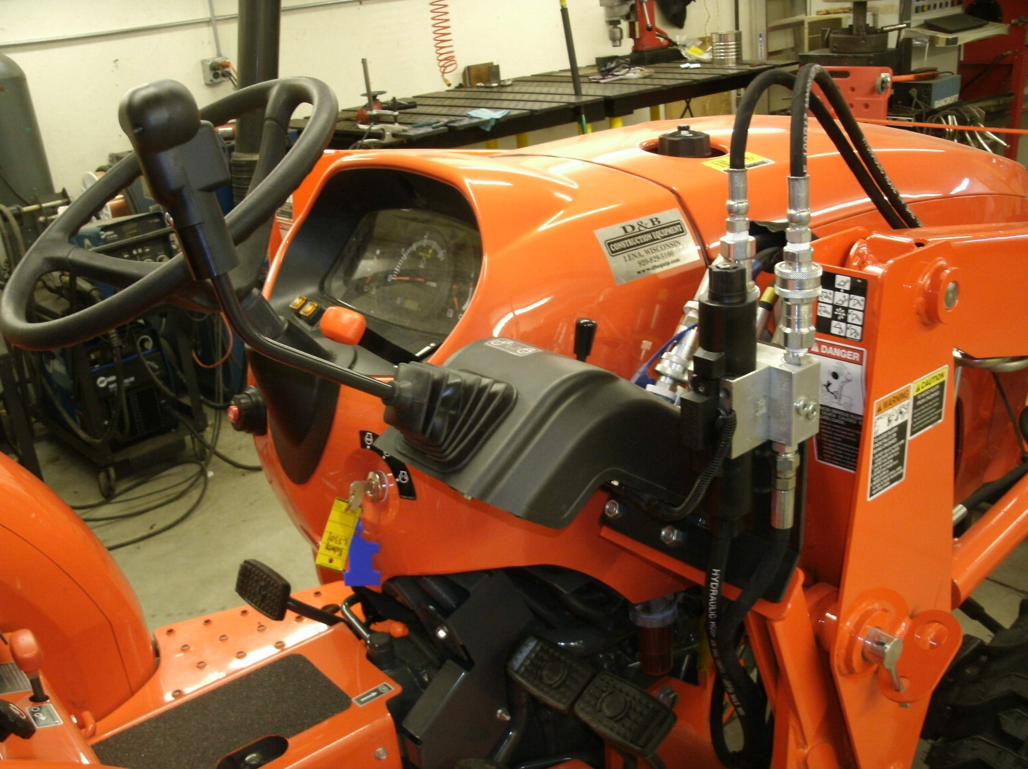

Has anyone shortened the throw on your joystick?
I find mine (L3901) to be like shifting a 60's VW bus. Inordinately long.
I'm not talking skidsteer short, just not so far as to throw out my shoulder......

One of first mods I did on my 3301 was cut 2" off that stick. I felt like it was pointing right in my face.
Did same to 3pt lever too. My knee kept hitting it.

I wish I could remember but it was either 6" or 8" that I cut off. Also the three point lever, I bent over to follow the contour of the fender. Allows me to exit to the right side (adding a step help with that).
The short handle does make it "touchy" and I can jerk the tractor around if I'm not careful. Figured if it didn't work, I could weld it back together....
Spot on....wish I had done this instead. When turning torso to right in order to look behind, 3pt lever is now just barely reachable. A future mod to correct a mod is in order.

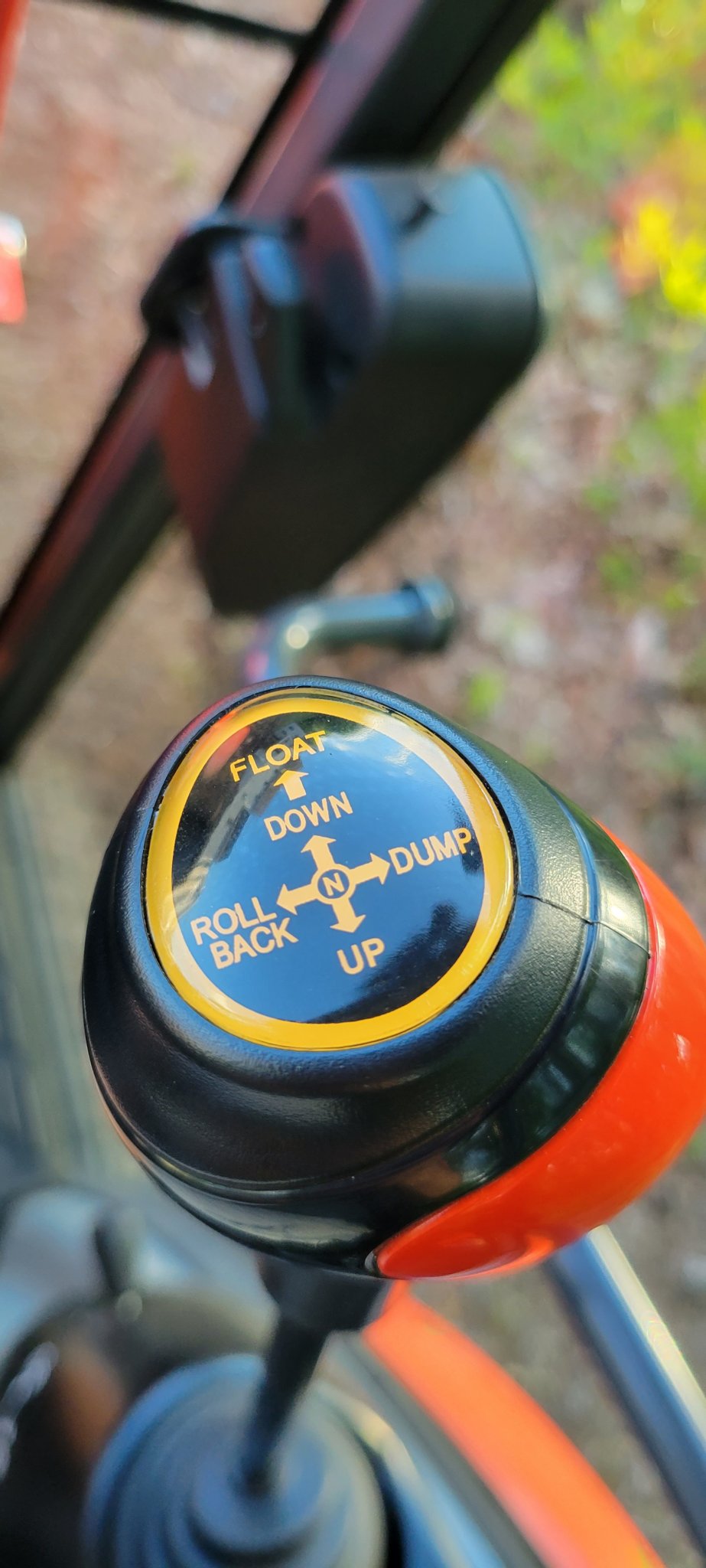

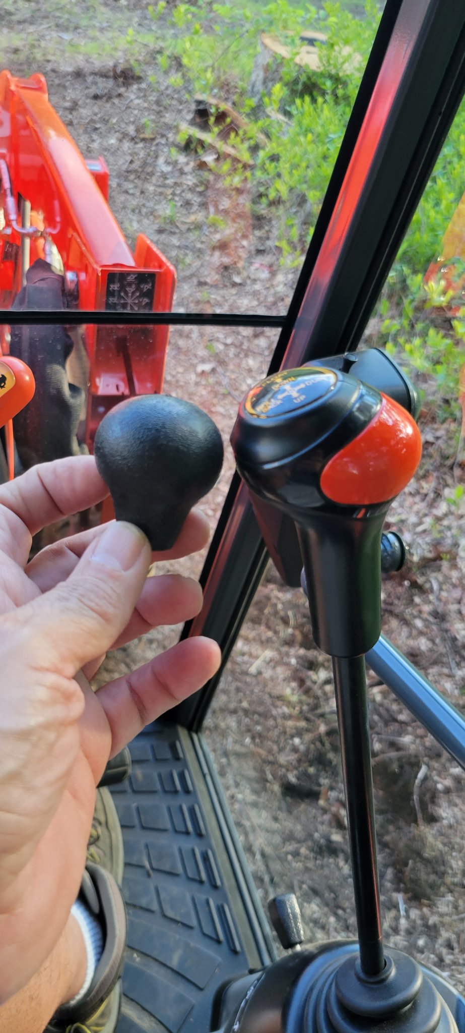

I removed the OEM knob with the air trick ( thanks to Orange Talks! ) When I was test driving tractors the Kioti knobs were very nice. The Kubota shaft (model LX2610) is 13mm, the Kioti inside diameter is 12mm. I used a drill and reemed the Kioti knob and forced it on. But as stated in this string - the lever is to long. I will likely be cutting the shaft down a couple of inches. If that makes the control less sloppy then even better. I can't believe Kubota uses that tiny cheap knob on an almost 30K tractor. Isn't the loader knob the most used feature in the cab? Whoever approved the knob choice at Kubota should be fired, rehired and fired again!

One of the best mods I did! I agree that the original just wasn't comfortable. Its been so long I can't remember how much I took off, but the bend makes a huge difference for me. I have a tubing bender so it was a piece of cake. I might have even replaced the whole joystick with a tube come to think of it. Posting this to help you with an option if nothing else.

Where did you get that knob? Can you tell me who makes it and if they have a website.
See post #11. The link provided by Jack@Northeast will take you to an ebay listing. I ordered one from there this weekend.
