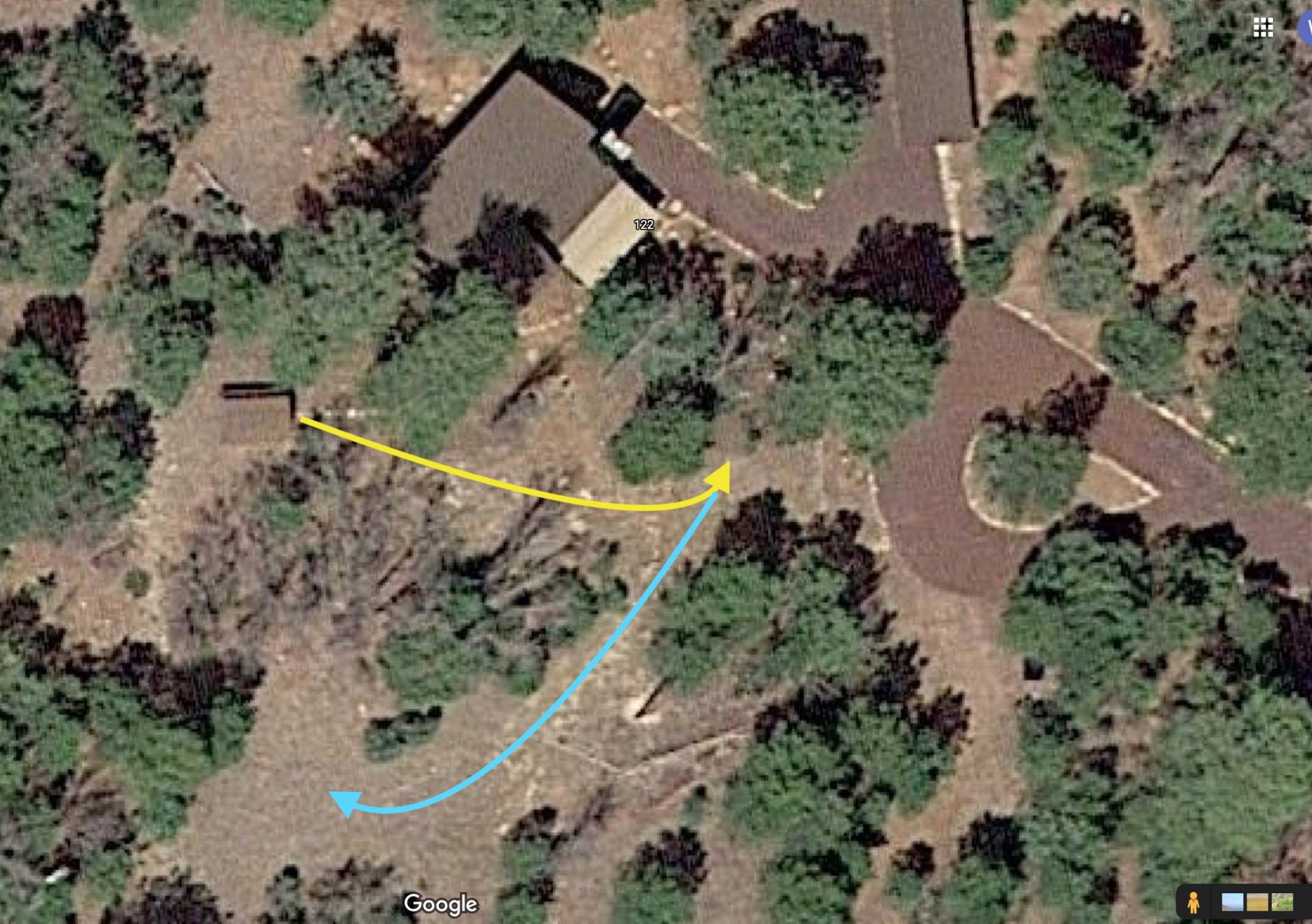

The wife & I moved a small shed from one location to another in order to have a larger one built in the original location. Small shed is 8' x 10' X 8', new one will be 12' x 16' x 12', same style, but with an 8' roll-up door.

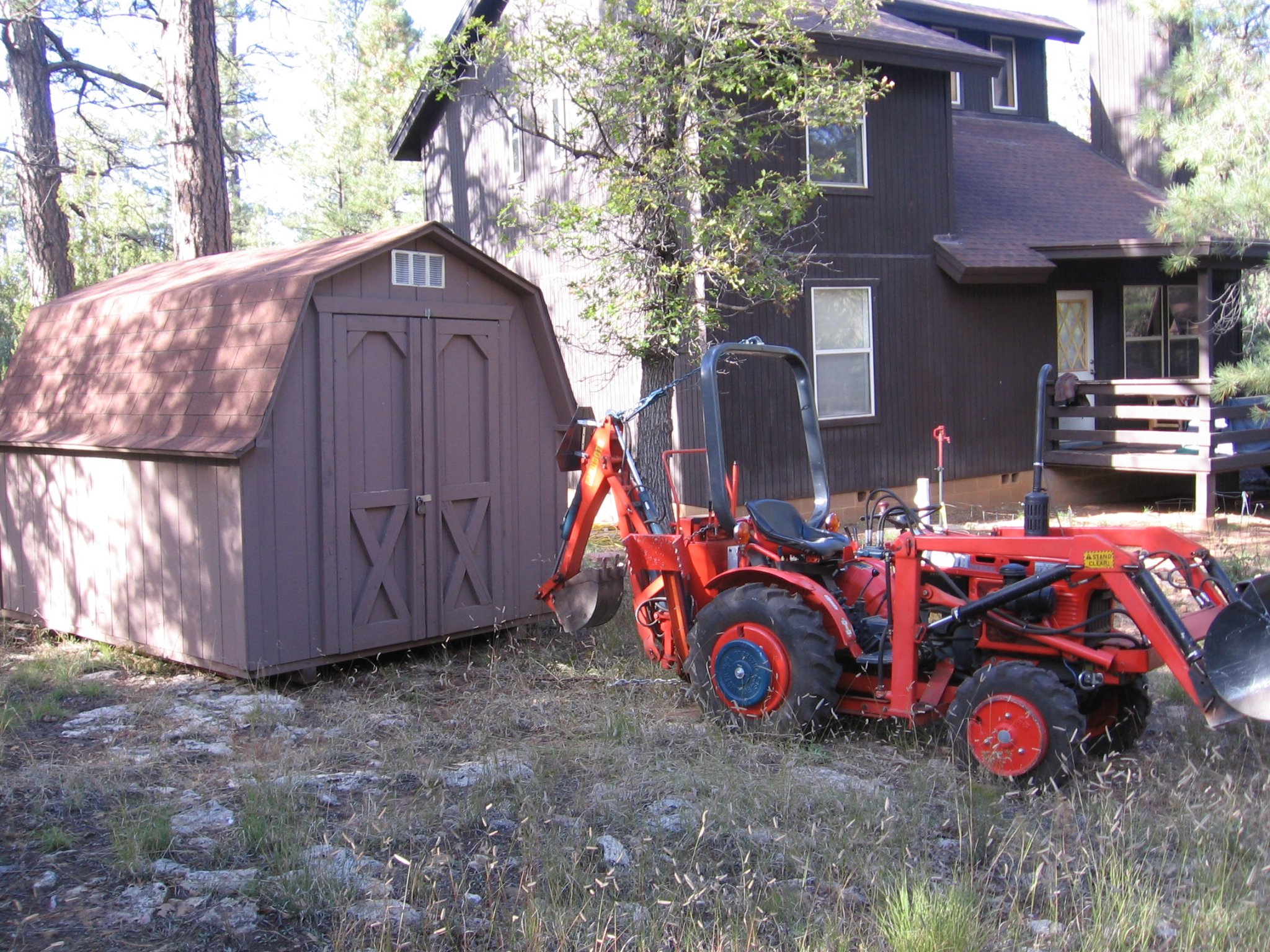

I took two 2x12s about 8' long, cut 45s on both ends, jacked up the building, screwed the 2x12 "skids" to the 4x4 treated lumber runners, and wrapped a tow strap around the building. Hooked a 3/8" log chain between the strap & the tractor, and proceeded to pull.
My B7100 pulled it with ease, 4wd, low range, 1st gear, at idle.
We had two difficult spots, the first was at the end of the first pull- when we made the slight turn, the strap & chain went under the skids, requiring us to use the tractor to pull it free. Not a big deal, because we had to re-rig the tow to pull in the opposite direction anyway.
The second was soon after that- we snagged on an immovable rock, and had to jack up the building again and place another 2x12 over that rock. Things went smoothly after that.

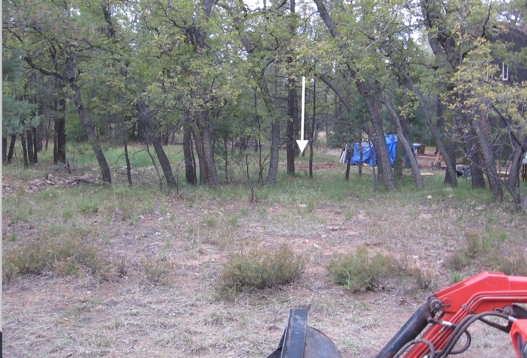

1st pic shows the move path; yellow arrow shows the path of the 1st move, (forward) blue arrow shows the second move. (backward)

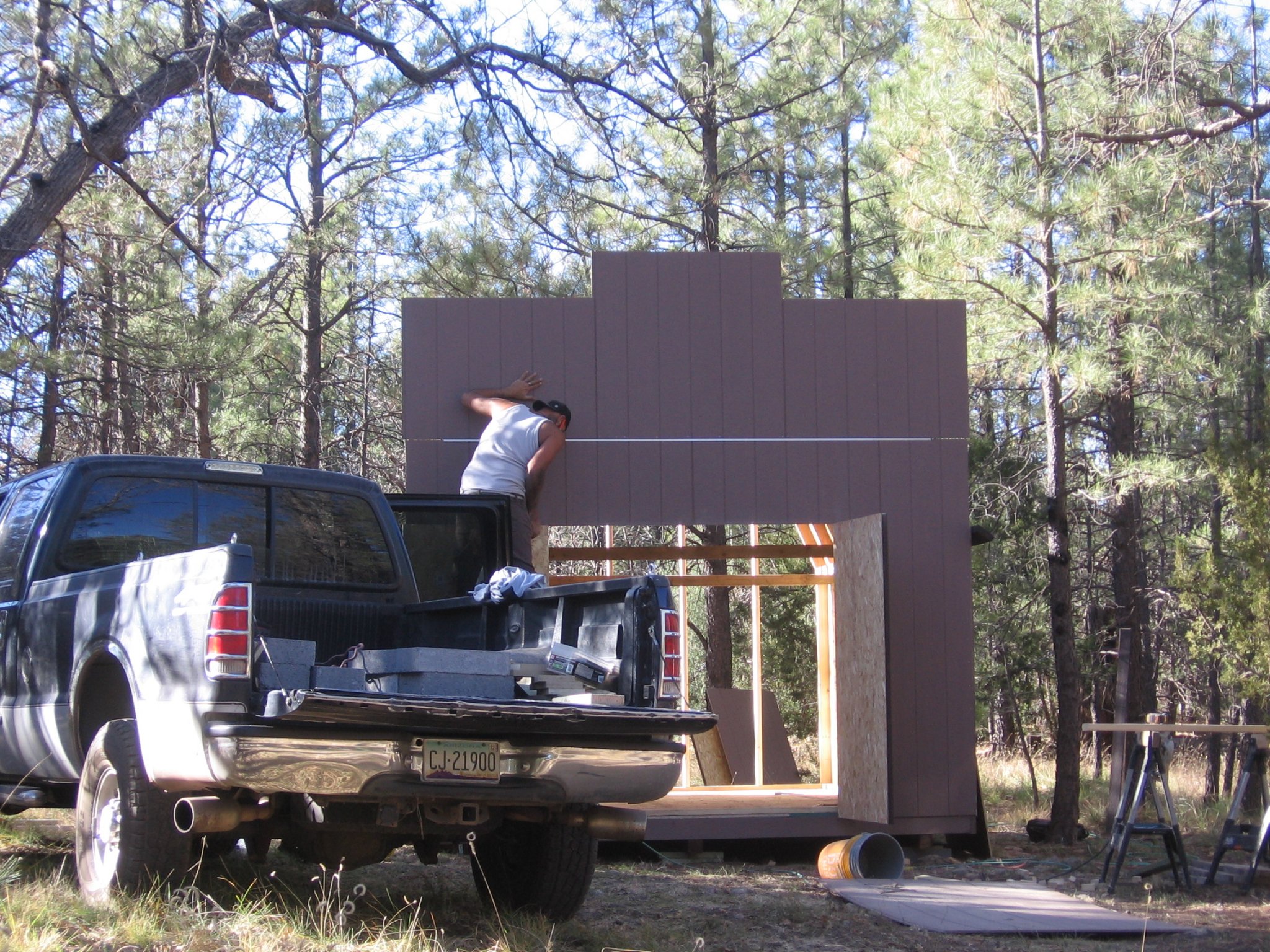

2nd pic shows the start of towing.

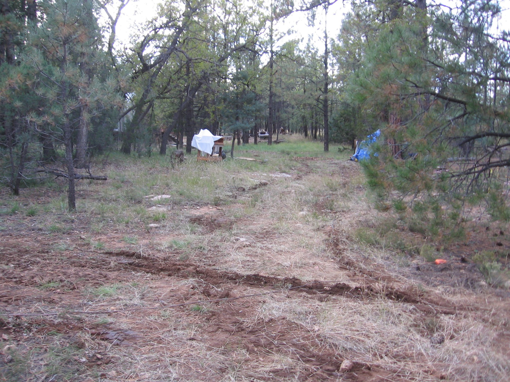

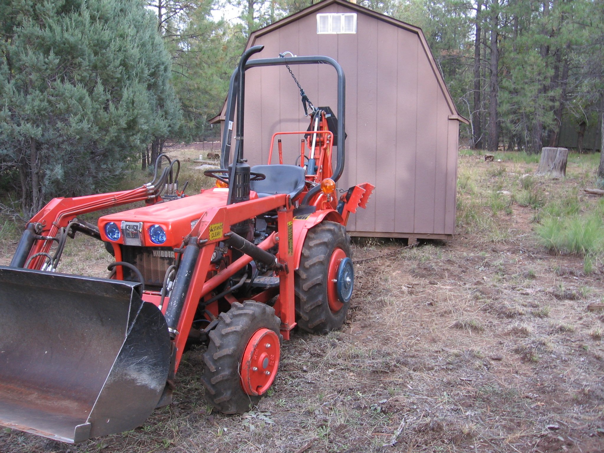

3rd shows the tracks left by the building.

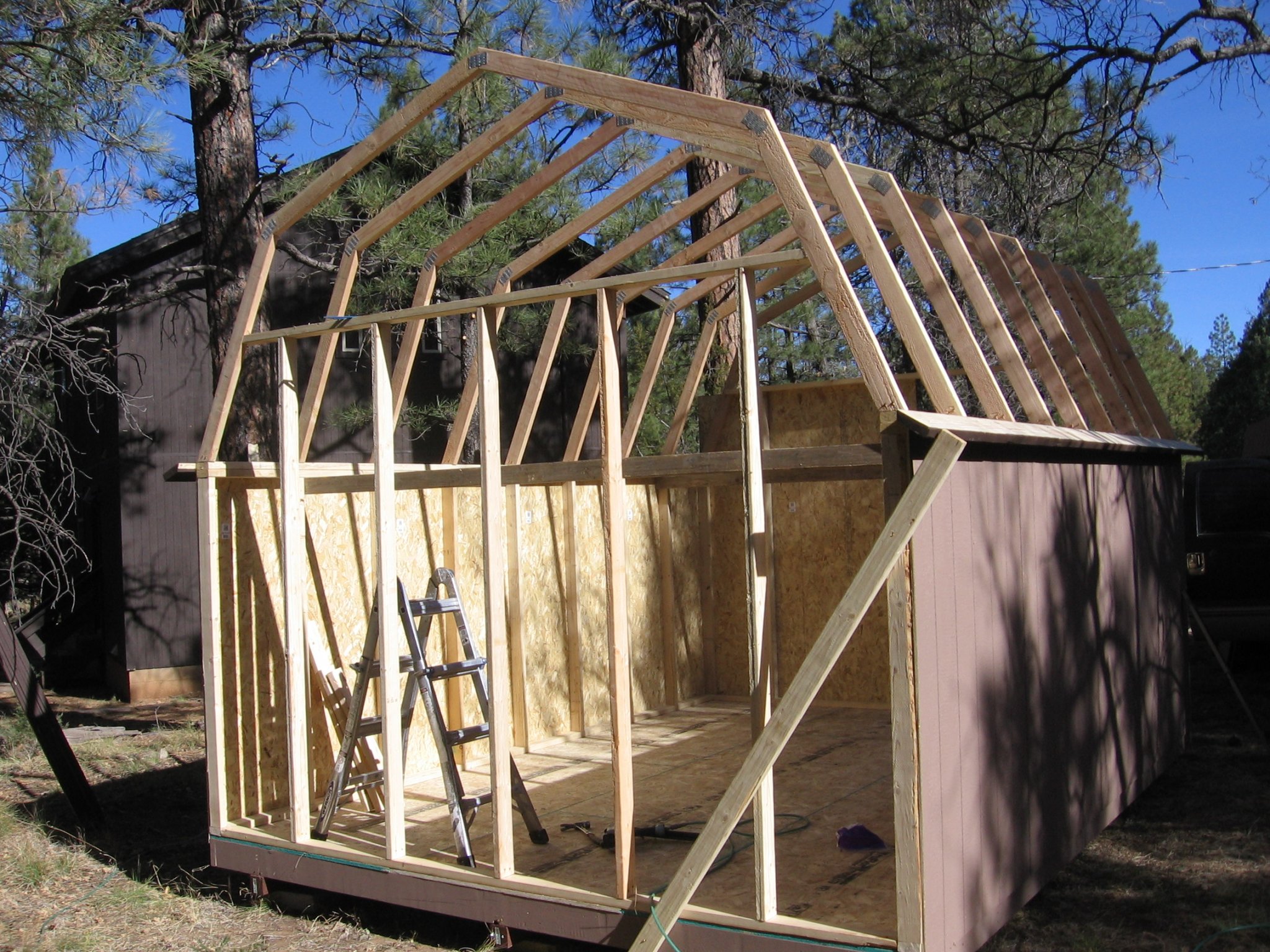

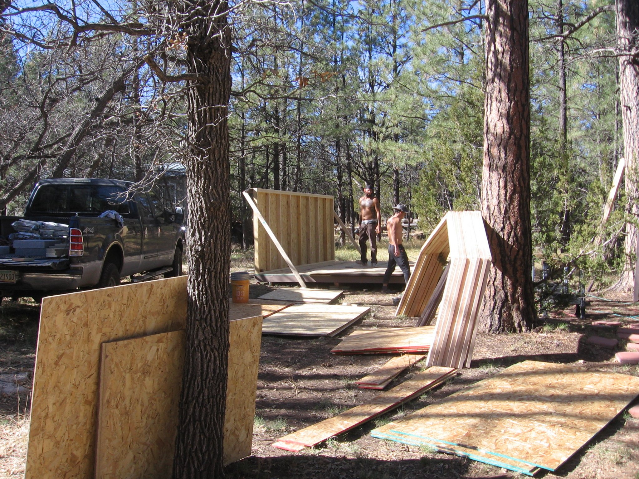

4th pic shows the old & new locations- white arrow is the old, and the new spot is just about where the FEL bucket is.

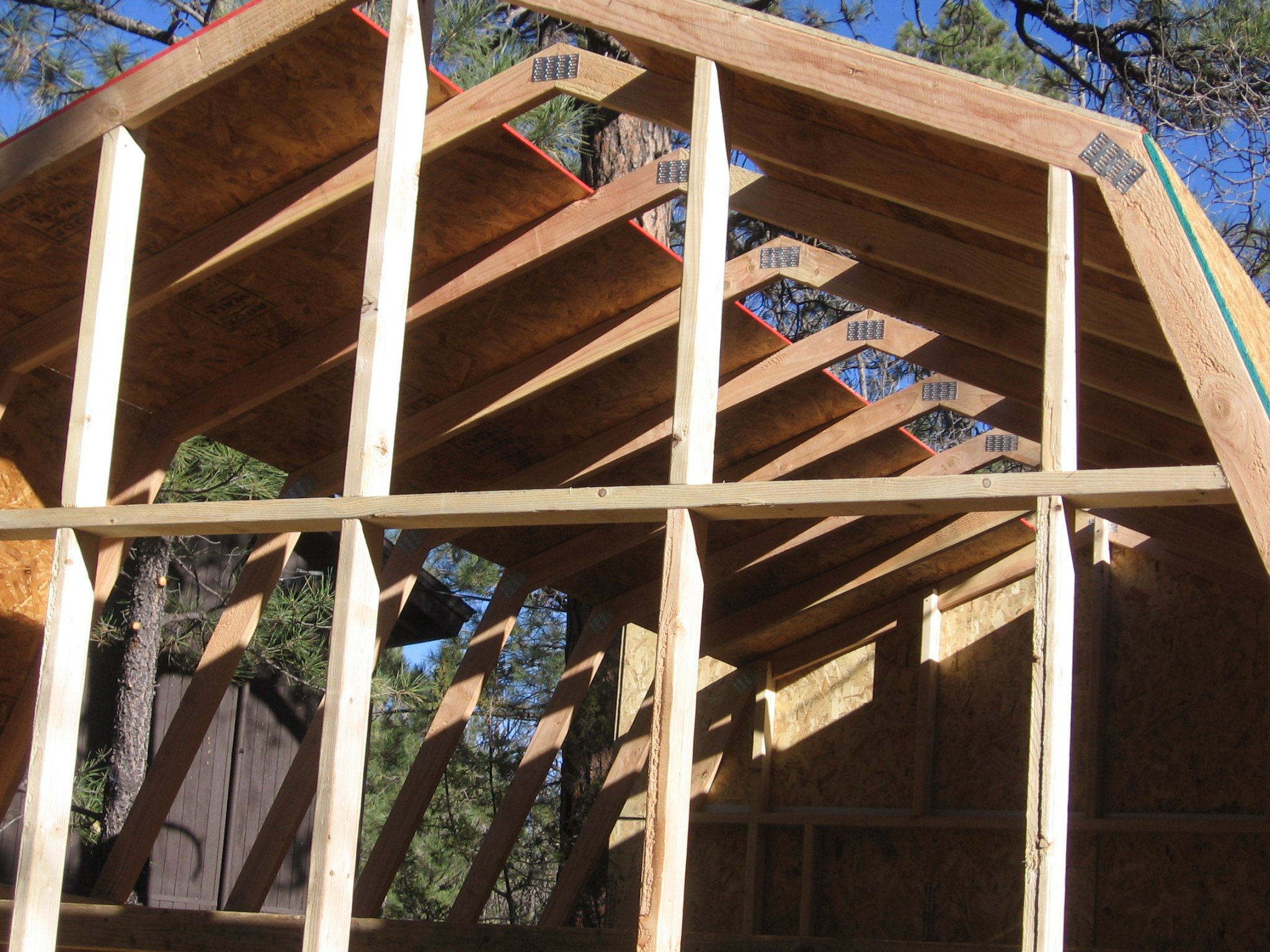

5th pic is approaching the new spot.

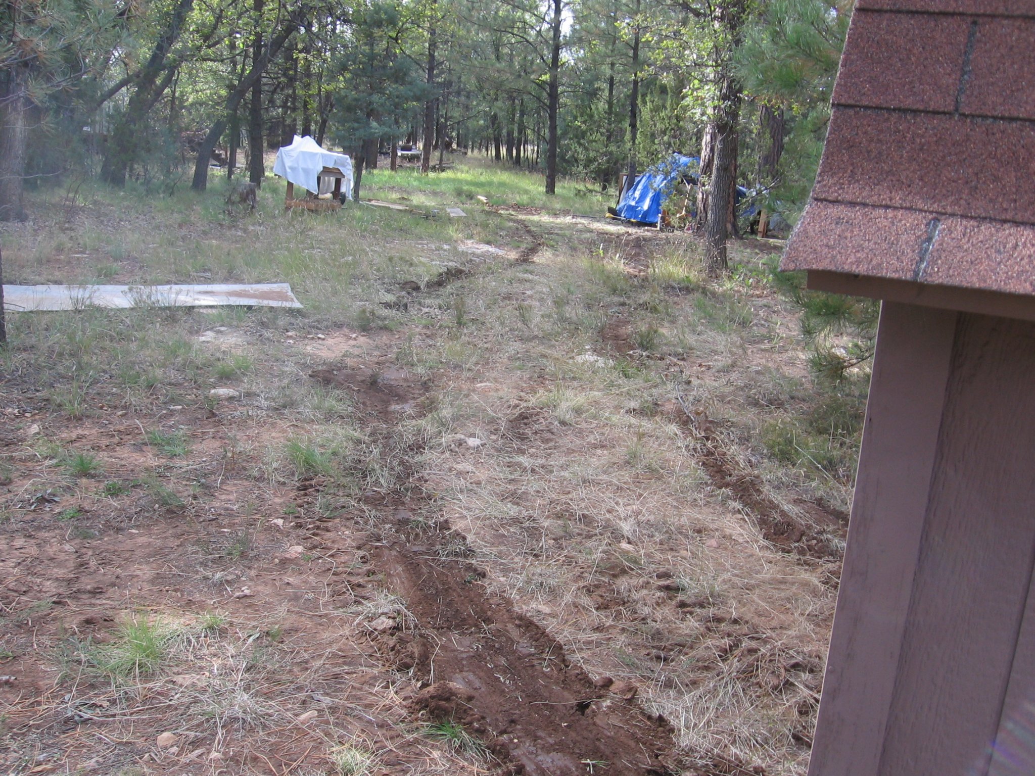

6th is another view of the ruts.
I was too tired to get any more pics. The move was easy, but all the work emptying the building's contents and then reloading it was quite draining.

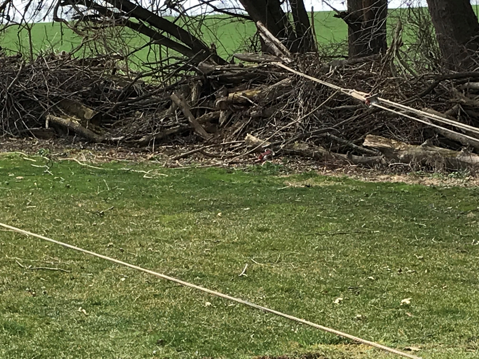

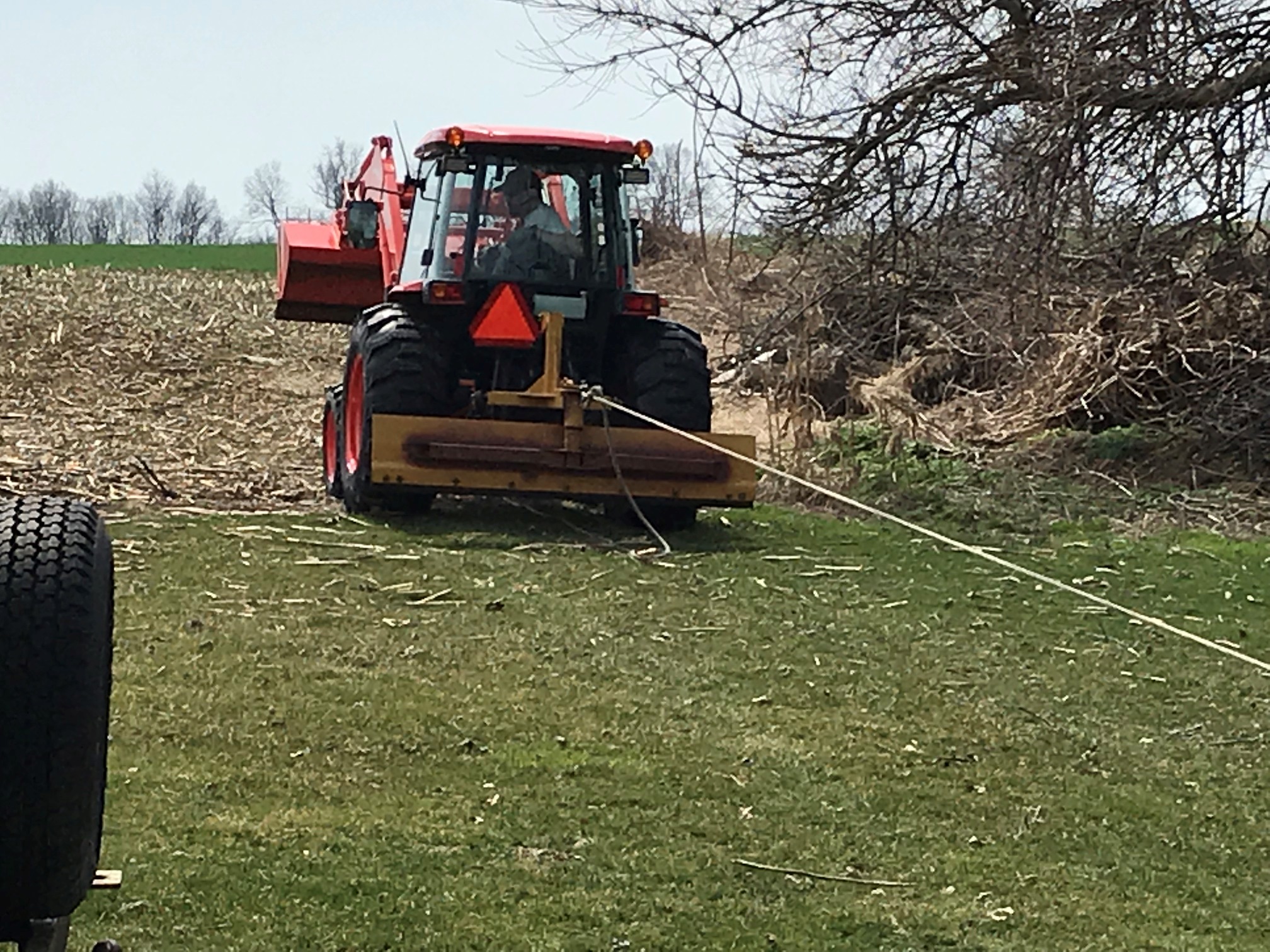

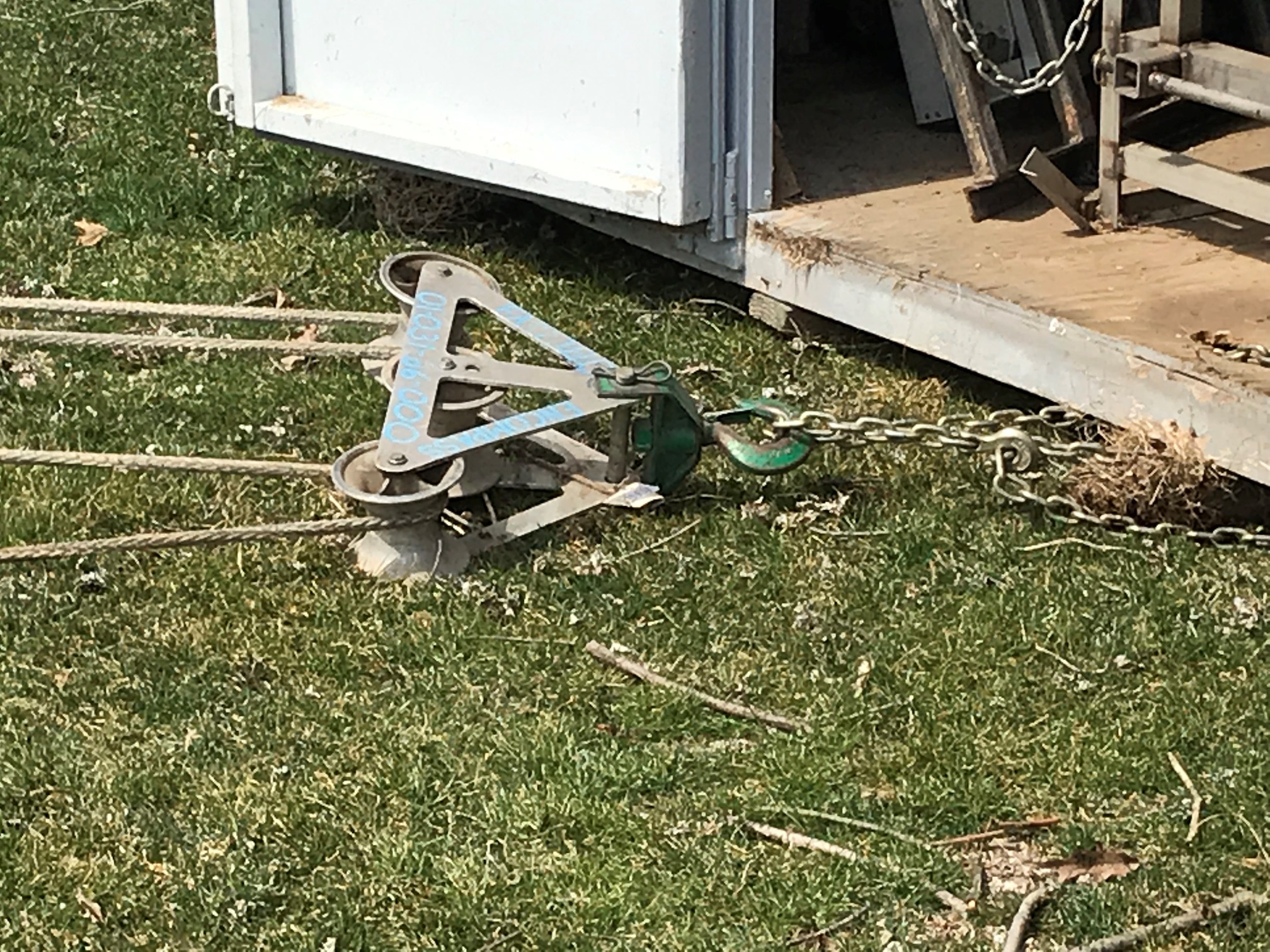

Unloading would make it a WHOLE LOT EASIER. I didn't bother with that step when moving the old shed out of the way to make room for the new one. No place for stuff till I was finished building the new shed, and moving mountains of stuff out and back in wasn't very appealing.
With the L4240, a bunch of pulleys, a big tree and a couple strong ropes, it was still pretty difficult to slide the old shed.

That is quite an impressive pulley setup.(y)
