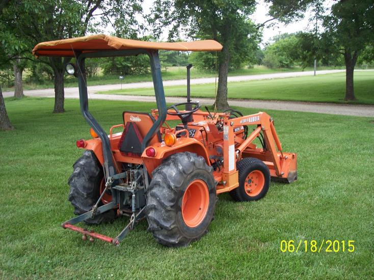

Here's mine. Made about 12 years ago. Never took it off, but would come off in minutes. The string is on the front and back because I had it on a trailer going down the road and it raised up. Put the string on and never removed it. The metal is from a Jeep CJ5 top frame. Had local shop put material on frame.
