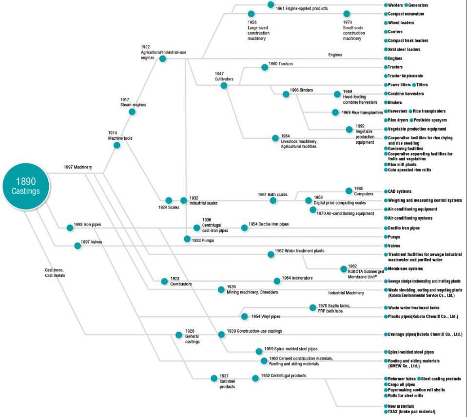

http://www.orangetractortalks.com/forums/showthread.php?t=17570&highlight=History
This is the only history I have seen so far and it is not particularly easy to parse, but maybe you will find what you are looking for here.
The American versions of the L1501s are the L185s, at least those are the most compatible models in terms of manuals.
KUBOTA Virtual Museum 1890-2014
https://www.kubota.com/museum/history/1890_1926.html
https://www.kubota.com/museum/showroom/index.html
https://www.kubota.com/rd/evolution/agriculture/detail/detail.html#

Yup, pretty simple, got it running again in no time. Was not sure if the fuel pump would be activated just by cranking, but indeed it is. Thanks again, Bill. Also, really appreciate the virtual museum links.
