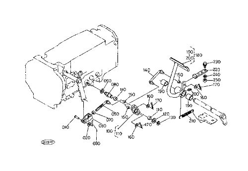

The other way to tell if it's a DT, or a DT-Wet is the clutch linkage.
DT
DT-Wet
