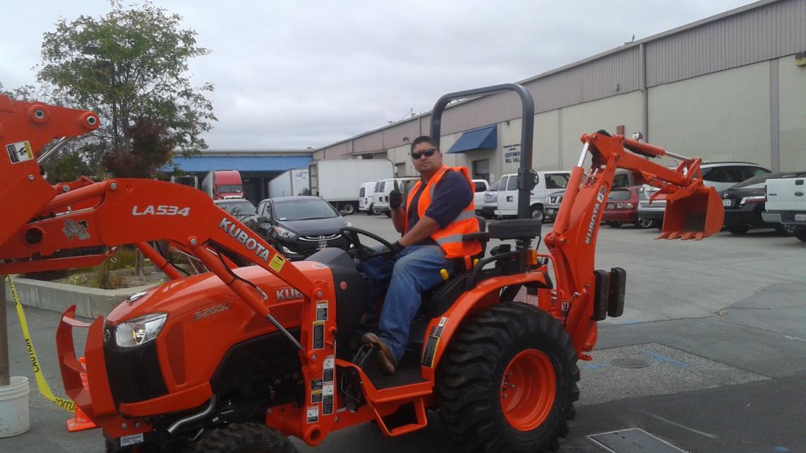

We are doing our 50 hour service. The dealer told me to change the hydraulic fluid and the engine oil as a precaution along with the associated filters. I am under the impression that hydraulic fluid and transmission fluid are the same. Am I correct?
I am reading the instructions and I see a transmission oil filter (HST) (what does HST stand for?) and I also see a Hydraulic oil filter. (the dealer gave me both filters)
I'm not really sure what to make of these two filters. If they are the same fluid, I would think one filter would suffice so now I am worried a I am missing something.
So much for reading the directions.
