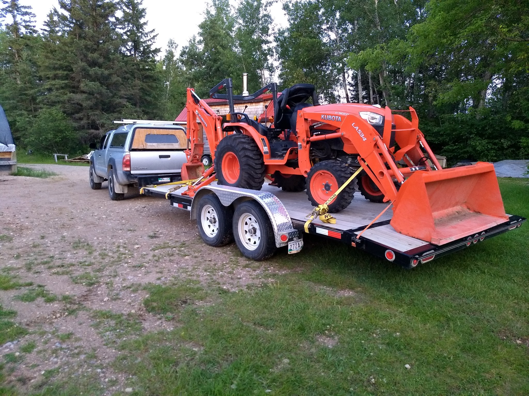

When securing a BX TLB to a trailer should the BH boom and dipper stick be lowered to the deck OR left secured in its normal non-use location, pinned? Does it matter? Any ideas?

Start with my experience of the laws….the troopers haven’t stopped me and told me I’m doing it wrong yet 🤣.
I lower it to the trailer floor and strap it down. It also makes my truck and tractor look bigger🤣🤣🤣
I gathered from here that its “supposed” to be, but laws and enforcement vary by location.
Some one here will know the specifics though.

I set the FEL bucket & BH boom/bucket on the trailer and strap them down. I have had an AZ DPS trooper comment that the tractor was very well secured.

I use 4 corner tie downs with 4 10K ratchet straps with axle wraps on each ( to the frame) then with the backhoe pinned and locked, I’ll run one strap across the back, around the backhoe bucket, to the other side.
Did that for 30 years on equipment at the phone company too, but they had chains and binders.

I believe most states will require the backhoe lowered and strapped. Me, I use a dump trailer. The way my BX fits, the backhoe rests on top of the rear gate, fully up and tight with the pin in. I do not strap it, but haven’t been pulled over yet to find out whether this is wrong or not. I also don’t think they are paying attention to me. They are looking for the dump trucks and deck overs….

Well, I may be in the minority, and I rarely trailer my tractor(s). But when I do I use chains, and binders, and four point tie down to the tractor, and one chain each on the backhoe and loader bucket.
I know this is over kill, and not required probably for a combo rated at 10K or less, but it makes me feel warm and fuzzy doing it.
Others use four nylon straps on the tractor and feel fine doing that. Not my way...and cannot say one is better than the other, unless a mishap happens. Then I know which way is more likely to be better.

I always feel better with chains and binders than straps. I may also throw on a strap or two for good measure, but I start with a chain and binder front and rear

Irrespective of any transport laws I think a lowered bucket and arm properly secured are always a better option than not having it lowered and secured. People talk a lot about number of chains, size of chains, chains v's straps and strap capacity. I'm always looking to avoid a problem and like the thought of my tractor, skid steer or mini ex firmly secured so I don't have to worry about the load I'm towing.
Proper trailer, good securing equipment, a little time and common sense go along way to avoiding problems. The right truck and style of driving also help!

I am not sure this copy/paste will work, but if not you can google load secure me to indiana state…it helps, but there are some grey areas for each situation as best I can tell. I agree with someone who previously mentioned chains…straps can suffer from abrasion…it takes some real talent to snap a chain on a compact tractor.

My Kubota BH owner's manual says lower the bucket to the trailer and secure.

I am a chain & binder guy for the tractor itself, but I use straps to secure the implements.
I asked the AZ DPS trooper I had talked to in the past if he had ever seen an implement come loose during transport. He said his training officer told him of an excavator bucket/boom that wasn't secured, & that it had walked off the right side of the trailer and was dragging on the ground. Beside the obvious possibility of hitting something, it was creating sparks that caused several brush fires.

not sure how that could happen on a pinned BH, i alway put a little pressure on mine after I drop the pins in. Even though I doubt they would fall out.

Older stuff, like my B670 BH, don't have any way to pin the boom to keep it from dropping or swinging side to side. I assume he was referring to an incident that happened a while ago with an older machine.

I dont know for sure but I would think the newer machines that have pins to secure the BH would not have to be set on the deck and secured.

in ontario (like jay said) we have to secure the attachments. The law for it came out after the invention of the BH locks. I don’t put my BH on the deck. The only time I toss a strap on it is if im going further than the farm. (It’s a 10 min drive) I only do it to avoid a ticket And court time. IMO if you don’t have locks, it should be secured, if you have locks you’re now disabling the locks so you can strap or chain it; so you shouldn’t require it I trust the pins to hold them in place .
