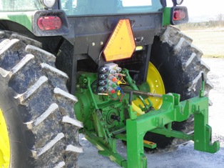

Here is a way to add more hydraulics if you have one set now. Go to Fasse Valves. I had six on some John Deere we had. They work great. It just plug in your one out let and make 2,4, 6, 8 or what ever you want. Photo below show it.
http://www.fasse.com/
