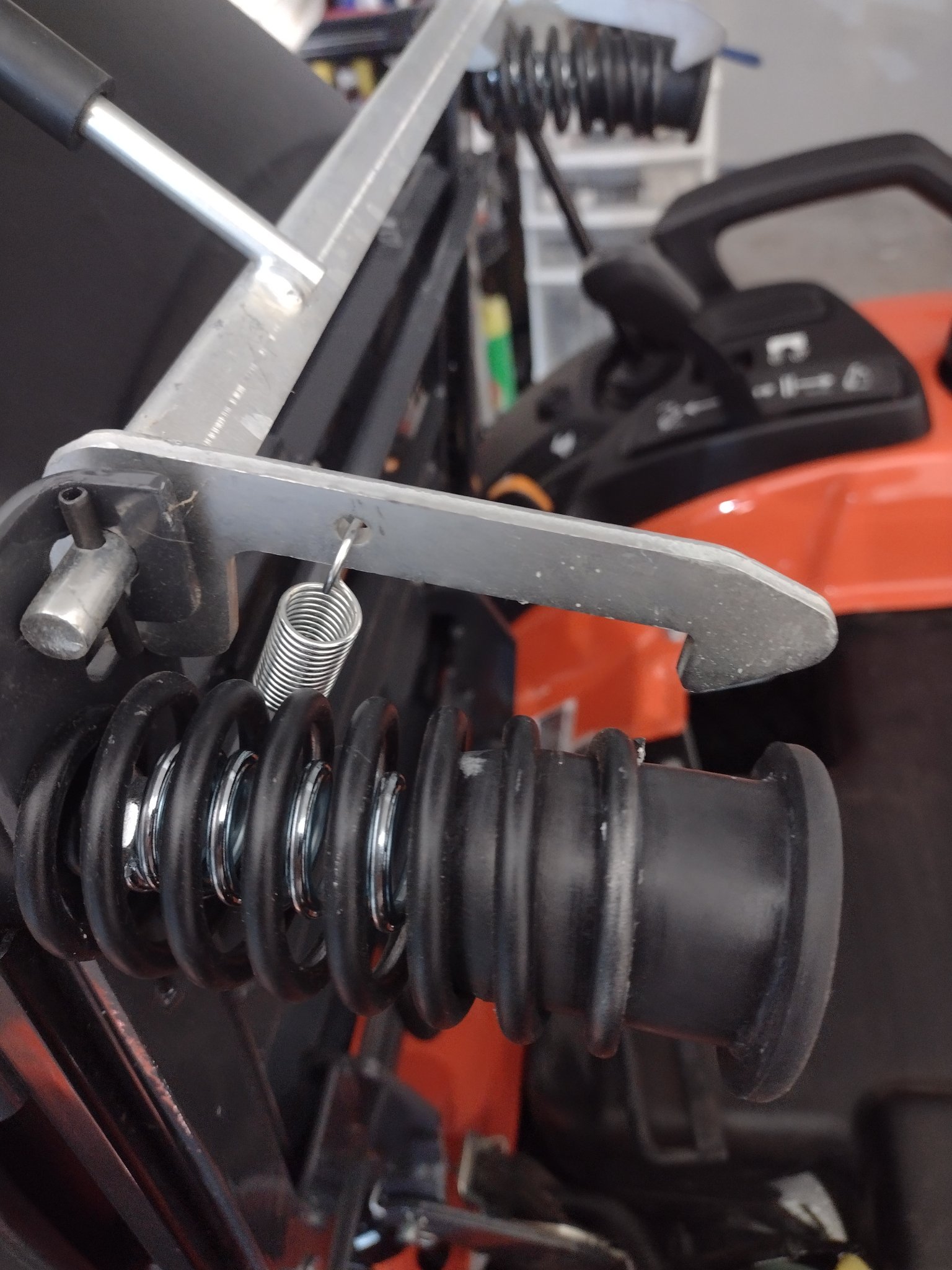

Well here's what I came up with. I too have a bad back.I had three disks removed from my lower spine, 360° fusion, with a titanium cage and two rods and screws. It took two years for my back to completely heal.. I put the helper springs inside the stock springs you can see in the pictures. They fit inside the rubber stopper grommet. They have quite a bit of firmness to them.,and I can no longer bottom out the seat. I weigh 250 and change, no lightweight for sure. I also am going to use a motorcycle gel pad in shearling on top of the seat for more comfort.. AMS specialties makes a nice one..I have two, I use them on long trips on the bike and I the car. The shearling helps to keeps you butt dry in hot weather. The gel absorbers bumps. Helps.

Looks good to me - KISS (no offense intended). A little stiffer suspension but no bottoming out. (y) (y)
