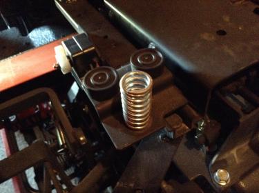

I upgraded my mx5200 seat springs with these from tractor supply. Does not bottom out now and rides much better. Thought this might help someone.

It was a compression spring pack I picked up at the spring display board. I threw the package away months ago. When I look online it appears the be sku number 353420299.
I had to bend the last coil on the springs together a little with vise grips to get the mounting bolt to hold the spring onto the tractor. No major effort applied but a slight modification that will have to be made.
