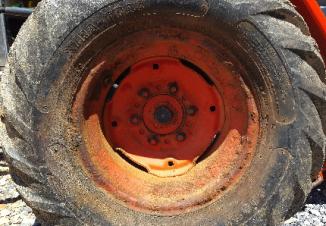

my B1750 HST 4wd (used) came with calcium filled rear tires. The rims have started corroding, so I was going to order new rims. However, it appears that the kubota part (66416-17720) is going to set me back around $600+.
so, I'm trying to find an aftermarket part that will work.
I can't seem to find the 'official' specs, but from what I can tell it is the following:
size: 15 x 10 (rim has an imprint that says "15x10 LBH", and I can't figure out what the LBH stands for)
hole size: 4-5/8" (I've seen some references to 4.633" on different sites, so that may be it)
bolt holes: 6x6 (or 6on6, but the original rims have 12 holes with 6 lugs, spaced at 6" distance on center)
inset: i'm unsure on this as the tires are still on and I can't get a good measurement, but it *appears* to be around a -1.75" inset at the part where the bolts go through the holes.
the tires that are on it are 31x15.5-15 which apparently are not stock. They have the big traction bars like a larger tractor typically would have instead of the turf tires.
Anyway, the ultimate question I have is, does anyone know of an alternative part number or other aftermarket rim that will work? Even if I have to buy 2 new ones so they are surely the same rim, that's fine as long as I don't have to fork out 600+ for 1 rim. I don't care what color it is or anything along those lines either.

Thanks, I found those as well, but I'm fairly certain that is for a front tire or a skinny back tire
Listing shows:
5.5" x 16" Front Wheel Rim
It also lists a positive offset, whereas (if I understand it correctly), I need a negative offset [ie. center disc is closer to the tractor side of the rim, which helps keep the tire out from the tractor]. I suppose in theory I could flip it around and drill a new hole for the valve stem, then seal up the original.
however, I still need a 15x10, not a 16x5.5

I was only looking for rims, which I did find at a local place (if you need the part numbers, I'd have to see if I can find them... I don't recall if they had that listed on there). They are the generic cream color, but oh well. I didn't get a chance to swap them out yet, but I found a place that sells the "caliber m1000" solution that I'm going to use for my ballast. Now I just need to get a 55 gallon drum so I can get that stuff and then hope and pray there's nothing wrong inside my tires currently.
