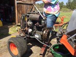

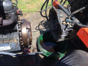

Got it apart today, weather yesterday prevented anything being done.
A lot of crap to remove this get to this point.
Inside was dirty, but slightly wet, oily. Cleaned up easy enough with brake clean.
Awful tiny package all said.
Is most of the way back together now, will have it running tomorrow.
Reassemble dash, fill trans install body work. Take it for a cruise.
