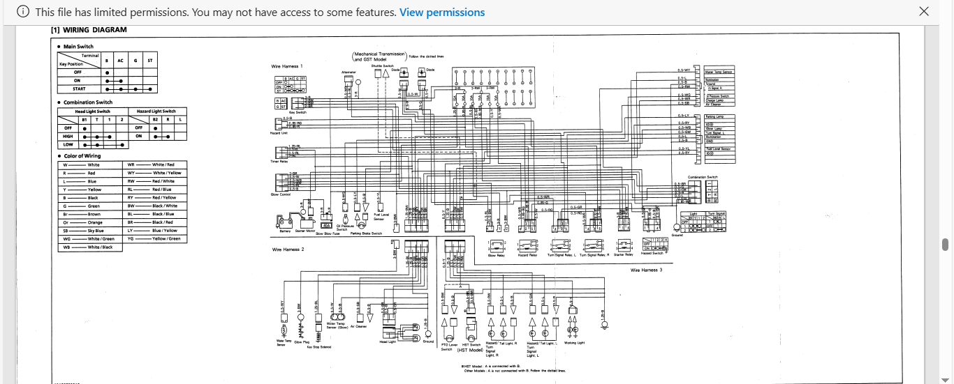

when the tractor won't crank, two red lights on the dash come on, but the glow plug light does not.
Does this happen with the key switch in the ON position or the START position?

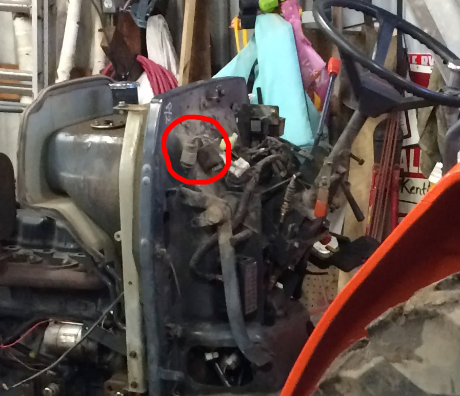

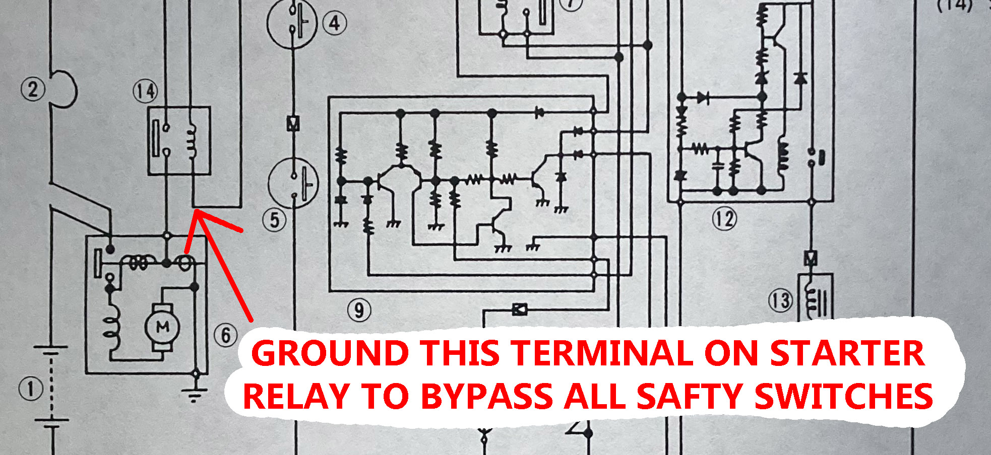

Well, this stings, but I want to apologize to everyone (especially the OP) as I WAS DEAD NUTS WRONG.
I just crawled underneath my L3010 and discovered there is indeed a treadle position safety switch. It’s located not far from the hydraulic oil filter. See attached image. I can clearly see that this will affect starting of the machine. Any devotion from a true neutral position appears to open the switch.
To the OP, I suggest you disconnect it and jumper it out to see if that fixes your intermittent no-crank condition. If that doesn’t do the trick, you can do what I did and locate the starter relay and ground out the terminal that connects the safety switches. Of course this also means it’s possible to start the machine with the PTO & HST transmission engaged.
Once again, I apologize to everyone for the miss information.
