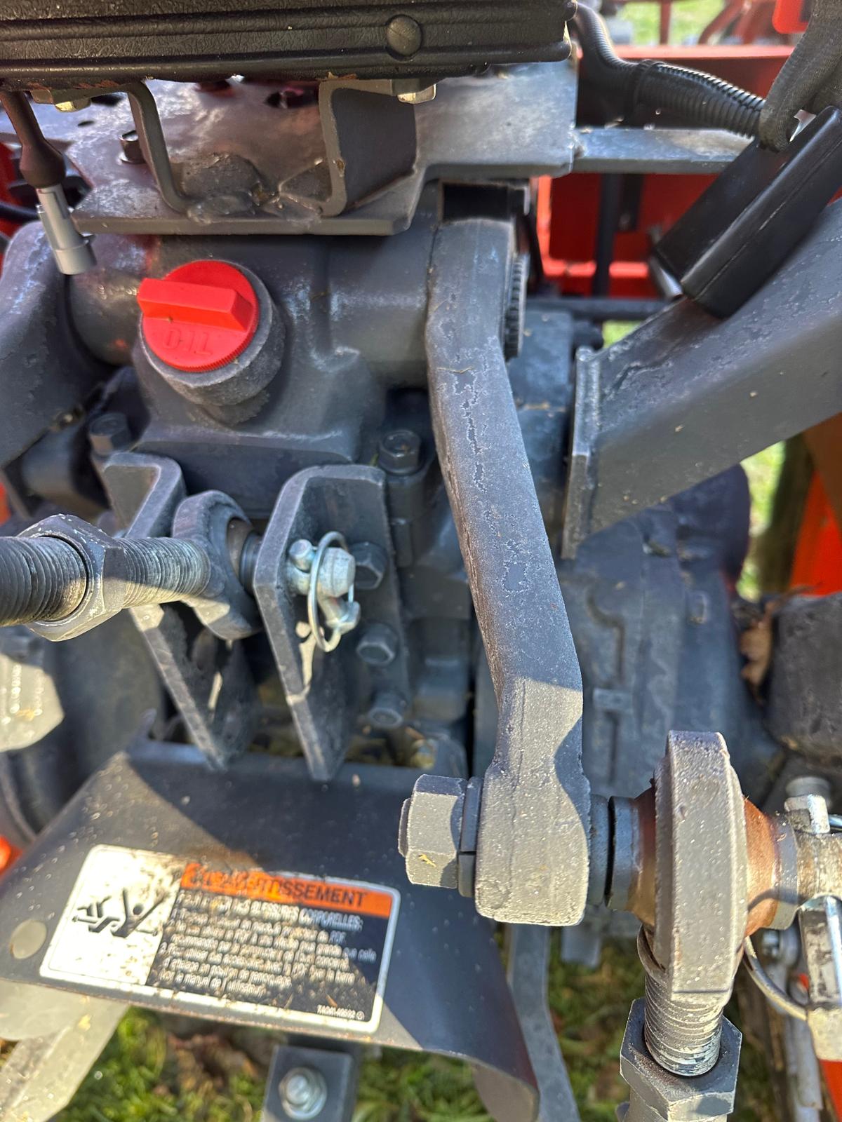

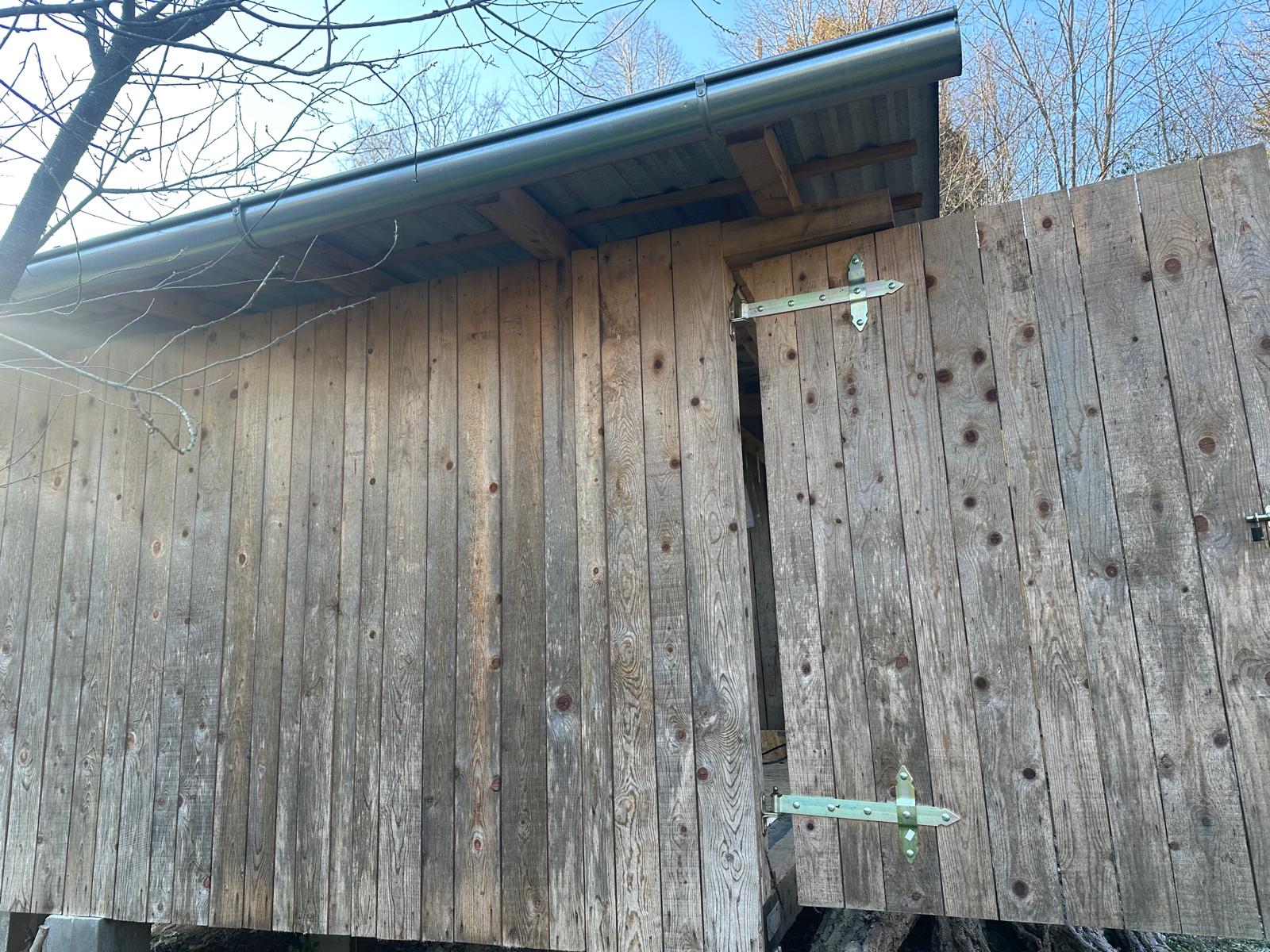

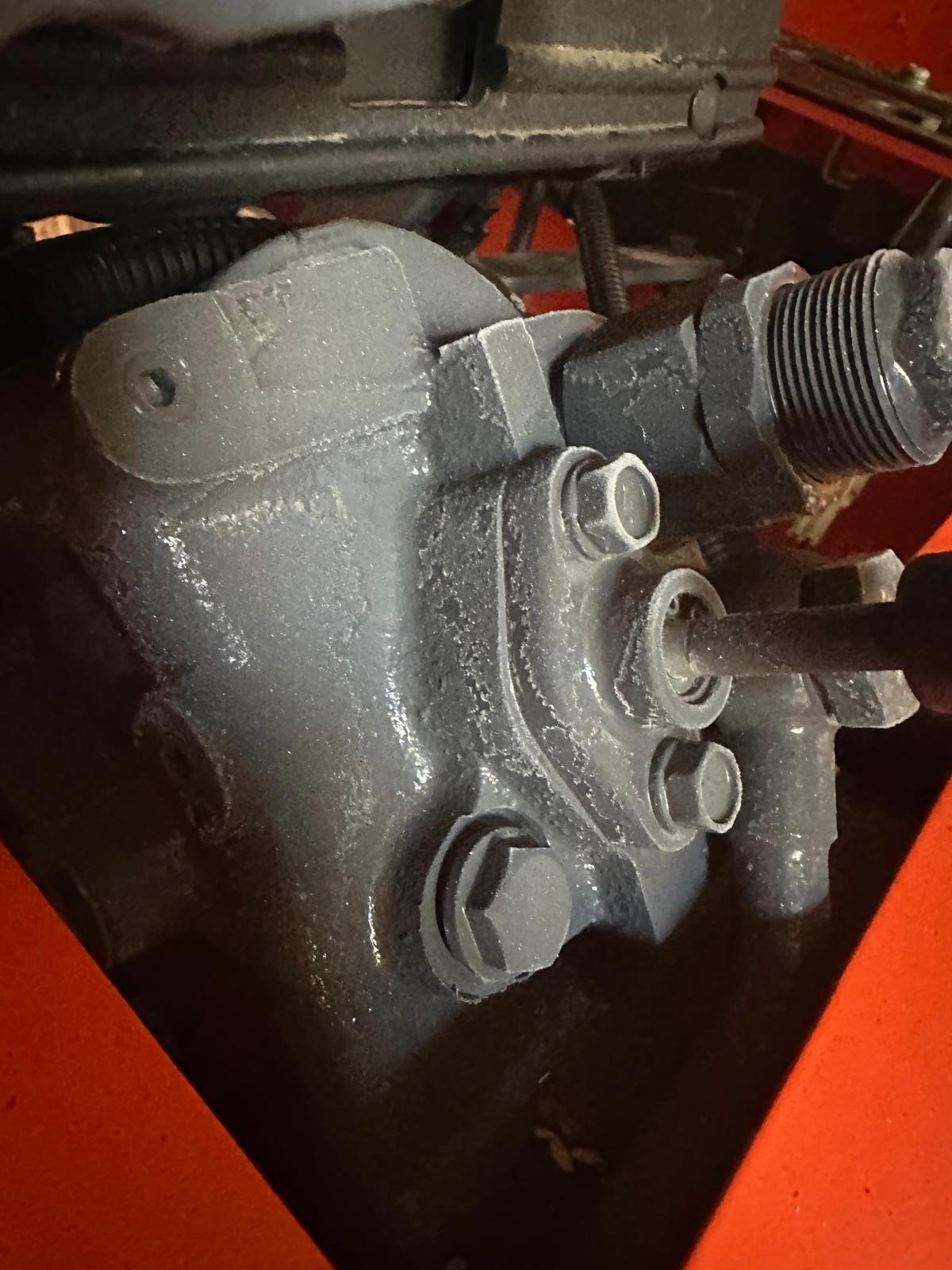

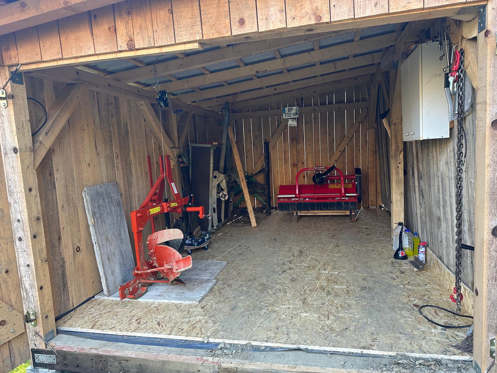

Hi again! Since my last post, I’ve acquired a new tractor and checked on it today in the barn. I’m attaching some images to show its current condition. We’ve had nighttime temperatures drop below freezing for the past couple of nights, and you can see frost covering the entire tractor. During the day, temperatures rise above freezing, causing condensation to form on the metal surfaces, which then refreezes overnight. As a result, the tractor is constantly wet. And in long term I am sure it will cause unwanted rust.
I’ve placed a plastic sheet under the floor, so I know the moisture isn’t coming from the ground—it must be from the air. The barn is wooden, as shown in the photos. Does anyone have suggestions on preventing this issue? Would installing Styrofoam on the inside walls help reduce or this recurring condensation problem by reducing temperature oscilation?

Unless you can completely control temp and humidity your not going to stop it from happening.
I think your being overly worried about something that's not going to hurt the tractor one bit.
I have several 30 and 40 year old tractors that live outside in the rain snow, frost, temp changes and they really don't have any real rust issues.
But I get it, you want it to stay nice.
Making the walls vapor resistant will help a little till Humidity goes up, then you'll wish you didn't do it as it will work the opposite.
Don't worry about it now as there is not a lot you can do till it gets warm again.
But when it does, wash the tractor completely, they apply spray wax.
Or you can apply a rust preventer.

Yeah I think I cant fight condensation while in wooden barn. I do think that if I had brick or concrete garage that this wouldn`t be happening.
As you guessed, I am more concerned about aesthetic part than being worried about actual harm done to the tractor. Especially since I could really see the difference on before/after images of my previous B series tractor, after only 3 years sitting in the same barn. However that was older tractor to begin with so the paint was more chipped and therefore more prone to rusting.
Thanks for the tip. I will follow the advice in late spring.
