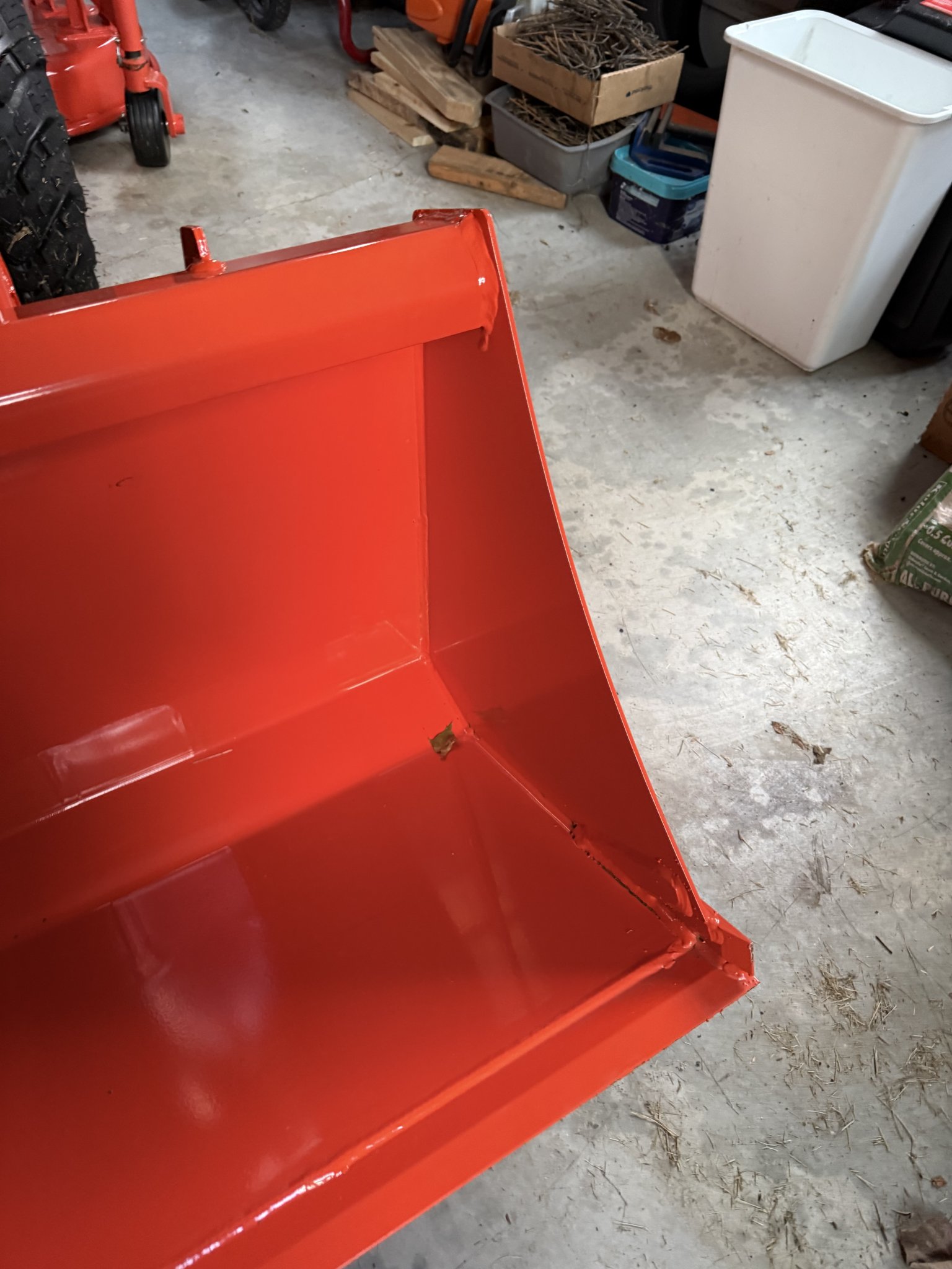

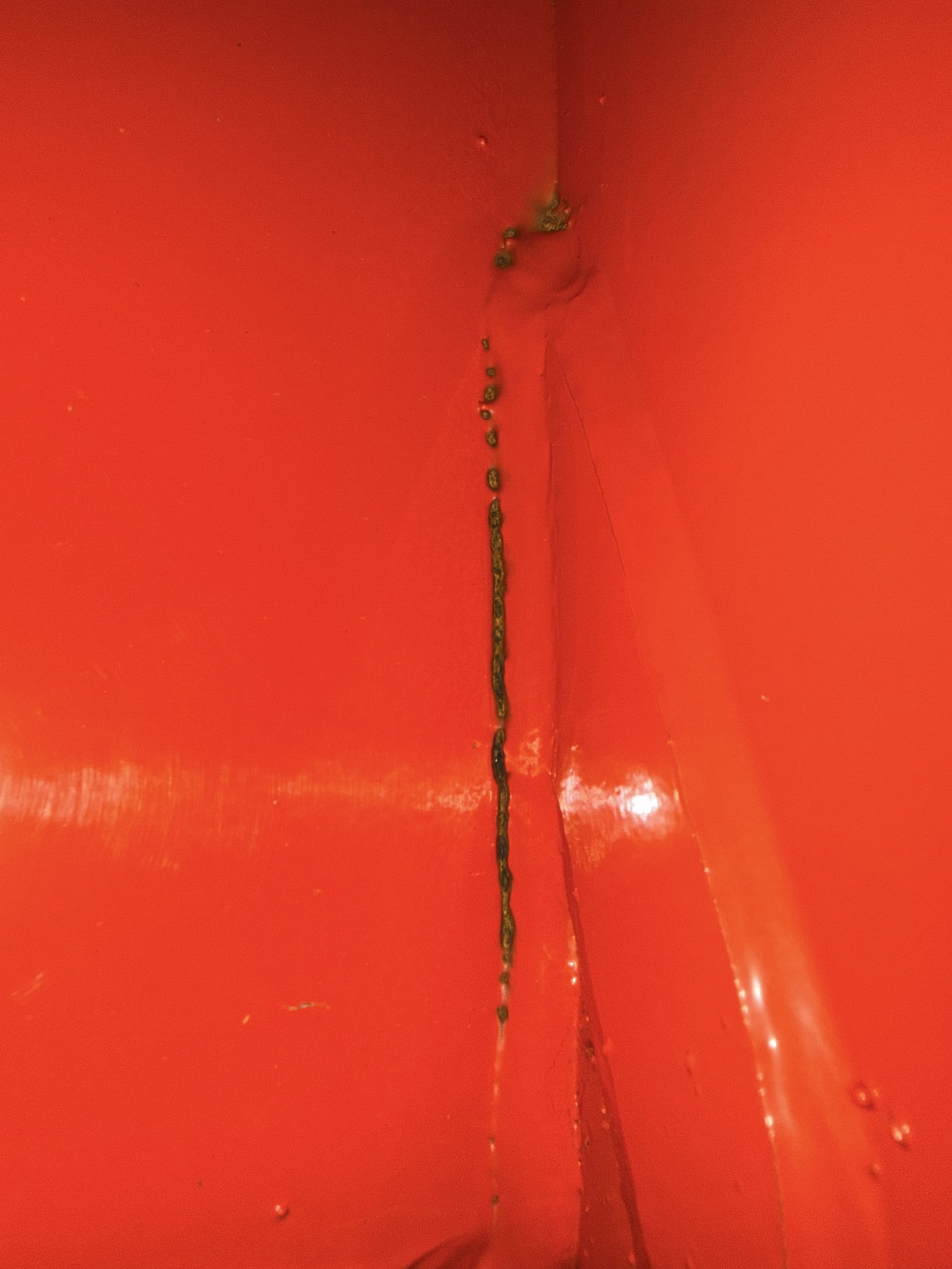

Background: got a new LX4020 cab. Noticed rust on weld in bucket a couple days after delivery.
What should I do about this? Email my salesman to document it in case it fails down the road?
Other thoughts?

based on the pictures, have dealer swap you another bucket. I zoooomed up the 2nd picture and it looks like the weld is in 2 sections, though it should have been ONE continuous pass. Amazing the paint didn't 'flow' around and hide it better. The rust indicates the weld didn't get hot enough to penetrate both side and bottom sections.it is now a weak spot,over tie more rust, less strength and pieces will come apart.
At least that's what I see.....

Use the bucket; it'll scrape the rust out. Then hose the bucket clean and put WD40 in a SureShot and spray the bucket. (WD = Water Displacement in the right sprayer.)
It's new, I get it, and that looks like the weld was a little cold--that's the bigger issue, because the weld could fail in a few years if the weld doesn't have good penetration and you use the bucket hard. Don't worry about the paint, worry about the construction. Water/moisture will always get trapped in that area and it's prone to rust, you'll want to stay on it with WD40 any time you store it. At least I would, but I'm a fabricator not a tractor expert.
Personally I'd take pictures and send them to the dealer, ask Kubota for warranty paint, and take the bucket to the shop and have my guys grind the weld out and re-weld the area, then prep and spray it. But that's me, and I'm not even sure I know what I'm doing... :ROFLMAO:

Appears to be a poor weld having a cavity that holds water, I would want a new one.

It’s hard for me to say from the picture, but that rust looks like corrosion coming from not a scratched bucketed, but from the filler material from the weld (and a cold one at that). At a glance IMO that is a problem that will not go away with out a proper repair or replace. You can paint that all you want and it will continue. JMHO.
If it was a scratch and some light surface scale I would say use the bucket and shine it up. (I don’t think that is what it is from the picture).
Honestly I would wonder why the dealer even delivered the tractor like that.
Good luck. I hope they stand behind what they sell.

Looks like some oil contamination was sitting along the leg of the weld resulting in a defect in the paint. Hard to tell if it's a bad weld or not but doesn't look like it to me from where I sit. If it were my bucket, I'd get the needle gun on that area, clean with acetone and paint with some Kubota orange paint. It's a bucket and it's going to get a lot more messed up than that if you actually use it.

Everyone's a welding expert on this forum. 🙄 The photos aren't sufficient to determine whether or not the weld is defective, so any claims of weld failure are about as meaningful as saying that the welder was named William.
What is meaningful is the way the paint edges around the void are rounded or rolled. This suggests a repulsive force on the paint along the weld edge, either due to a net charge along the edge of the weld, a magnetic field, welding/grinding dust, oil or some other component that had a net charge opposite to that of the paint.

Update: dealer is going to exchange the bucket for a new one without apparent rust
