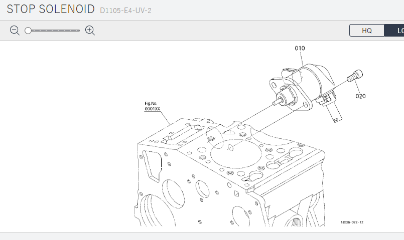

Does pulling the stop solenoid have a gasket or anything I should be careful with? I did read on some other posts that there is a "fine" adjustment.
Nope no gasket and no adjustment on the stop solenoid.
