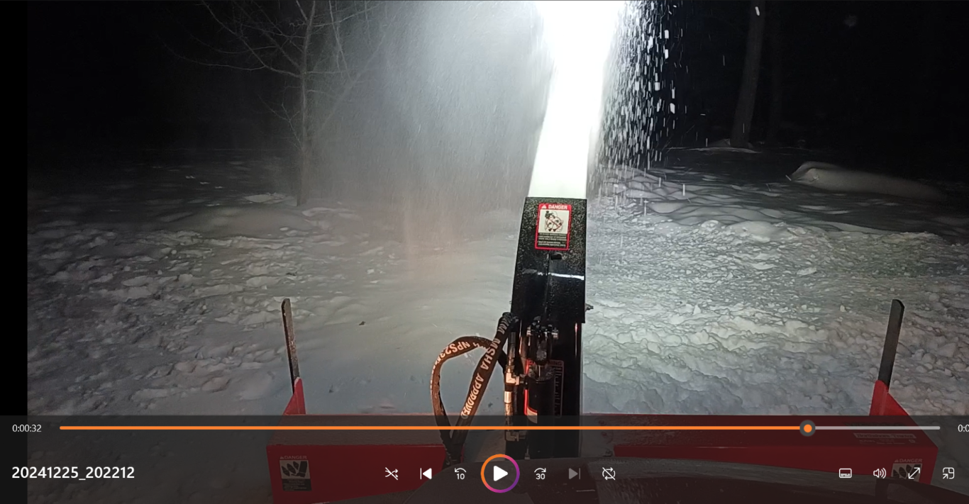

Can't seem to post videos, but here is a screen shot of what I was just doing. 20 inch deep and packed because it was blown there with my tractor when it was wet. I was worried about it being underpowered, but seems to do just fine.
