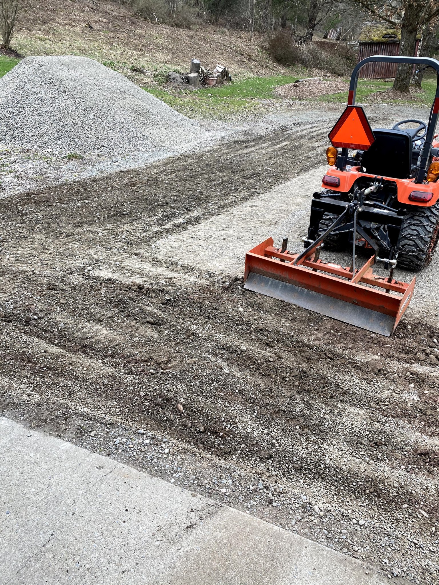

I regularly get loads of stone for the driveway. About 20 tons every couple years. With some other stone delivered for foundation purposes, I've probably handled 120(?) tons over the 12 years I've had the Kubota.
30% of that is distributed with the loader bucket. Have to push into the pile to get a bucket full. Need nearly 100% RPM to help the tractor do that. Rest is pulled around with a box blade.
