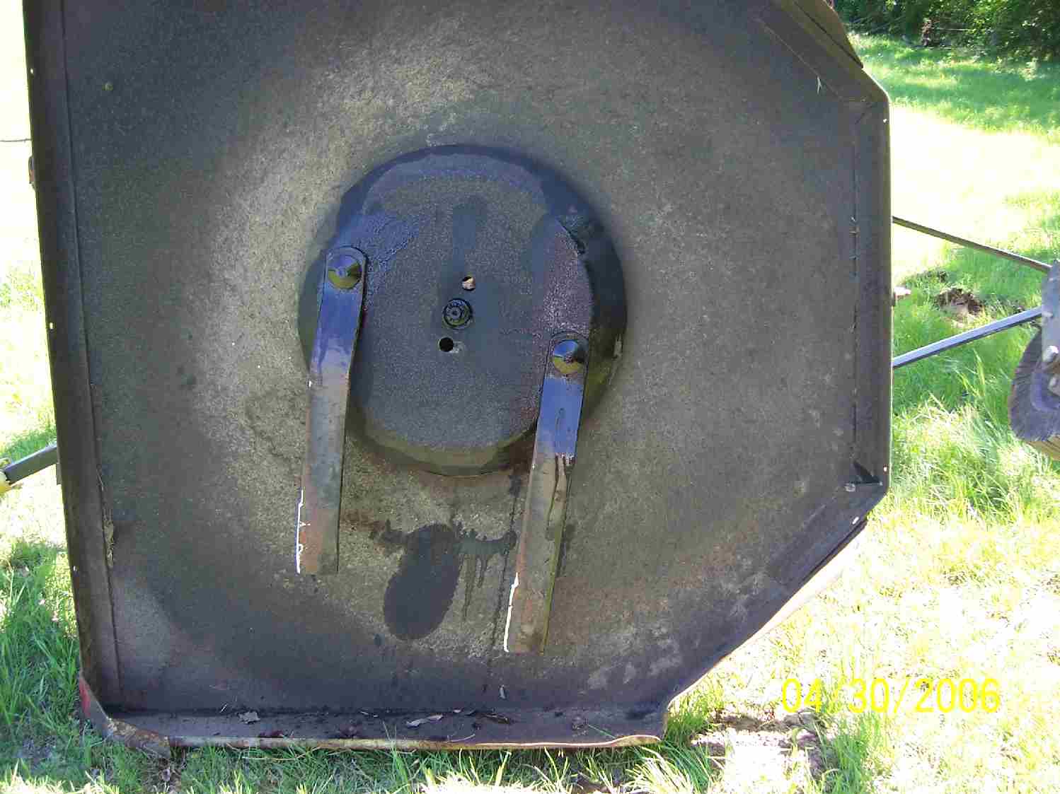

Guys, school me here or point me in direction of a good animation of how a rotary cutter works.
The two blades spin 360 degrees overlapping each other?
Perhaps the pic attached will help explain what i mean. If they just spin with the unit they are attached to I dont understand how anything in the middle would get cut.

AS the two spin.....they are forced out away from the stump jumper......the leading edge will cut (edge closest to you) and the rest will just cut stuff as it blows around.....
the front of your mower should be about 1/4" LOWER than the rear ....so the front is cutting and the rear is not cutting at the same plane.
THINK about how a weeder eater works:);)

Thanks for the reply. However, need more info:
I do understand what you are saying and do know about the stance. But, I still dont get how something in the center gets cut. Say you are driving around your field - the brush that enters in the middle of the cutter...is it just bent over? So hard to explain what i mean.
For instance, in the picture above - where the two blades attach - that area in between i dont see how a blade would ever cut material in that area

Basically the same as any mower. As Hokie said, the blade is cutting in front of the stump jumper just as it would a spindle on a mower or a string on a weedeater.

blessed jesus - i just seen the light. Feel like a dummy now. I must have thought it ran at 5-10RPM!
Thanks all for the schooling.

Also another reason for the pivots is so the blades can bounce off something too big to cut. Lets it keep spinning instead of jamming like a push mower would.
Ever hit a stump with a push mower? Imagine that X 50.
