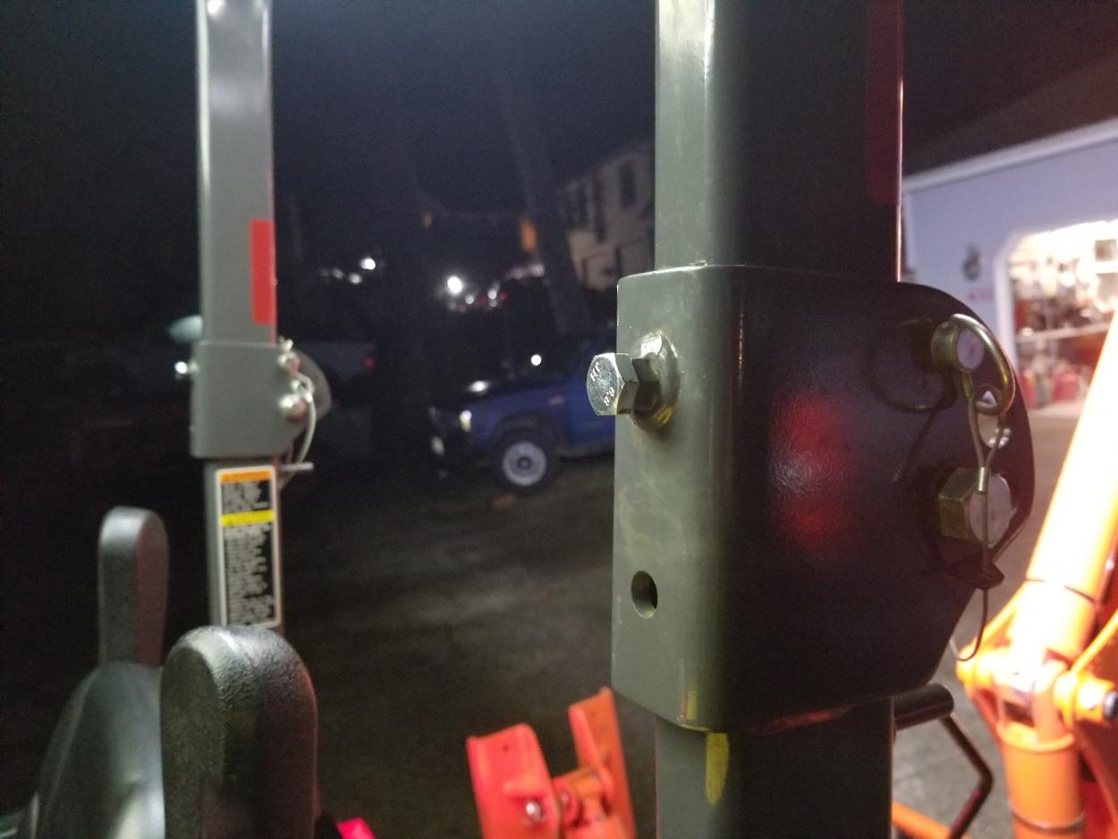

This is what works in my '18 B2650
Nice. I was thinking about getting a bit longer of a bolt with a nut and a lock washer.
Tighten the bolt snug then then tighten the nut and lock washer down towards the welded nut so it wont back out.
I might try to find yellow zinc hardware so it somewhat matches the pins, but I can be a bit picky at times too.
