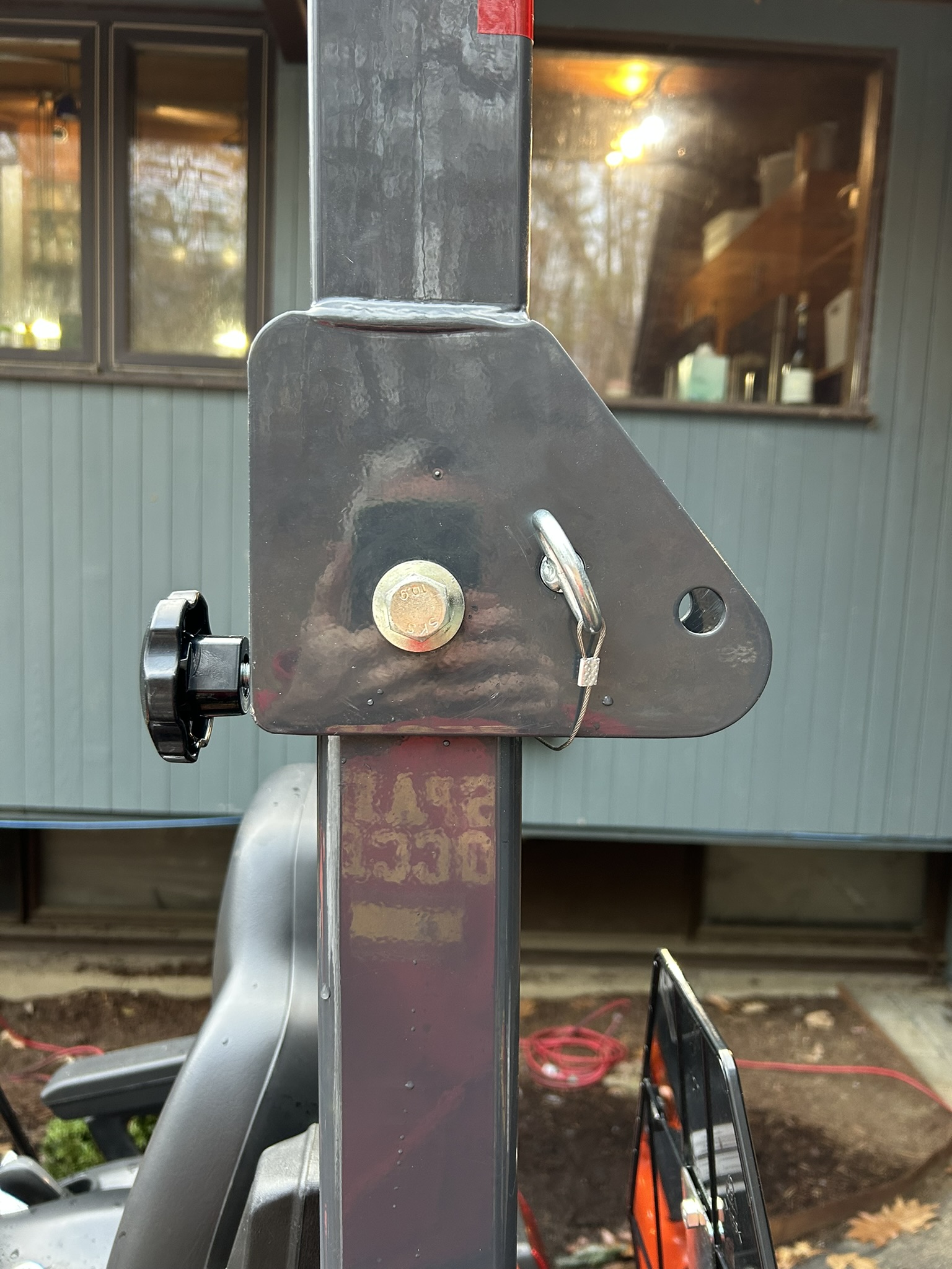

Good Morning!
I have a brand new BX2380 tractor. The first tractor I have owned. The one issue I have run into is the ROPS will not fold. I have pulled the pins and loosed the black circular screws. It moves just a little bit, but it won't go down. Does anyone have experience with this? Most of the videos I have seen make this look straightforward. I called the dealer, and they suggested I might need to loosen the pivot, but I wanted to see if anyone else had this problem before I invested the time.
Thanks!
imnukensc
BX2380
Sep 10, 2015
731
660
Midlands of SC
The dealer tech probably installed the bolts and pins "backwards." That is, the bolts are where the pins need to be and vice versa. My dealer did that. After installing them correctly, my ROPS folds just fine. Pretty sure there is at least 1 or 2 youtube videos on it,
12,984
5,708
Yes, you'll need to loosen the nuts and bolts a bit.

Mine was a bit sticky but after a few yanks real hard, finally moved.
33,516
8,786

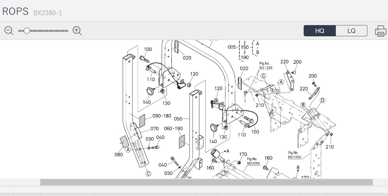

Make sure the bolt is in the rear and pin in the front.
Then if it still won't move holding 120 loosen 100 slightly.
