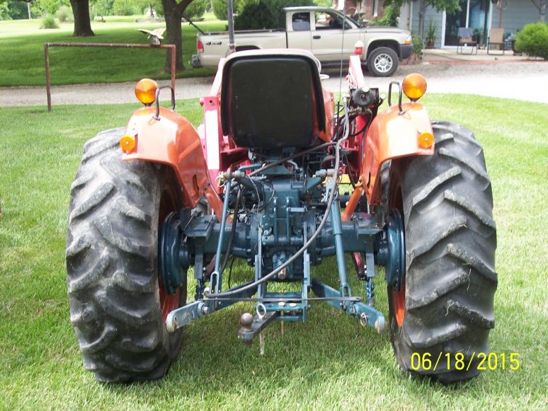

On my L305 the ROPS sets on top of the axle on both sides just inside the fender and has a flat plate top and bottom with a couple of large bolts going through.
Here's a picture of the back end before I put the ROPS back on. The ROPS you received looks like it's for a smaller tractor.
The rops should have the model numbers it can go on on the back plate. I tried zooming in on the ops but can’t make it out. Seems like it’s common to have an issue with these rops. I ended up slotting my holes in the back plate to make it work for my l1500
