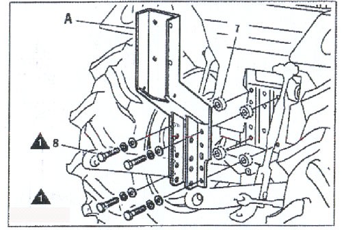

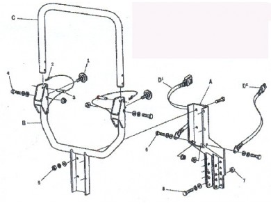

Thanks for the schematics, Tomcat. I may go that route. I was drawing up an idea for bolting directly to the rear transaxle (where the fenders bolt on) to lower the center of gravity of the ROPs. Thoughts?
28,992
5,326
On your model the axles is exactly where it should mount. ;)
Oh and it's not a Transaxle as there is a transmission in front of the axle. :p;):D

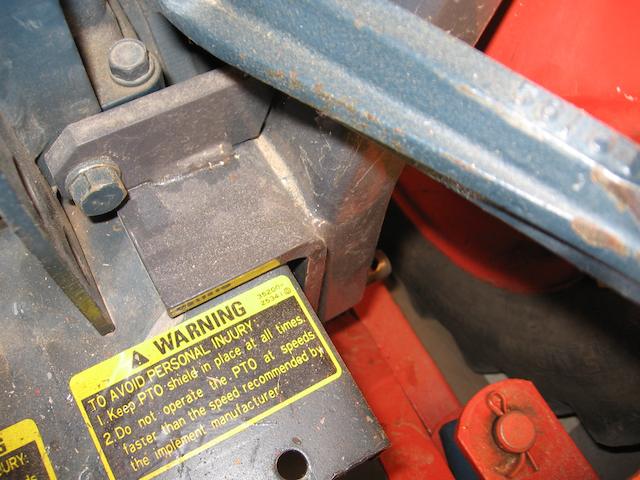

Not to steal your thread Homesteader but, Wolfman, I was looking at an L2000 last week that had a ROPS mounted similar to my illustration and am curious about mounting the ROPS. I didn't see how to attach at the axle level. With your expertise at illustrations could you show an example? I'm wanting to fab something mostly for a mounting point for a roof.
28,992
5,326
On your model you want the same kind of mount as a B7100 that bolts to the back of the tractor.
Here is one post with some good pic's
http://www.orangetractortalks.com/forums/showpost.php?p=69240&postcount=16
