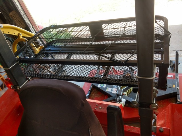

OK, finally got it done. Since my ROPs recline about 10-degrees I fabricated spacers out of 1 sq tubing and tack-welded onto the lower basket frame, adjusting for level using washers.
Horrible Fright sells a motorcycle “net” to secure a helmet on a bike which I used for a securing-net. (It claims to measure 12” X 15” but it stretches and fits just perfectly this basket measuring 36” wide.)

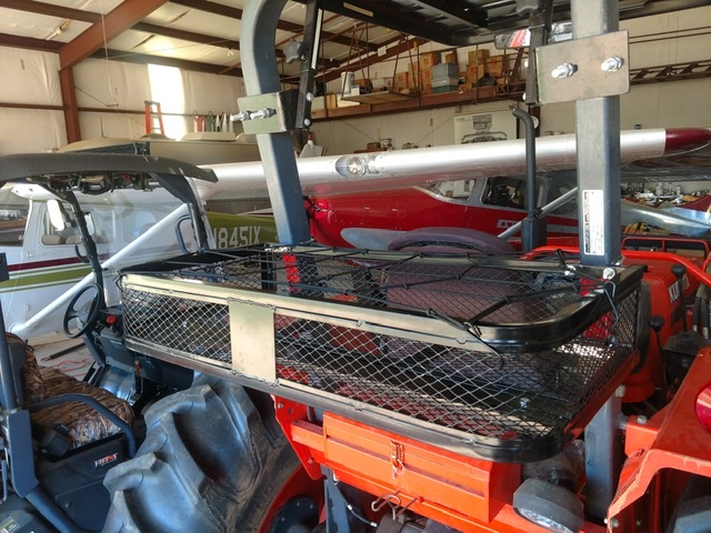

When I looked for a basket I saw that people were using 36” baskets, I measured my 2011 L3200 and found that 36” was just a fraction small, I found a 37.5” basket and this fit centered on both Rops posts, the basket had 2 plastic plugs that fit against the rops without scratching and marking it up. My 2018 L3901 has exactly the same rops width, I’ve had to back order another basket, delivery due at end of June. I did have to remove a very little bit of mesh with a small grinder so the u bolts sat flush correctly, this is a great modification good luck if you are going to do similar. I’m getting my tape out to measure my MX5800 rops next.

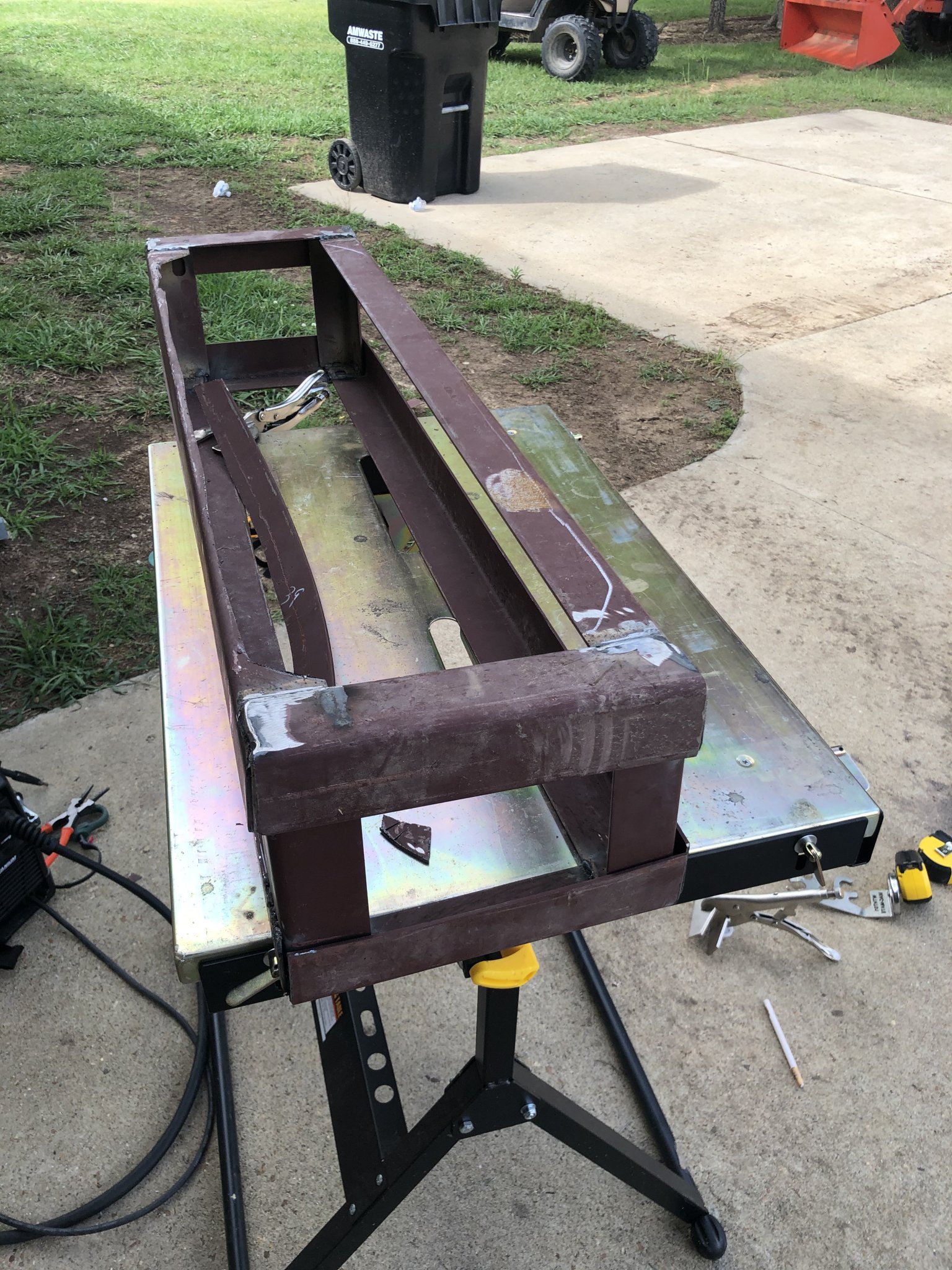

This is such a good idea i started fabbing one myself. Just need to get some expanded metal and paint now. I'LL post when done.

Alright, like Rndrob. I just picked up my expanded steel so I'm going to try and weld up a basket this weekend. Ill follow up with some photos hopefully Monday
