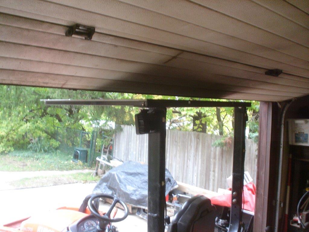

Had same problem with my BX23S, so I made my own 'sunshade top' that clear garage door by 3/4 of an inch. Also removed seatbelt. That was4+ years ago, about 900+ hours of use. Should my widow want to sell the tractor, the original top ROP section is in the garage next to the 3PH I've yet to install.
While there are those that say 'never alter the ROPS', I've owned and used 20-25 tractors,none with ROPS and over the past 3 decades, never once got close to rolling one.
Only you actually know where and how you operate your tractor, so it's YOUR decision.

finally found one picture of what I did. vertical sections are 1.5x3x3/16, same as OEM,plates are 1/4".

Very nice solution Jay.
You kinda have the best of both worlds, by solving the "trade in" argument.
I would also like to point out a simple ROPS is not some sophisticated "20 point chromoly roll cage" (which I will point out that many, many people make themselves every year for their race cars, dune buggys, sand rails...etc......)
It's a U shaped piece of steel.
Just sayin
