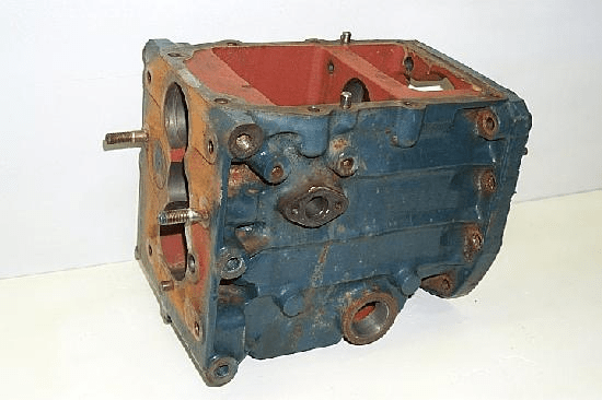

As a follow up I did some looking and came up with this. Picture below is this correct
Sorry I sort of lied... :oops:
On a lot of other models they call it the transmission
On you model the picture you put up is called the transmission and on other models its called the mid case.
But on your model they call the part you need the diff gear case...

Wow! Replacing that differential gear case looks like the labor cost would be more than the value of the tractor...
The thought of paying someone to do that work leaves my pocketbook breathless.
Is the job actually simpler than it seems looking at the parts diagram?
28,929
5,288
I've replaced several, it only takes me about 8 hours to do it all.
