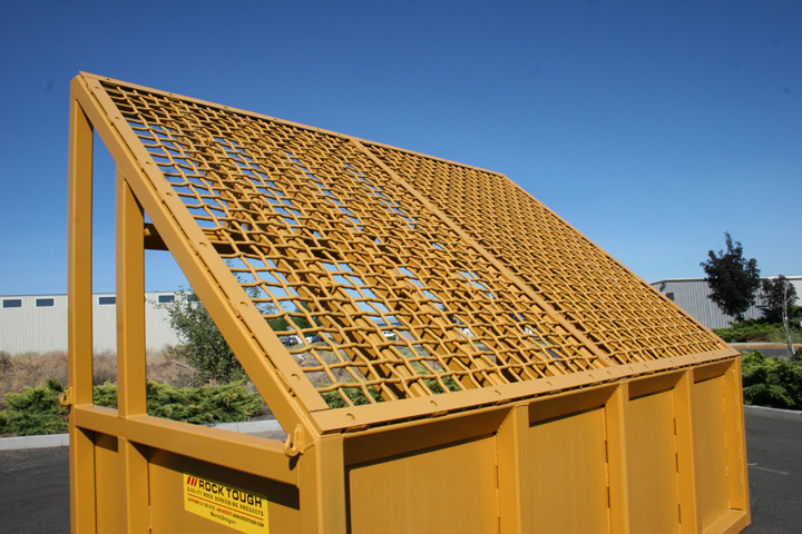

Here is woven wire screen, it will handle the abuse.
If you have a lot to do rent or build one of these!

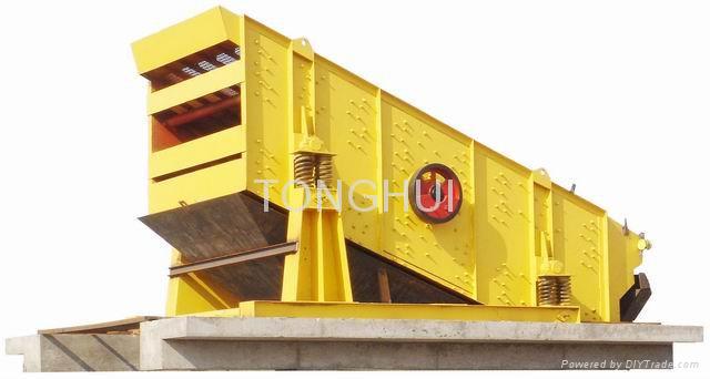

Great info ! Thanks guys!! I guess I never thought about attaching something to the rock bucket itself. I do like the looks of the one Wolfman shows the picture of. I take a grizzly is the motorized version of it ?
34,350
9,584
No technically the this pic is a grizzly, (like the third pic in the other post) they have bars for the rocks and are static.
This second pic is a static rock screen.
Motorized rock sorters are typically shaker screens or vibrating screens but some have a grizzly that feeds them rock.
